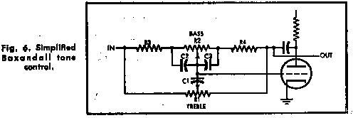

That circuit looks a hell of a lot like a Baxandall tone control.
I would highly recomend this circuit. I have used a passive version of the Baxandall circuit before, and it has very impressive results, offering a very wide range of tonal variations considering just two controls, bass and treble... and set bass and trebble both in the middle, and in theory you're getting a completly flat frequency response from the circuit.
i attached a schematic from an old article i have that is acutually about anode followers... but it discusses Baxandall's tone control in there as this utilises an anode follower, so therefore, in the article, there was provided this highly simplified version of a Baxandall tone control.
I say you should build it... my 2 cents

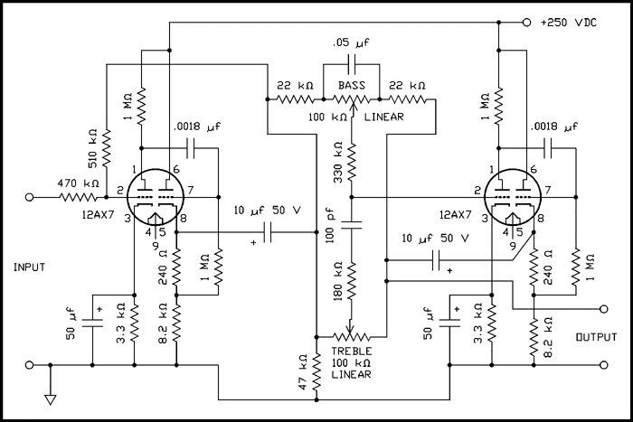

You'll find that this (modern ?) circuit uses readily available 100k potentiometers for the controls. In order for the gain stages to drive the Baxandall filter with these values, the cathode follower buffer stages (right halves of the 12AX7's) are required.
In fact it is possible to build simplified versions of the circuit using single gain stages (e.g. 12AT7) if very large resistances and small capacitances are used in the Baxandall T-networks. For example the LEAK tone control circuits used 500k, 2M, 5M potentiometers which are hard to find today.

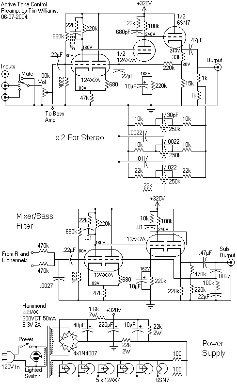

I'll add my active preamp design then

Woulda used pentodes but there aren't many dual input dual pentodes (don't think 6HS8 won't work) and I didn't feel like loading up on 7 pin tubes. 😉

Tim,
This is not baxandall right? Are the tone controls located in what seem to be a feedback loop?
How does it sound?
JojoD
How does it sound?
JojoD
It's just three controls, low mid and high. Still Baxandall, more or less, as far as I know. Just because it's active doesn't change the topology of the tone control.
Tim
