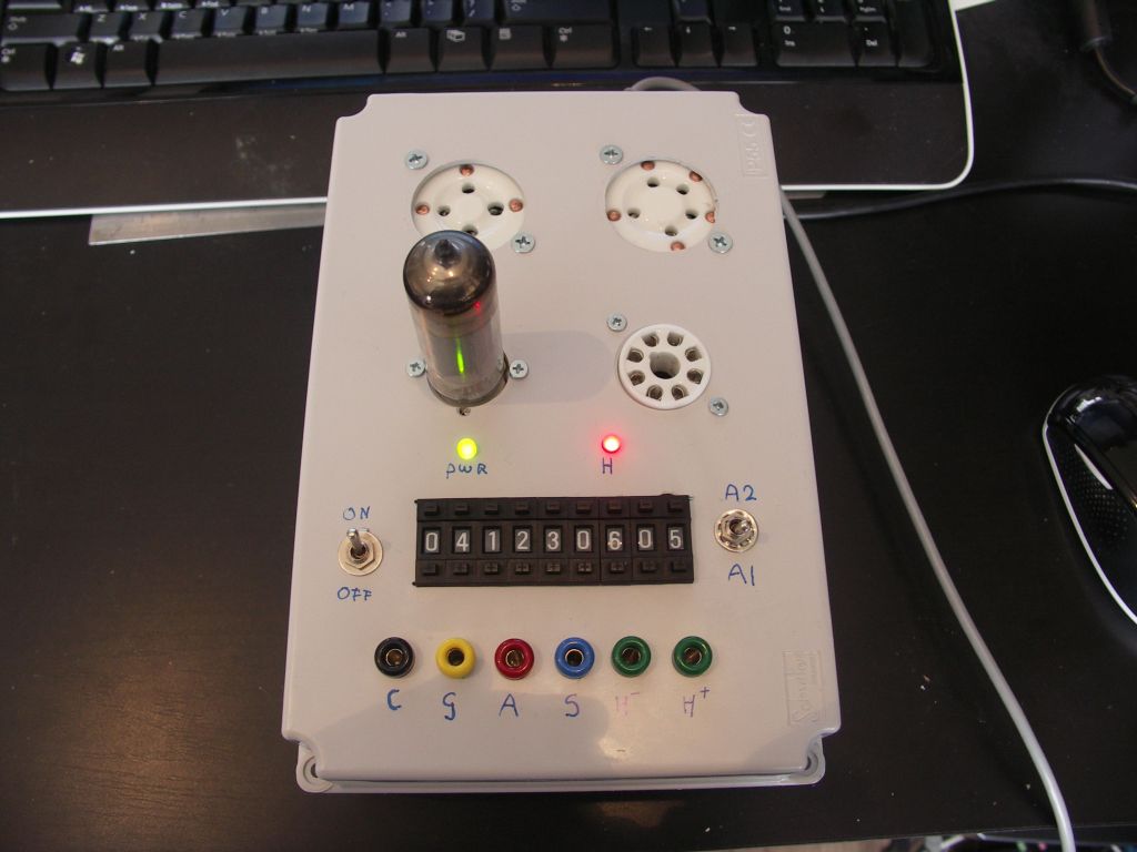

I was chatting to Ronald about your implementation - those thumbwheel switches are normally only rated for 100mA switching and 500mA max @ 250V.
That means you may have a serious risk of a meltdown on the heater switches and and arcing on the screen & anode...
Though the thumbwheels look neat, I've decided to go the simple plug-and-socket route...
It was a big search for these switches. Fortunatly, these switches can hold 3A at 28 volt dc. And indeed switch 125 mA at 125V ac. They have an Insulation resistance of 1000MOhm at 500V, an a dielectric Strength of 600V for 1 min.
So they are sutable for this purpose, it's just important not to switch during a test..

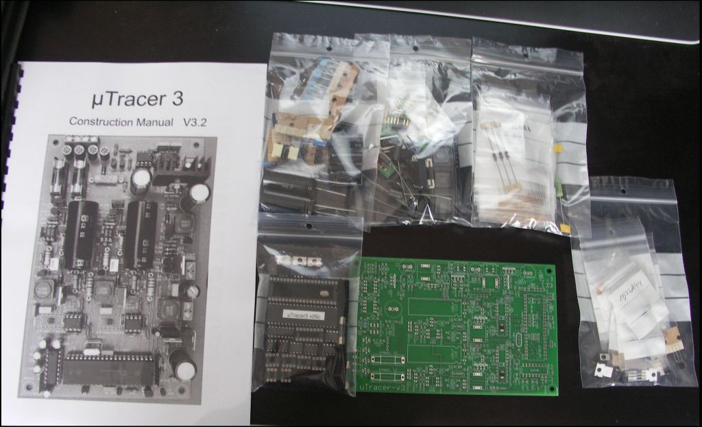

The uTracer is kit, it has the PCB and all components needed to build the PCB, including the construction manual. In the picture you can see what's in the kit
You can allready see how the PCB is build, and download the software
It uses an old Laptop powerunit to power. So no big expensive transformers needed.
The kit is 195 Euro.

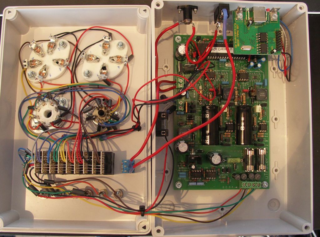

On my tracer I use an USB to TTL convertor for the connection to my PC, My PC has no serial connection. The convertor is a kit from ELV more info here: Optisch getrenntes USB-Modul UO 100, Komplettbausatz | ELV-Elektronik
I use some old Tube sockets, a noval, a octal, an UX4 and an UX5 socket and some wire.
I think all together I spend 300 - 350 Euro.
