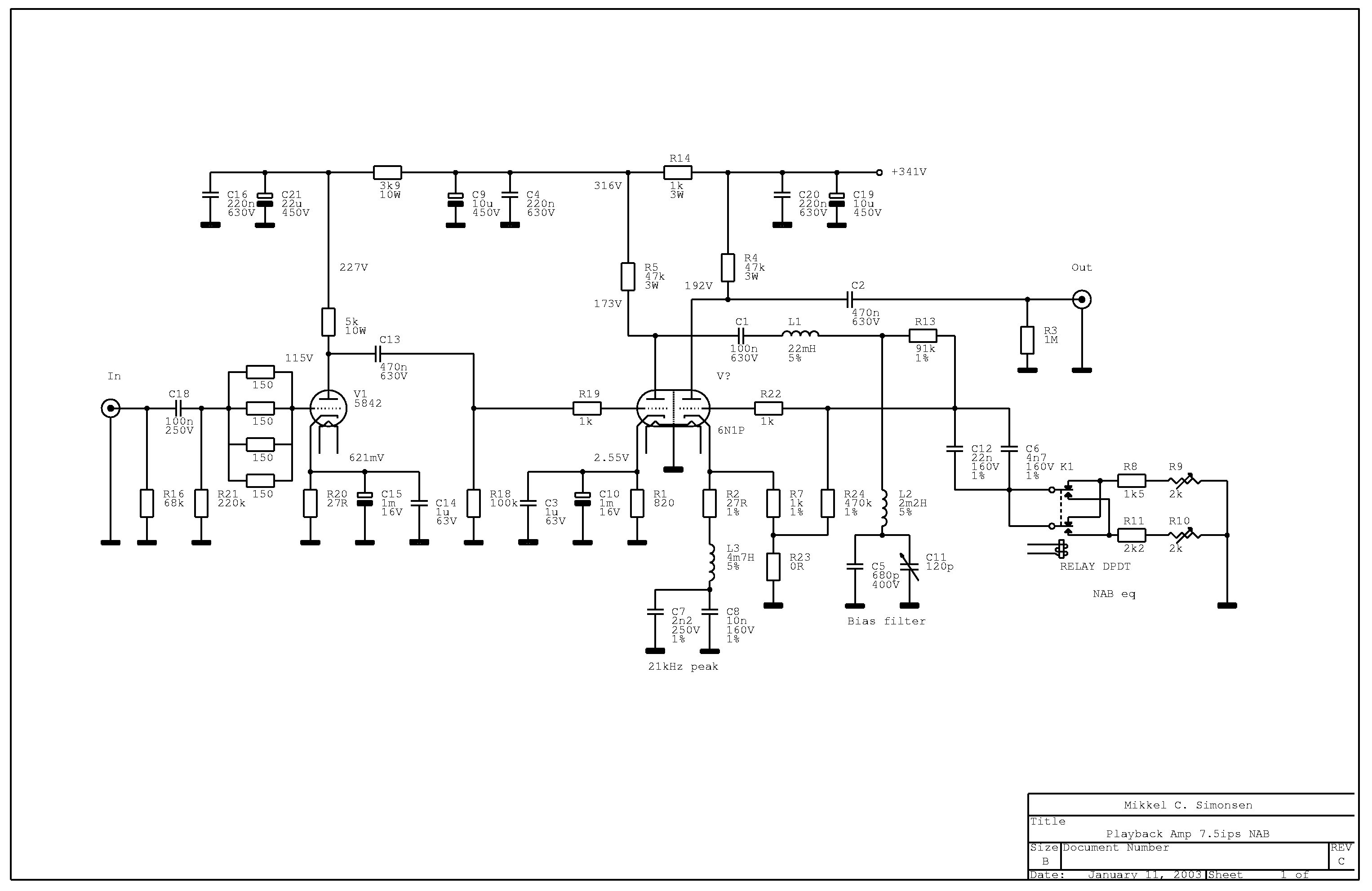

Since you have the benefit of the designers' explanation of the circuit's function, maybe consider neutralizing only the NAB EQ. If the compensation is for tape head limitations, or other factors that are not related to NAB equalization, leave them in. Bypassing a 27 ohm Cathode resistor with a 4700uF electrolytic is likely to be misleading if the 'bypassing' was precisely R2, which would increase the effect of the 21kHz peaking filter. From your description, it sounds like you went Cathode to Ground (which I would call 'correct'), eliminating the 21kHz peaking; but you still have the 4700uF capacitor's shortcomings, which may not be insignificant compared to R2's value, 27R.
Best Regards
Thanks Rick for the information. If I understand it correctly, I should leave the Bias filter (L1,L2,C5,C11) and 21KHz peak filter (L3,C7,C8) connected and only disconnect the NAB EQ (C6,C12,R8,R9). I also understand that the playback head has an impact on the FR as well as the coupling caps, therefore I've done 2 more tests, both of them with the EQ disconnected.

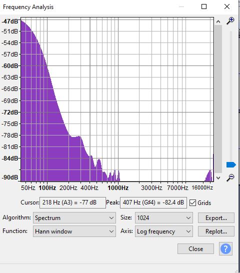

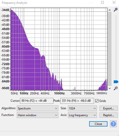

Here is another weird thing. One of the EQ test in the Tandberg service manual is to run a sweep against the playback head and check the response of the EQ output against their FR graph. This test is in case I don't have an MRL test tape. The weird thing is that performing this test, both the internal EQ and the tube EQ has very similar performances. I'd say the tube eq is an even closer match to their graph. See first pic.
However, playing an actual MRL tape or recorded tape has total different FR between internal and tube EQ. The MRL is not good for this but use it as reference. See pic 2
