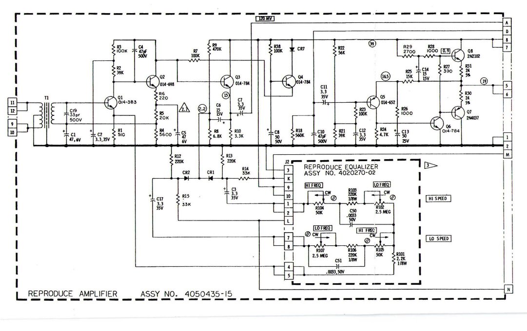

After reading some papers on Cascode ampllifiers I am inclined to belive that it could be the right aproach for the project to acheive the minimum noise Though informations were about using transistors, not tubes. I had two tubes in mind: D3a and Philips 6021. The second one in particular look interesting to me bacause of it's miniature size, and it is described as audio tube. Did anyone had experience with any of the tubes?

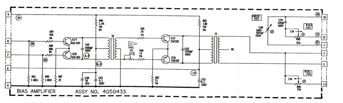

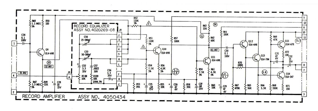

I have attached diagrams of PB, Record and Bias amps.

The MM1200 is a 16 track machine. That is a large number of amps to construct. I would not attempt it with a multritrack. If you want a tube sound, why not seek out an MR70 Ampex (nuvistor) or Studer C or J 37. Both are all tubes, but only 4 tracks on the J37 and 2 tracks on the others. Regards
I am looking into geting Studer C37 (if can find one) as mastering recorder. Ampex MX70 does not have enough channels and is using 1/4" tape where crosstalk can be a problem. My MM-1200 is 8 channel machine, reasonable number, and is using 1" tape, making it very good choice from channel crosstalk point of view.

The problem of handling mag. tape playback and mag. cart. playback of records is identical, save for different time constants in the EQ network. I strongly suggest you check Allen Wright's hybrid cascode circuits out. Sadly, AW is no longer with us, but fellow "Aussie" Joe Rasmussen should be able to provide some assistance.

No need for transistor cascode, microphone input transformers for tube gear can be used here. Like 600 Ohm CT : 40 KOhm. For input stage I would recommend 6S17K-V planar triode, it is the best tube I know for sensitive input stages. I use such combinations in microphone preamps, they are deadly silent.
Thank you Wavebourn, I will take you suggestion in consideration; never heared of that one, but something very silent would definitely be appreaciated as input for recording stage...
