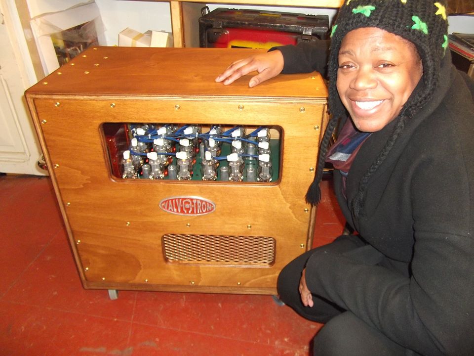

I run my speakers (inclus a 10" sub) from a commercial sold Prima Luna Prologue 4 amp (35w) and easely hit 25Hz with it (i did run the 10" ported before tuned to 25Hz). But that is a very advanced PP amp with EL34 output tubes amp with good OPT's that can handle that. It's not impossible, but you need a good OPT and a well thought over amp circuit i think.
And a British guy i know called Paul Axis runs a retro reggae soundsystem (Axis Valv-A-Tron) with a self build 1500w tube amp on the bass section (tuned to 35Hz). It has a lot of 807 tubes. It's a huge monster, but it sounds wonderfull. Not easy to build and maintain altough, but he is a tube amp specialist who also sells (smaller) tube amps and more for a living. The photo attached is that amp next to his wife (for size reference like he said).
You can find more info about this soundsystem here: Axis Valv-a-tron Sound System. - Home | Facebook
