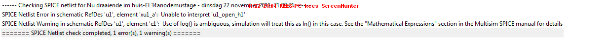

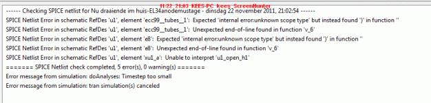

Hi there
I have troubles with simulation models in multisim.
maybe someone can help what it means these errors, I am not yet as good
with making models.
I have include the models for use it have a lot in them, also the difficult ecc99, 6n6p etc, and the power penthodes and triodes.
I made a snip from screen with the errors, it is in multisim tryout.

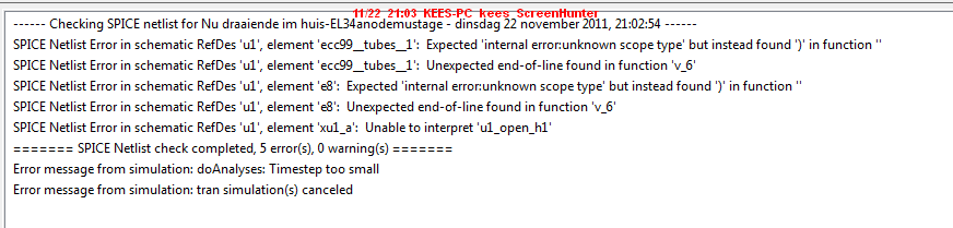

Hi there
with making models.

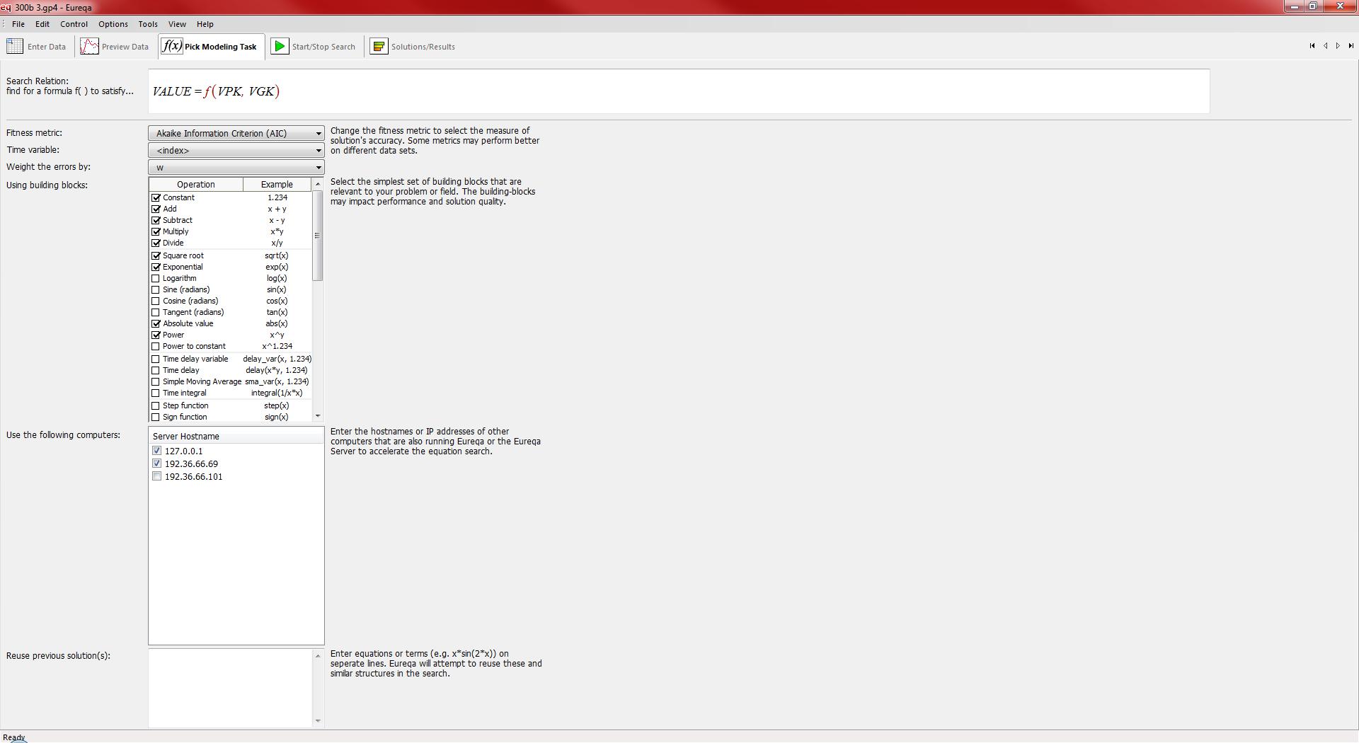

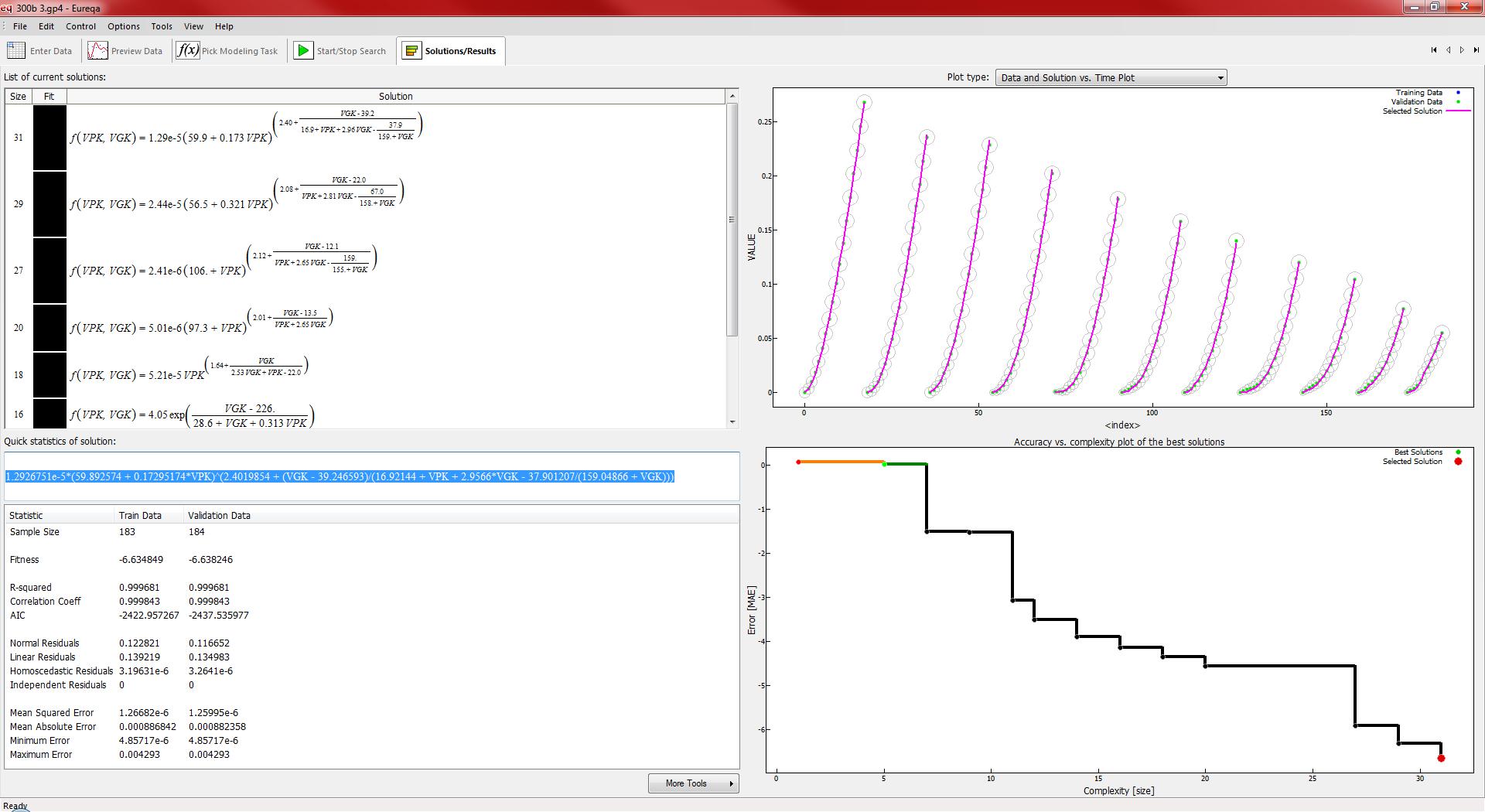

Eureqa

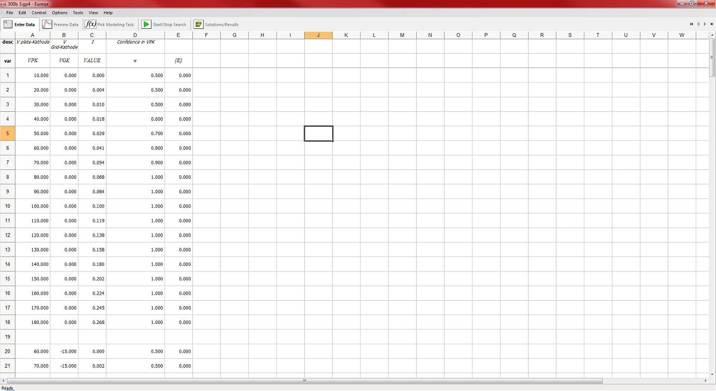

If been trying out the Eureqa program for modeling tube curves. Once you get the hang of the program and have the right settings the outcome is quite usable.
Not all solutions found work well in spice, especially the "big size" formulas tend to give problems (I used MicroCap).
Best results so far were obtained when using the "Akaike" Fitnes metric.
I used Excel to obtain the points needed for Eureqa.
Attached are the Excel file and some pictures, I used an 300b curve.

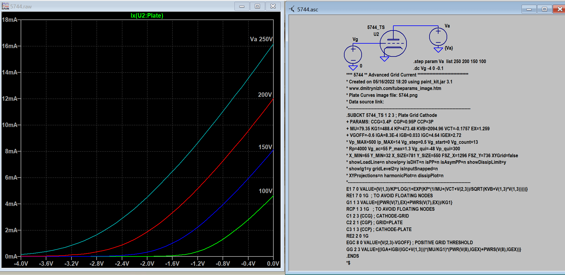

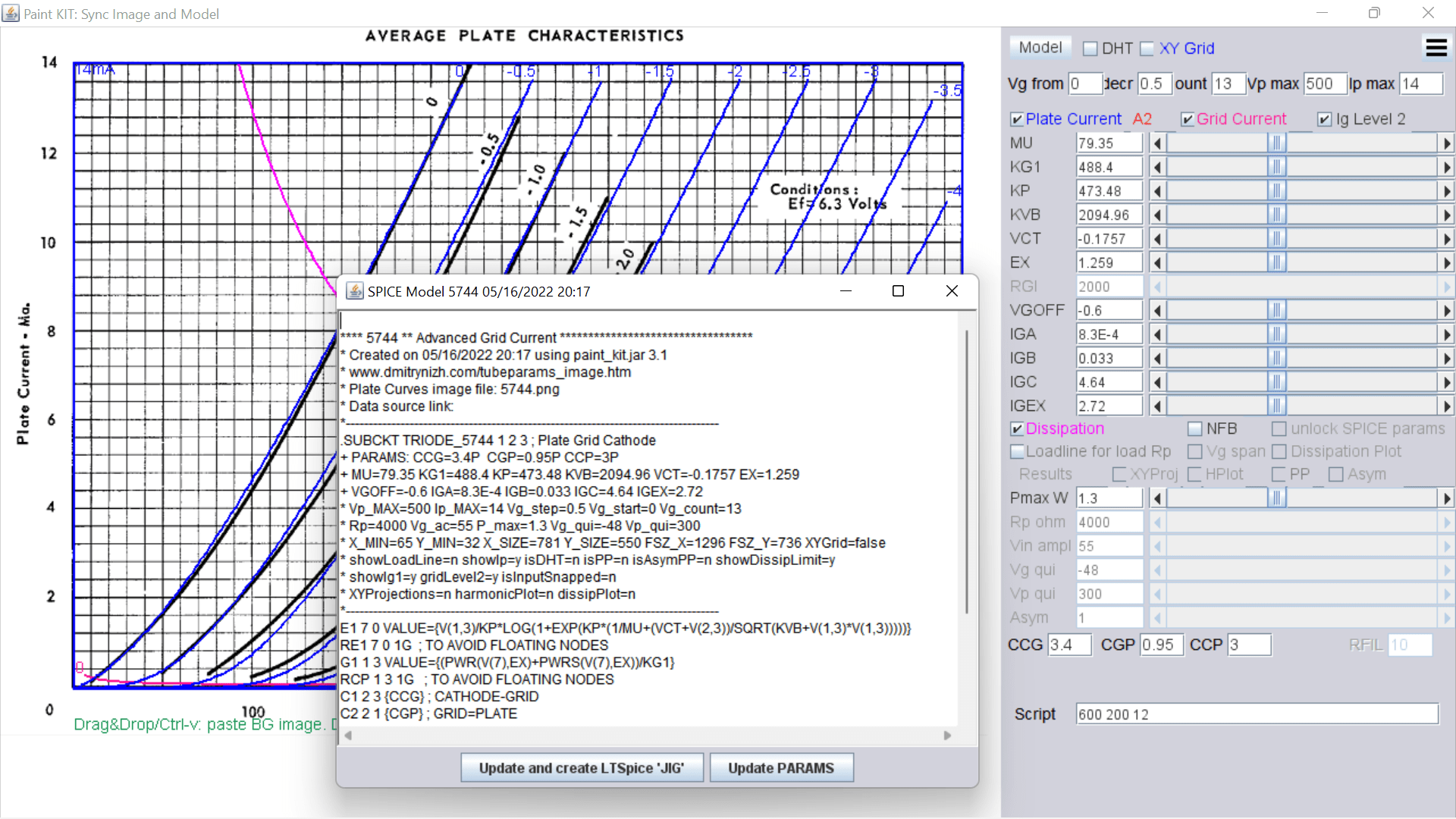

Does anyone have an alternative LTspice model for 5744 tube posted above?
I'm using it to simulate a guitar amp. For low signals (below clipping) all works well. For large input signals, the simulations never complete as the time steps get very small and the output signal can get very large (i.e. mega volts instead of hundreds of volts). For the same circuit i've used other tube models i.e. 12ax7 and 8532w model and it works perfectly in my circuit, but when I use the 5744 model listed above it never converges, hence the request for an alternative model.
Kind Regards,
Ted
Convergence issue maybe resolved with the following options (example) and use Alternate resolver (in Spice control panel):
.option noopiter
.options GminSteps=0
.options SrcSteps=1000

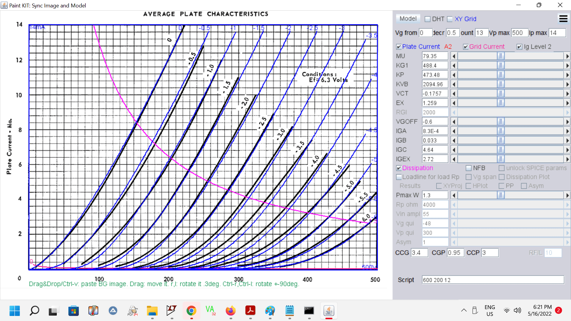

Here is Paint Tool Tung-Sol model to try:
.option noopiter
Code:
**** 5744 ** Advanced Grid Current **********************************
* Created on 05/16/2022 18:20 using paint_kit.jar 3.1
* www.dmitrynizh.com/tubeparams_image.htm
* Plate Curves image file: 5744.png
* Data source link:
.SUBCKT 5744_TS 1 2 3 ; Plate Grid Cathode
+ PARAMS: CCG=3.4P CGP=0.95P CCP=3P
+ MU=79.35 KG1=488.4 KP=473.48 KVB=2094.96 VCT=-0.1757 EX=1.259
+ VGOFF=-0.6 IGA=8.3E-4 IGB=0.033 IGC=4.64 IGEX=2.72
* Vp_MAX=500 Ip_MAX=14 Vg_step=0.5 Vg_start=0 Vg_count=13
* Rp=4000 Vg_ac=55 P_max=1.3 Vg_qui=-48 Vp_qui=300
* X_MIN=65 Y_MIN=32 X_SIZE=781 Y_SIZE=550 FSZ_X=1296 FSZ_Y=736 XYGrid=false
* showLoadLine=n showIp=y isDHT=n isPP=n isAsymPP=n showDissipLimit=y
* showIg1=y gridLevel2=y isInputSnapped=n
* XYProjections=n harmonicPlot=n dissipPlot=n
E1 7 0 VALUE={V(1,3)/KP*LOG(1+EXP(KP*(1/MU+(VCT+V(2,3))/SQRT(KVB+V(1,3)*V(1,3)))))}
RE1 7 0 1G ; TO AVOID FLOATING NODES
G1 1 3 VALUE={(PWR(V(7),EX)+PWRS(V(7),EX))/KG1}
RCP 1 3 1G ; TO AVOID FLOATING NODES
C1 2 3 {CCG} ; CATHODE-GRID
C2 2 1 {CGP} ; GRID=PLATE
C3 1 3 {CCP} ; CATHODE-PLATE
RE2 2 0 1G
EGC 8 0 VALUE={V(2,3)-VGOFF} ; POSITIVE GRID THRESHOLD
GG 2 3 VALUE={(IGA+IGB/(IGC+V(1,3)))*(MU/KG1)*(PWR(V(8),IGEX)+PWRS(V(8),IGEX))}
.ENDS
Thanks kindly for your time and for generating the model. It works perfectly. I can overdrive the preamp now without any issues.Convergence issue maybe resolved with the following options (example) and use Alternate resolver (in Spice control panel):
.option noopiter
Code:**** 5744 ** Advanced Grid Current ********************************** * Created on 05/16/2022 18:20 using paint_kit.jar 3.1 * www.dmitrynizh.com/tubeparams_image.htm * Plate Curves image file: 5744.png * Data source link: *---------------------------------------------------------------------------------- .SUBCKT 5744_TS 1 2 3 ; Plate Grid Cathode + PARAMS: CCG=3.4P CGP=0.95P CCP=3P + MU=79.35 KG1=488.4 KP=473.48 KVB=2094.96 VCT=-0.1757 EX=1.259 + VGOFF=-0.6 IGA=8.3E-4 IGB=0.033 IGC=4.64 IGEX=2.72 * Vp_MAX=500 Ip_MAX=14 Vg_step=0.5 Vg_start=0 Vg_count=13 * Rp=4000 Vg_ac=55 P_max=1.3 Vg_qui=-48 Vp_qui=300 * X_MIN=65 Y_MIN=32 X_SIZE=781 Y_SIZE=550 FSZ_X=1296 FSZ_Y=736 XYGrid=false * showLoadLine=n showIp=y isDHT=n isPP=n isAsymPP=n showDissipLimit=y * showIg1=y gridLevel2=y isInputSnapped=n * XYProjections=n harmonicPlot=n dissipPlot=n *---------------------------------------------------------------------------------- E1 7 0 VALUE={V(1,3)/KP*LOG(1+EXP(KP*(1/MU+(VCT+V(2,3))/SQRT(KVB+V(1,3)*V(1,3)))))} RE1 7 0 1G ; TO AVOID FLOATING NODES G1 1 3 VALUE={(PWR(V(7),EX)+PWRS(V(7),EX))/KG1} RCP 1 3 1G ; TO AVOID FLOATING NODES C1 2 3 {CCG} ; CATHODE-GRID C2 2 1 {CGP} ; GRID=PLATE C3 1 3 {CCP} ; CATHODE-PLATE RE2 2 0 1G EGC 8 0 VALUE={V(2,3)-VGOFF} ; POSITIVE GRID THRESHOLD GG 2 3 VALUE={(IGA+IGB/(IGC+V(1,3)))*(MU/KG1)*(PWR(V(8),IGEX)+PWRS(V(8),IGEX))} .ENDS *$
In regards to your screenshots, ive noticed that all your sliders are in the center.
Did the program auto-generate the parameters or did you manually slide them until you got close enough?
Once again, thankyou.
