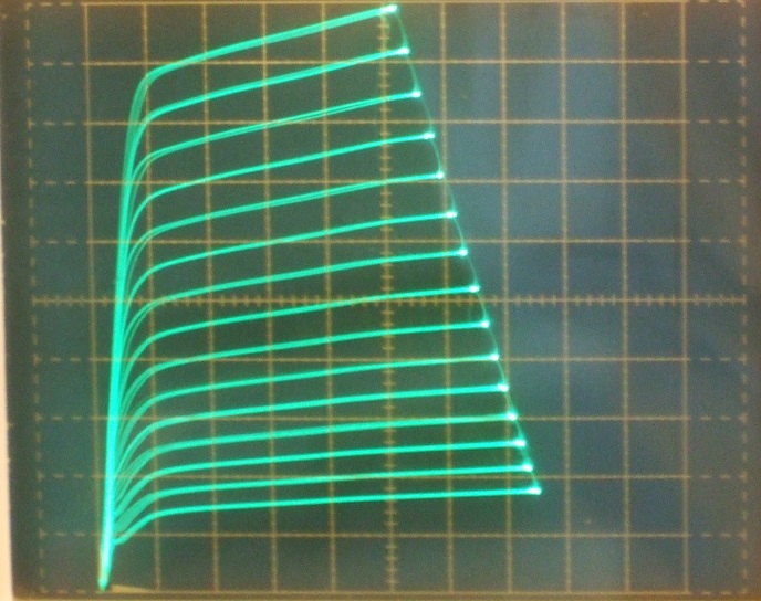

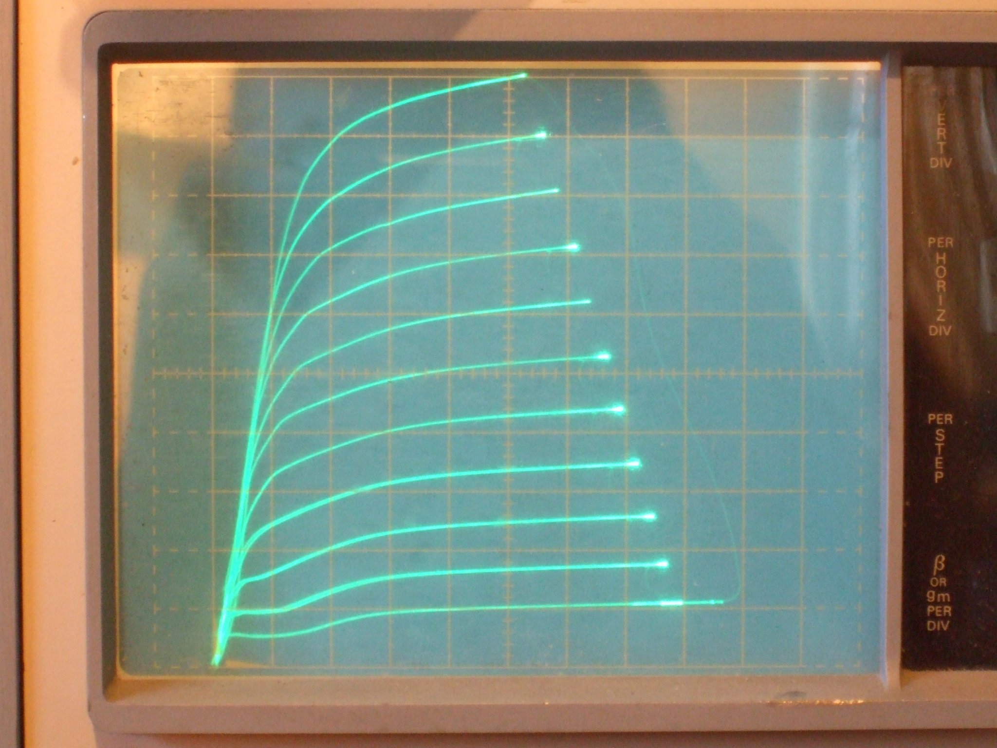

Sometimes shifting the Vg2 a bit can bring two tubes into convergence. Some tubes however may have the grid/cathode mis-aligned with one side closer to the cathode or tilted, frame grid tubes for example. Bad triode curves then. Then there is mis-aligned grid1 and grid2 wires, which will cause high g2 current and big kinks.
Then there is low emission, which a tube tester can find. Back in the $1 tube days I always bought a 100 pcs for matching up (usually small tubes ). For output tubes a trim pot or two for adjusting Vg1 and Vg2 is a good idea. ( no UL here ) Be prepared to throw out a few tubes. Some tubes are hard to imagine what they did to them. I did find a sealed box of 200 6197 Mil Spec tubes which were so close as to be matched by random selection.
Good tube:
Kinked tube:
Nirvana:
