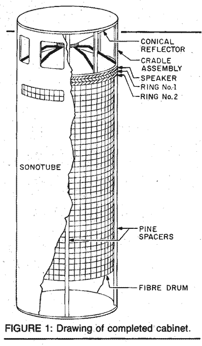

a speaker built into a cylinder works fine. With a 6” pipe you have some flexibility (i’d not put a 6” into it, you might consider a 4 or 5” FR.
I haven’t done anything ever with a PR, but have taken advantage of the length of th etube to make an ML-TL.
Laying Pipe with Audio Lego
the toobs Mk 1
Attached is a double tube TL for a big bass driver from a Speaker Builder project.
Linkwitz Pluto uses a tub eloaded woofer.
Quite common to use a paper concrete form tube for subwoofers.
dave
