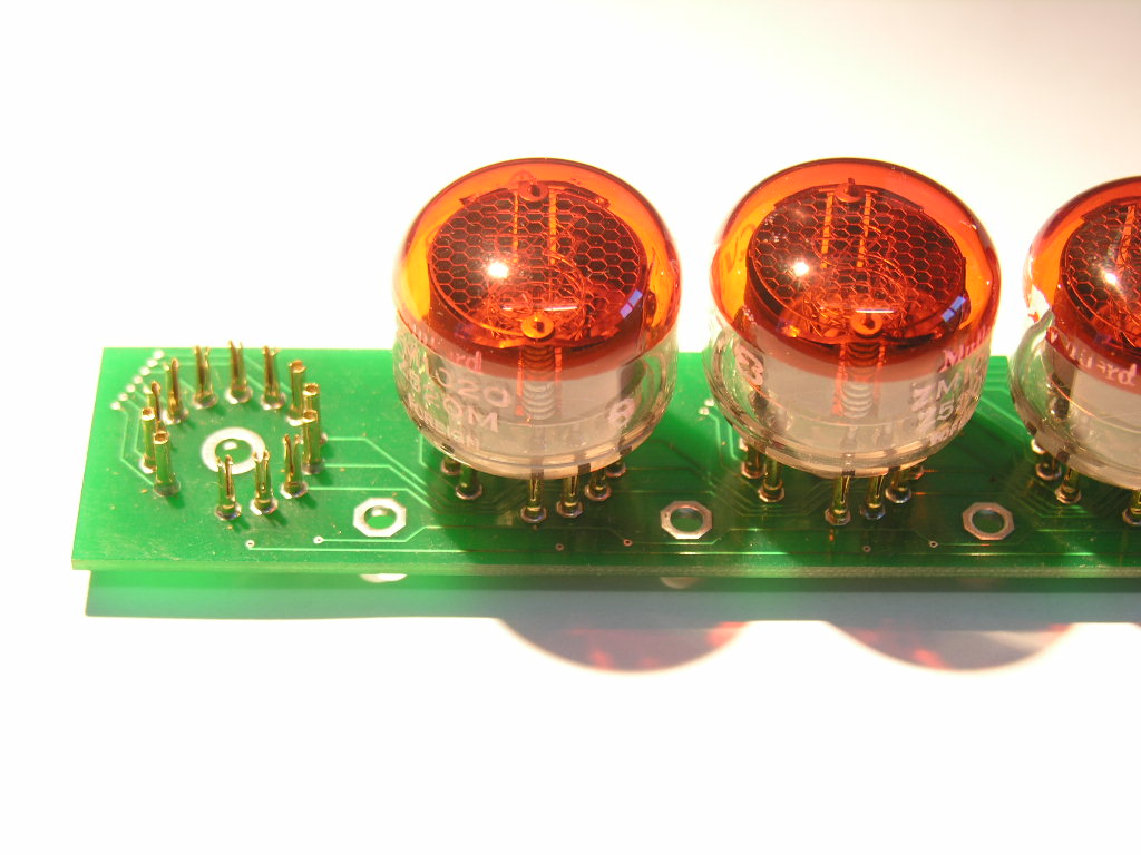

I'm trying to come up with PCB mount tube socket for a Russian IV-12 VFD tube.
It's a 10-pin miniature, in the same circle as a 9-pin miniature (12mm pin dia.) but with closer pin spacing (32.7 degrees vs 36 degrees)
I tried some Mill-Max PCB pin receptacles. Best is 0312 but non-stocked and $0.89 per pin = $8.90 a socket. The 0314 is great but the collar shorts to adjacent pins. Not sure who else makes receptacles.
Someone else ripped pins out of cheapo plastic 9 pin sockets and used them.
Any ideas?

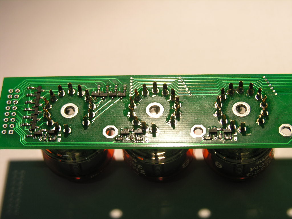

I use the sockets out of D25 female connectors and use this :
Valve & Nixie Socket Calculator
to calculate the positions of the PCB pads when I make a Protel footprint
for the component.

That's a great idea! I'd thought D-sub pins are smaller than tube pins (1mm/0.040") but looking again, I find they're the same size. What part are you using? I found solder-cup ends which I assume you press thru your PC board. HDP-20 series AMPLIMITE D-Sub Connectors (AMP 66569-3) looked okay with about 0.075" PCB holes.
Otherwise, it's the (expensive) machined contact pins Mill-Max 0314 or Keystone micro-jack #1414 would work for tube sockets.
Yep, they are just regular solder bucket cheapies, sorry don't have a specific part number - 25 pin sockets for around a buck seems a good deal!.
