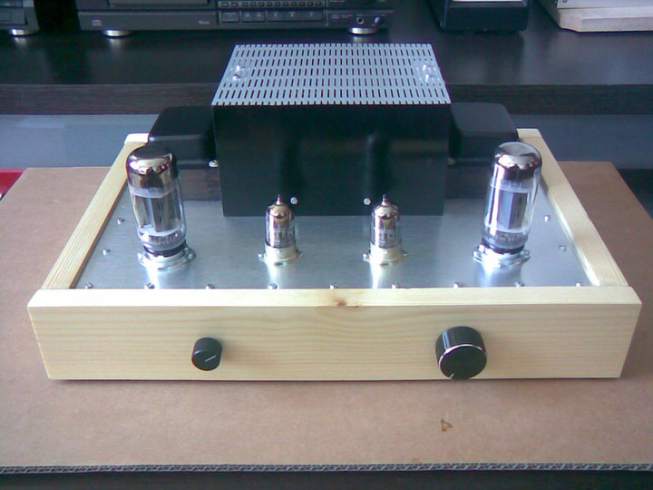

This is one of my SE amplifier , last build .
Inside an Pioneer Amplifier case .
It is made with 6n2P in srpp follow by a 6P3S final class A tube.
It has a smps power source and a control/selection/volume with shunt control by an atmel atmega16 with IR remote control.

Nice!
What kind of output transformers do you use?
In house made by a friend of mine .Nice!
section : 8 cm sqr
primary nr. turns : 2000 , coper enameled 0.2 mm
secondary nr. turns : 90 , coper enameled 1 mm
air gap :1mm paper sheet
Better transformer
section : 12 cm sqr
primary nr. turns : 2400 coper enameled 0.2 mm in 3 section (aka 3 x 800 turns in series)
secondary nr. turns : 2 x 120 coper enameled 0.6 mm in parallel
air gap : 1mm paper sheet
In this order : PSPSP

The 6P3S are interchangeable with 6V6, they sound nice too but give lesser power.
I use a 5K transcendar output transformer and a B+ of 315V (measured to ground!)
I like your idea to use a SMPS for tube amplifiers. Do you design switch mode power supplies?

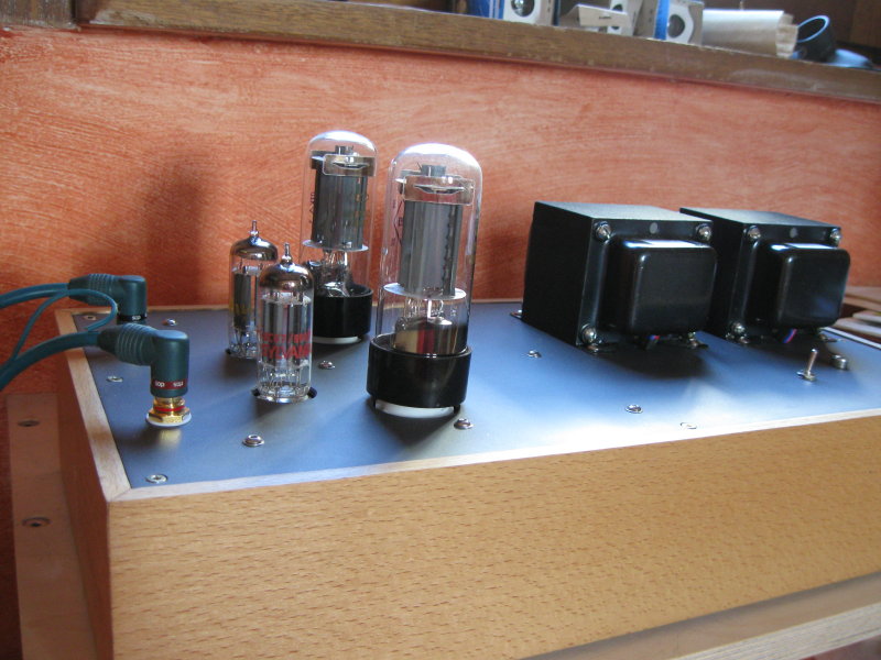

hi,
I like this amp. I was thinking of building a 6v6 se. I also wanted to use russian tubes, so this looks like a good match.
what is the current draw of the amp? - I will need to design a PS using powersupply designer from ducan amps. I have 5k ot and a 250-0-250 150ma power transformer and 15h choke ( from diy 6em7 amp).

Hi Jeff
OPTs and power trafo is correct,
for 250VDC in SET, the power is minus than you 2A3
I think that 315V , are excessive, although case of Russian tubes, I am not surprised ..... (more whit 6P14P-EB at 400/430V plate, 400V g2 into PP UL "7189-A")
If I am not mistaken, they are aprox 36mA and 10 more in tetrode or UL,
Supposedly a warm sound T/UL... compared to SET 2A3, is supposed to play in a higher
league the 2A3.
On the other hand, I have brought many surprises, especially with EL34s, 6L6 according to the harvest....
Leaving aside the comparison, if you can expect a warm sound with 6P6C (Russian 6V6).
The ripple from the PSU, with the 6V6 power that is inaudible easily, depending also the sensitivity of their speakers.

For 6V6 is enough 150 mA
but for 6p3S 200 mA is a minimum for amplifier to work ok .
Me : I draw 80mA per 6P3S tube wich is 160mA for final tubes and another 10...20mA for SRPP tubes module.
Both for 6V6and 6P3S the 5K opt impedance is super OK !
For me there are big difference between 6P3S and 6V6 which is 6P6S Russian tube .
After a lot of experiments and listening i will stick with 6P3S , trust me on that ....
