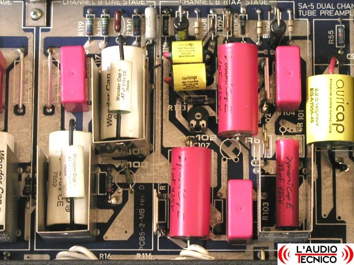

Hi fellow DIY'ers,
Thank you so far for the discussion, I learned a lot. Now, a few more things.
Sorry all for the very first picture of the screening can. As I searched, I find better ones which touches the tube with some springy parts inside. The are clearly better at heat reduction, and if I had attached a picture of better design before, it would definitely have helped the "heat" in the thread 🙂
Now, we talked before that, if the tubes are inside the metal chassis no more screening is necessary (since my transformer is out of the main chassis). Would you please see the attached picture below. This is a generic internet picture of my pre-amplifier. Have you noticed the the screen cans around the capacitors? They are input and output coupling caps of the RIAA and Line stage. In fact this was the reason to consider screening cans for my tubes. Even some caps have them, why not tubes? Am I comparing apples and oranges here?

Is this a Counterpoint?
No, not apples and oranges, but rather fashion voodoo versus engineering.
Yes, it is. SA-5.1, to be specific. 🙂
Well, more than one member here on Diyaudio who are quite Counterpoint experts, recommends usage of them. l wish l could be happy with an iPod 🙂
