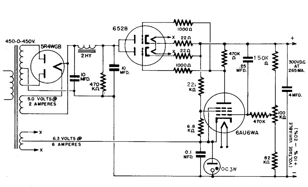

What do you guys think of this regulator design found in the Tun-Sol 0C3W datasheet for a tube power amp? Is it a good solid starting point? Would prefer to use an all tube power supply.

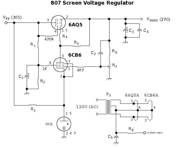

It's actually quite similar to a design (attached) I used. It works pretty good, and gave an output voltage deviation of 0.8Vdc for a 40V variation at the input side. Used here as a screen supply.

A regulator makes heavy use of negative feedback, and is likely to have a non-trivial output impedance variation with frequency. It can be as hard to get right as the amplifier it feeds. There is a case for regulated supplies for a phono preamp, because of the high LF gain and the need to isolate the signal from mains voltage variations. Elsewhere it is, in my opinion, usually unnecessary.
If you are pursuing voltage stabilization, have you considered transistorized stabilization/regulation? They will provide more reliable regulation while requiring no heater voltage with the added benefit of no tone coloring because they never see any signal gain.
It is still understandable to use Valve rectos. They are cool and classic and can still be worked with. Keep in mind though, sag will be reduced when using any regulation. Just be sure to keep those limiting resistors in series with the anodes (which are absent from the schem posted) and the reservoir limits in check.
