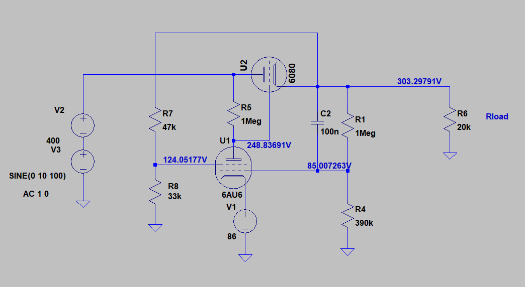

Hi all. I have determined the problem and it's quite mundane: the 12J7GT error amp was getting 6.3V heater voltage. After supplying the proper voltage all is well (and makes perfect sense, of course). I thank you all for your suggestions; i learn from you.
