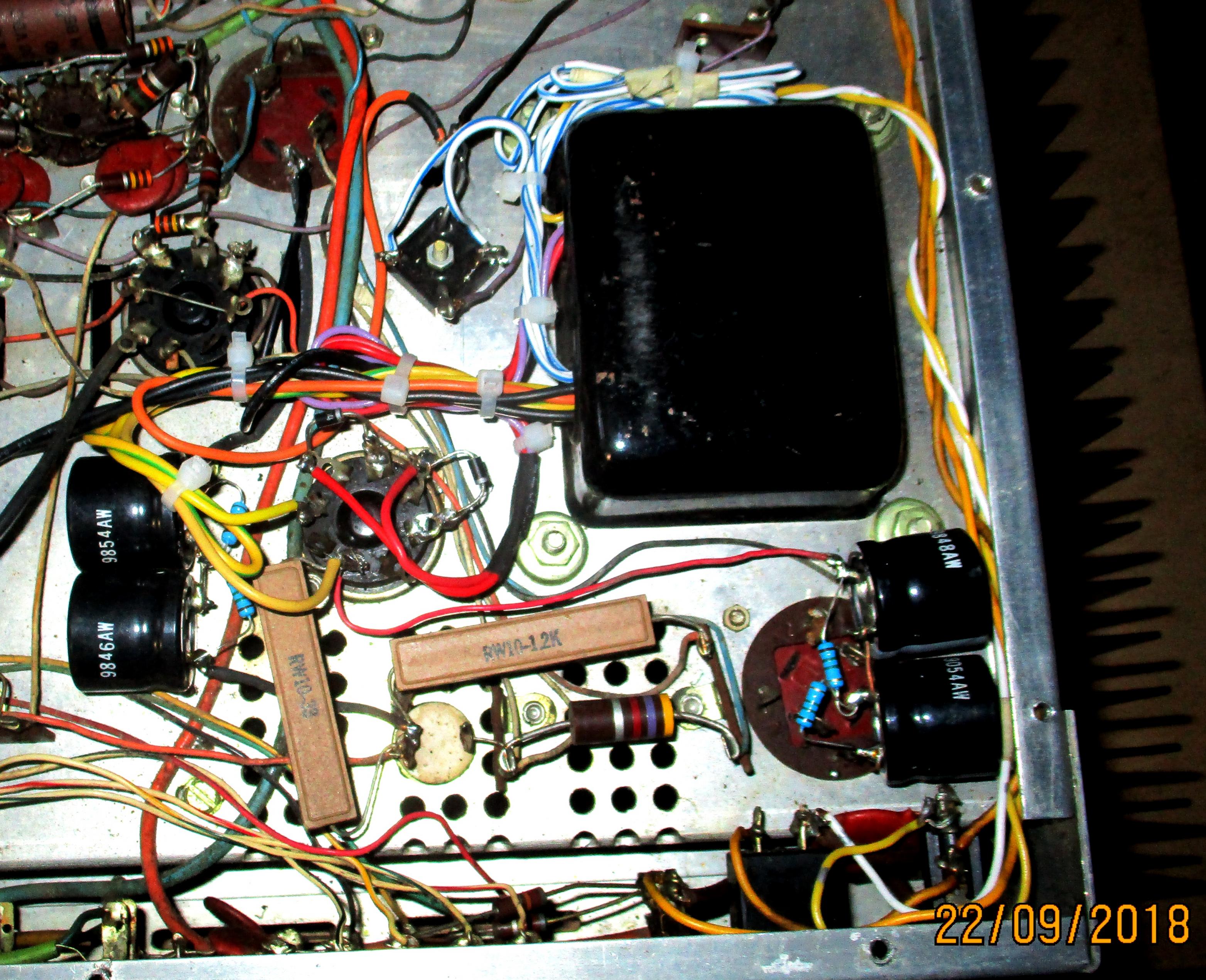

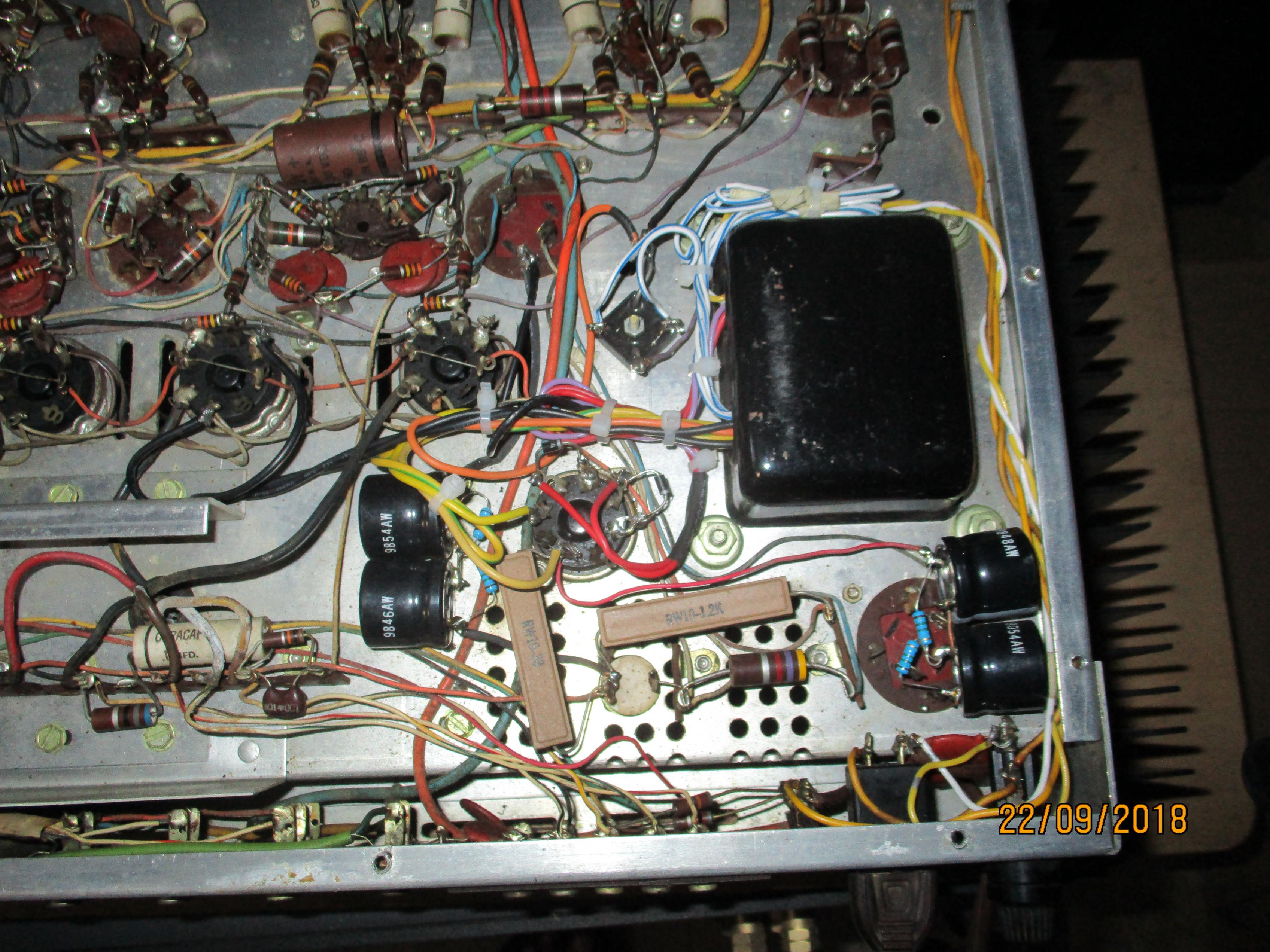

I didn't mean to throw several SS rectifiers in a tube base. Everybody has done that. Heck I have a half dozen of them with different rectifiers in the base and the base is filled with black silicone.
I meant soldering in diodes before the plates on the tube rectifier.
sorry, you lost me there....i know you meant this one....this is a Scott LK38 amp that had a blown power traffo...
