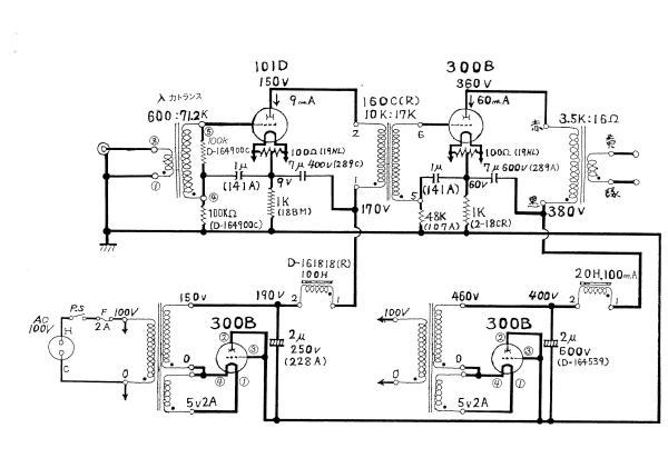

Here is a schematic of a SE 300b amp (Brought to my attention by Thorsten I think). Have not done it myself yet.

A diode-connected DHT will have a high impedance and low perveance (i.e., high voltage drop). Not exactly quality factors in rectification/regulation.
Well, the I/V curve follows the Vg = 0V curve, more perveance still if you connect G to P. (In this arrangement, a single 12AU7 triode runs 110mA at 20V; grid current is slightly greater than plate current!)
But yes, still quite ludicrous. Even more ludicrous than using 300Bs for output. Well, almost...
I concur but....
