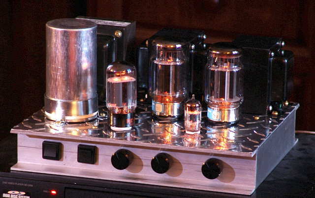

Just ordered my SSE PCB, and I'm filling online carts with parts now. I've come to the FRED diodes, and in my research trying to figure out what the heck a FRED is, I see that there's also the option to use a tube rectifier.
Well I'm a total NOOB, and I don't know really know what a tube rectifier is. But I get the impression it's better than the solid state options.
Is that correct? Is a tube rectifier the way to go?
If so, how do I implement it? What do I need to buy for it? Where does it go?
Should I just stick with solid state? If so, what's the current DigiKey part number for those FRED thingies?
I'm floundering here, people. I need a life preserver. Any help would be most appreciated.

The SSE board has the tube rectifier circuit built in. That is the function of the 5AR4 tube. Nothing special needs to be done to make it work as it is the default option.
The FRED diodes allow for a solid state rectifier option. They can be left out of the build completely if the solid state option is not desired as they do nothing if the rectifier switch is not installed. Most builders do not use them.
There are 3 components on the board that are not shown on all parts list, D3, D4 and TR1. They were added to extend the life of the rectifier tube. D3 and D4 are 1N4007 or UF4007 diodes and TR1 is a CL140 inrush current limiter. Make sure that you order them when you get parts, and the board will not work without them.

Say, since I've got your ear for a second, let me ask another question that's been on my mind. I purchased a "Motor Run" capacitor (this one), since that seemed to be a worthwhile upgrade. But it doesn't have any kind of mounting bracket, so I'm wondering what's the best way to ground the metal exterior of the capacitor to the top plate of the amp? Is that grounding even necessary?
The can should be grounded if it is exposed where it can be touched. It is possible for a voltage to appear on the can due to leakage currents making for a possible shocking experience.
I have the same cap in my SSE. I mounted it using a clamp intended for a "computer grade" electrolytic can cap. I pulled out of something I was taking apart, so I don't know where it originally came from.
