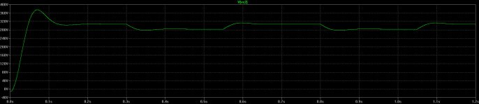

Felipe,

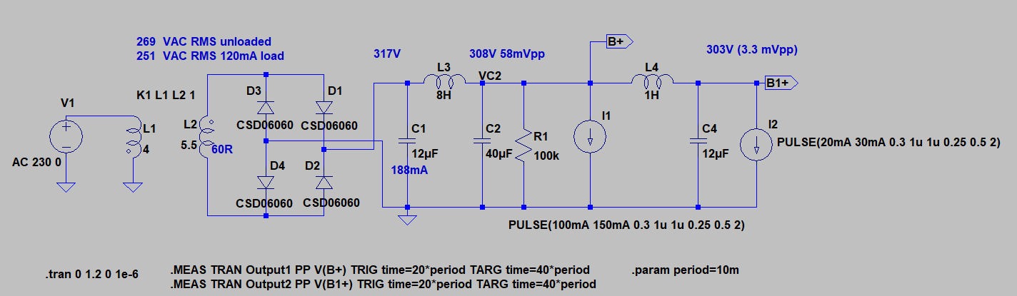

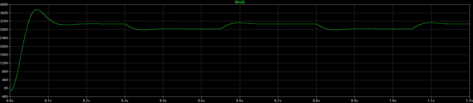

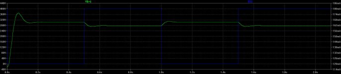

The "first bump" only shows the circuit "charging".
The real test is loading the output with repetitive current pulses.

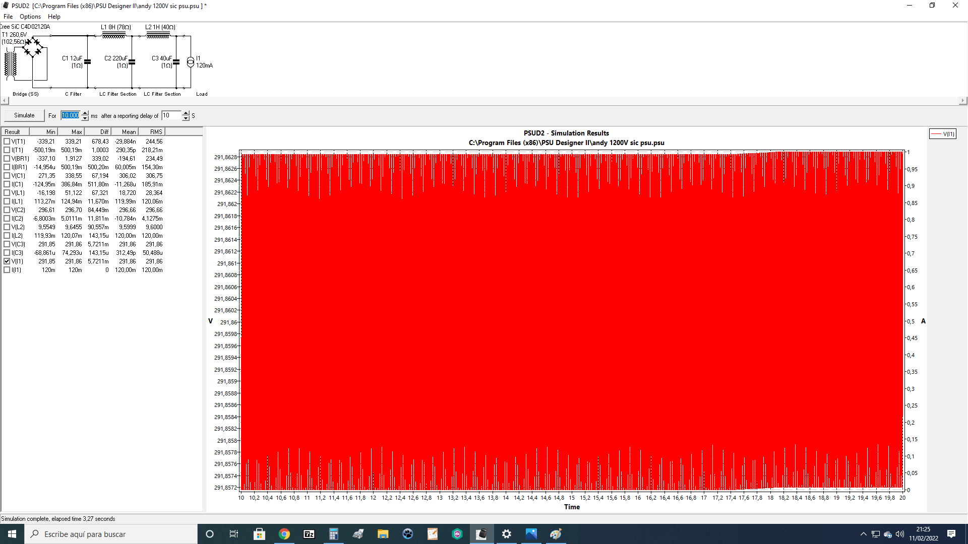

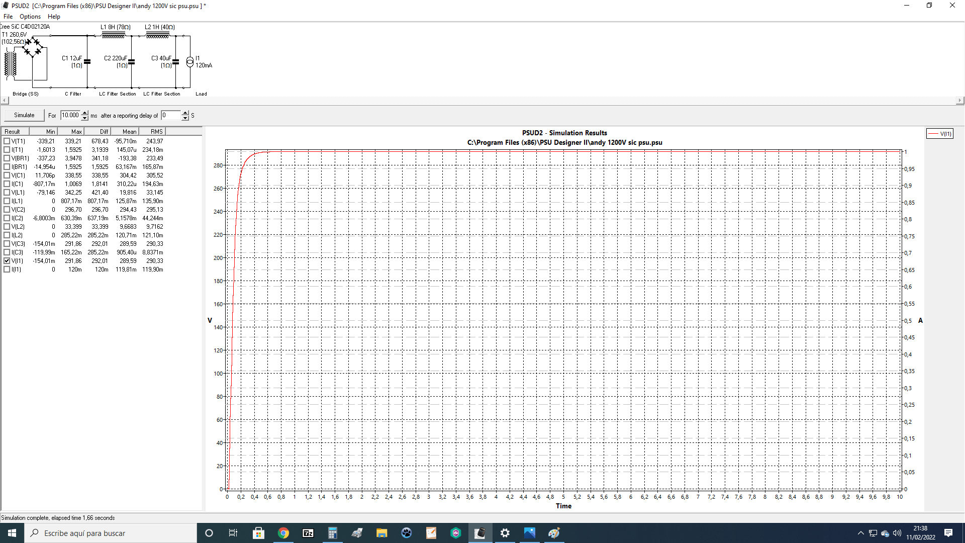

Bela I use PSUDII not LTSpice, but thanks for the info. If 1st cap 12uF, 2nd 220uF & 3rd 40uF he can get 5mV of ripple, also become fast without ringing.

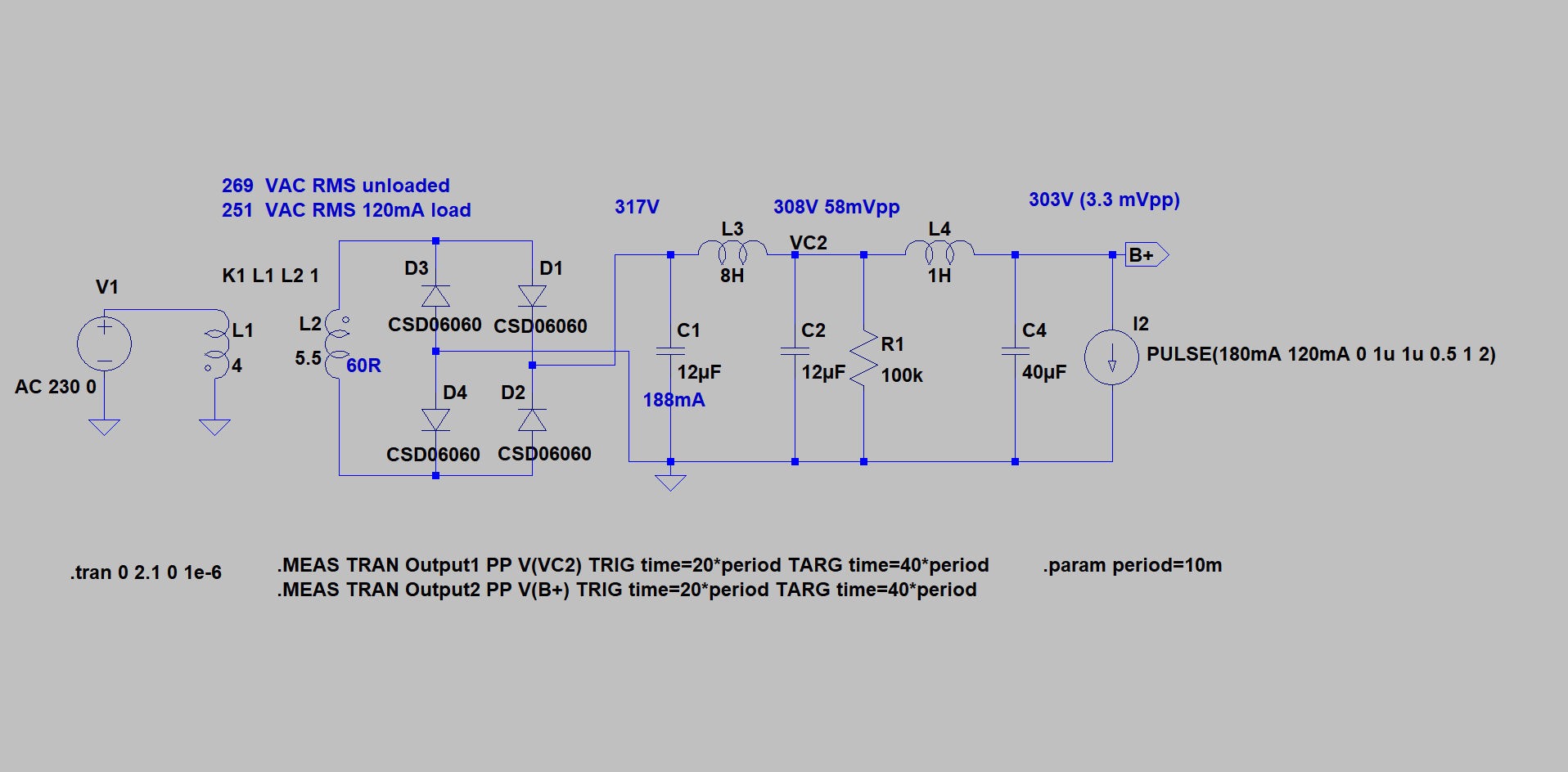

Thanks Bela - I'll try that. Anything else that would dampen the ringing more? I have DC Link 12uF and 30uF or 40uF. Plus some 68uF Kemet electolytics.

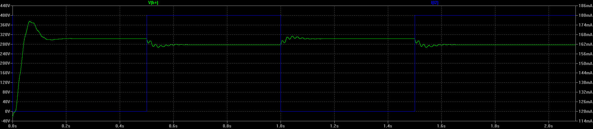

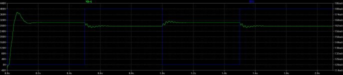

If you chaining CL modules the ringing always occurs. Selecting proper values of components may damping it.

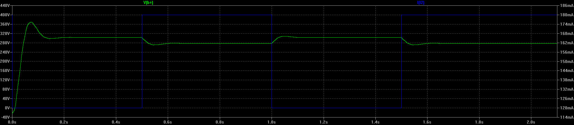

In my opinion the output of you PSU is over filtered.... if it is the "power" output.
3mVpp hum range is the preamp or phono territory.
The VC2 point (CLC: 308V 58mVpp) is rather the "real" amplifier power supply output.
If you want to test PSU, the load must be same as the "real", power amplifier stage current (steady current+peek current) on "power" output, and the VAS and driver stage current on "driver" output.
If this is the real case, the original PSU component values are OK.

Thanks Bela. Yes - this is the PSU for the 2a3/6C4C output stage. This has the book values, 250v, 60mA, -45v. So the PSU supplies 120mA at around 310v.
So what would you suggest as a "lighter" PSU? Leave the 2 chokes and use smaller caps....... something else?
I use a Mac and need to activate the download of PSUD. I don't have LT Spice.
I'd welcome all suggestions, especially a model that tests good using the components I have (or others). The 100K resistor is to discharge the capacitors fairly quickly. I always put that in for safety. It doesn't have to be after the second capacitor, but that's where I've seen it placed most often.

Try to use PSU as I sketched in #127:
12uF-8H-40uF for power tubes, 1H-12uF for another tubes.
If the hum too much for output tubes, try to increasing both capacitor in the first chain: -first- 12uF and 40uF. The 1:3 ratio is recommended.

PSUD2 will indicate the same 50Hz ringing on an output voltage waveform due to a step load change as seen in post #121. Perhaps a little easier to simulate in PSUD2 if someone is new to simulating power supply behaviour.
