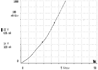

Well I don't know whether they give decent sag🙂 but I'm using 6cj3 damper diodes in my 845 amp and they sound great.
I'm using 4 in a bridge to supply 1250v (you'll need 2 for full wave rectification) and they drop 25v. They also don't have a top cap to knock off unlike other damper diodes like the 6D22.
