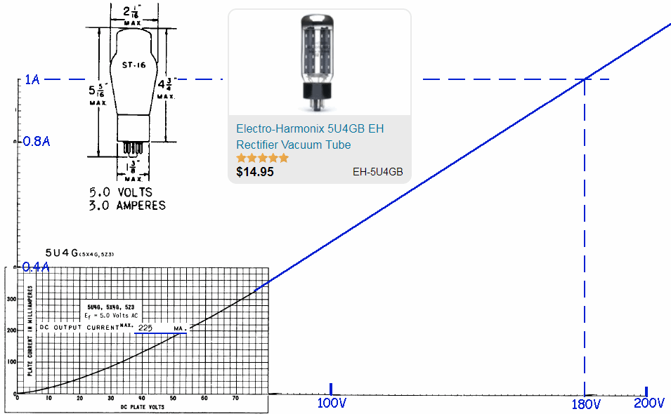

....tube rectifier but I need 12V at 1~2A output....
The drop of a vacuum rectifier can be over 100V, and no ordinary vacuum rectifiers are rated over a part-Amp.
The derivation attached is inexact, and 5U4 is not the biggest bottle, but was always a go-to for big amplifiers. You need nearly 200V in, and five bottles, to get 12V 1A out. The rectifier heats-up with 15 times the power that your DAC eats, about 180 Watts in plates. +Plus+ another 75 Watts in filaments.
And it will be far too saggy for powering digital chips. Building a vacuum Regulator at 12V 1A is even more "stupid".
Use solid-state and nail a bottle to the top.

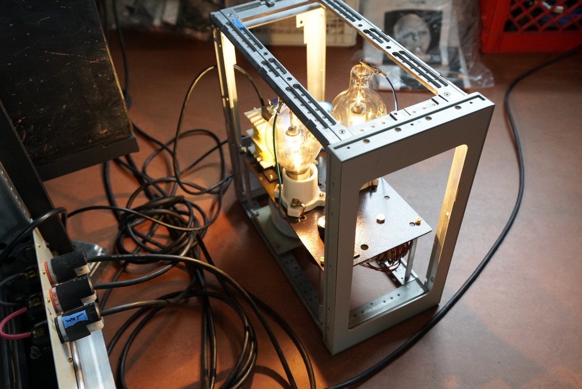

A pair of tungar bulbs will work in a FW CT configuration, but are impractical and ridiculously inefficient. 25A each @ 2.5V for heating power is typical. At 1A they will drop a few volts. I have some limited experience with them for field coil power supplies, but would not recommend them to a newbie.
They are still available new in China of course.. :D
