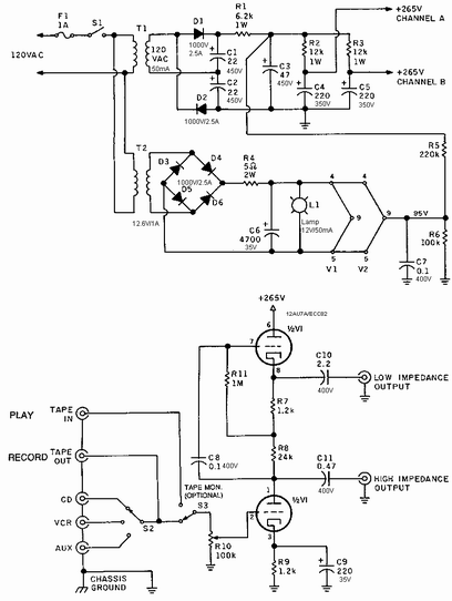

In this schematic by Joe Rasmusssen there are a couple of changes in the chip circuit relative to Kuei's version. I believe, for quick test purposes, that the tube can be implemented in this inverted version proposed by Kuei. In this case we just have to add the tube. But the gain of the tube may overload the chip so some resistor in between may be necessary. Also, I have +/-28V rails, maybe I can get away with it. The only problem is that I have a problem with catode followers
Miguel
Miguel
miguel2 said:But the gain of the tube may overload the chip so some resistor in between may be necessary.
The gain in Joe's tube stage would be just under 1 so no need to pad it down.
dave

miguel2 said:Thanks Dave.
I just noticed a 1n3 cap in the chip input. This is something to worry about? Does the tube input can cause some oscillations in the chip?
Miguel
In short... no... and no.
The end product of this is to shape the HF bandwidth and its value is tunable by ear, so once built do experiment.
It is not unusual for SS designers to put a passive bandpass filter on the input stage, to block possible DC and, to me more importantly, reduce potential slew induced distortion. In this case, I believe you will find the end result a warmer sound.
Joe
