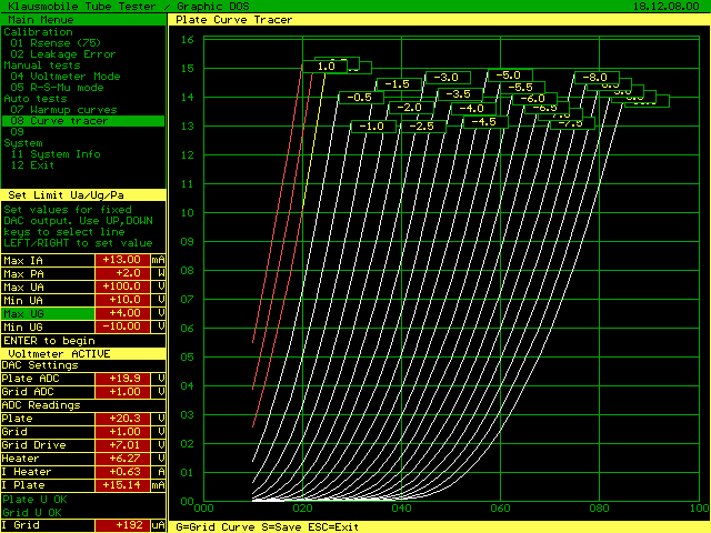

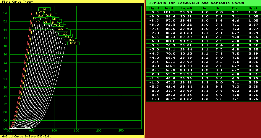

Look at something like a triode connected 6P43P-E, they look like a promising tube triode connected at ~165 volt supply, gain of ~7, Rp of 1k or so with 100 volts on the anode. I might try a build of Salas 6V6 preamp with one to drive a baffle step compensation circuit.
