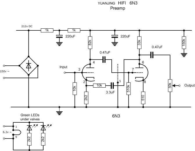

In case anybody is still interested: this appears to be the schematic.
Doesn't look half bad I think.
