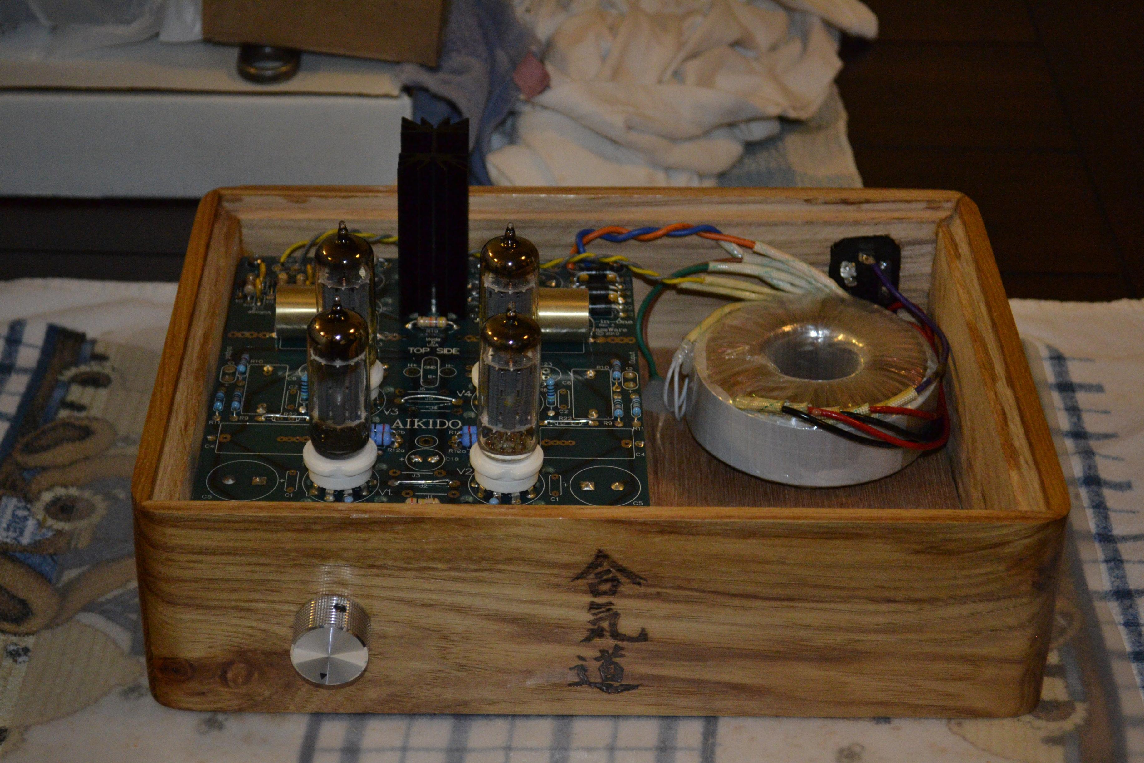

I was in your same spot last year.
I was looking for a tube preamp for my LM4780.
I looked all over on E-Bay and was a bout to pull the trigger on this E-Bay preamp kit.
Then I was pointed over to the Aikido preamp from Glassware and I am really thankful that I found it.
Long story short I love it and wouldn't look back for a second.

the Glassware website is indeed very impressive, and as far as price goes, well, its just about the same price range. problem is - they have such a huge variaty! i dont know which kit would work best.. i want to have the option to choose from a few different sources and even add a phono stage later on.. also, i wanna keep it with as little tubes as possible cause they are some what hard to come by here in israel.

There is a lot of support here on the Glassware products.
Multiple inputs can be done pretty simply by just adding a multiple position switch on the front.
A phono stage can be added pretty simply by using 12 series tubes and getting the Tetra phono stage without P/S.
The Aikido preamp was designed to be able to run a phono stage off of its P/S.
