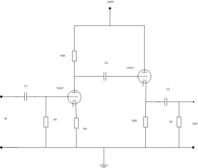

However like your idea to use a low gain 12AX7 stage to get som distortion, so I quickly throw this schematic together. Haven't calculated the value of the capacitors yet, but I guess it should be something like 0,1uF for C1 and C2 and 3-5uF for C3. All 400V. Donät sure if this could work, feels to simple some how. What do you think?
Leave the last 12AX7 half (cathode follower) away and connect the signal directly from C2 to TDA2040. Then the gain will be 13 dB, assuming R1 is changed to 100 kohms. Then C2 should be min. 220nF.
By the way, the schematic you made has such an error that there is no bias arrangement for the cathode follower.
R1 should be 100k, I know. And yeah, I missed a resistor at the schematic. But maybe one stage is enough however. Think I'll build it only with one stage, connecting the TDA2040 to C2 and then I'll see how it sounds.
