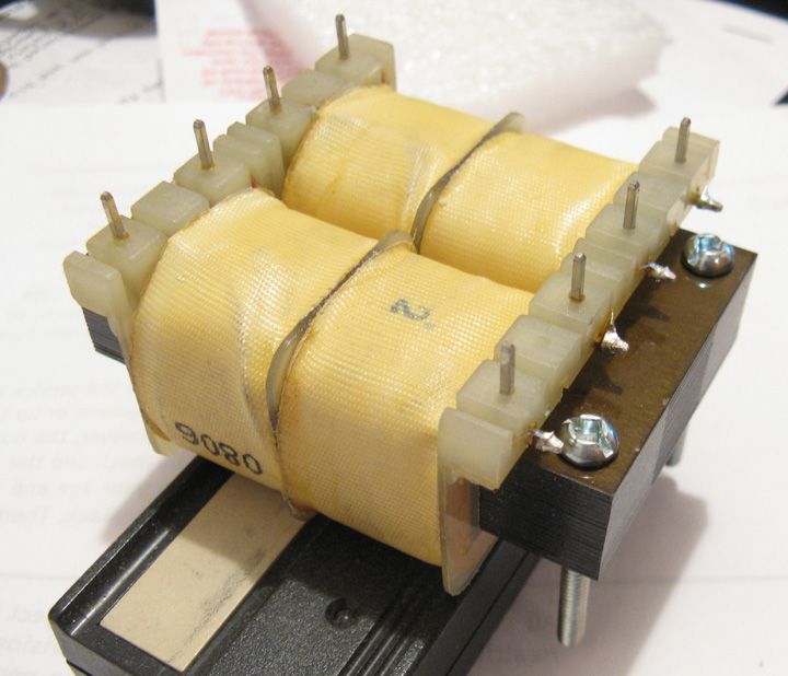

Not your regular transformer. A square toroidal transformer.
Four coils separately wound, each isolated from each other by the plastic bobbin. Transformer is being used at half its VA rating. No appreciable heat rise with amp driven to clipping for an extended period of time. Would not recommend doing the same thing with a regular transformer but this design is about as safe (voltage related) as you can get. Again, don't use it at full rated VA. I hope it is more clear now.
This is a split bobbin flat pack transformer and yes this will be absolutely safe as employed as long as you live within the decreased VA rating. Glad we finally got to the bottom of this, should be just fine.
