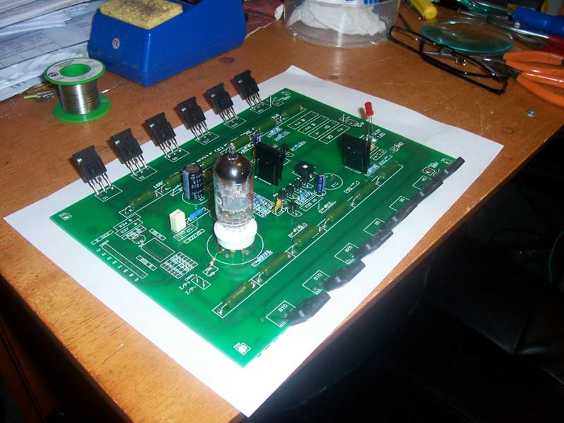

Heres a meaty little power amp.
Tube front end with 1600 watts of mosfet power.

http://www.diyaudio.com/forums/everything-else/183084-pictures-why-not-attach-them.html
Image above fixed.
