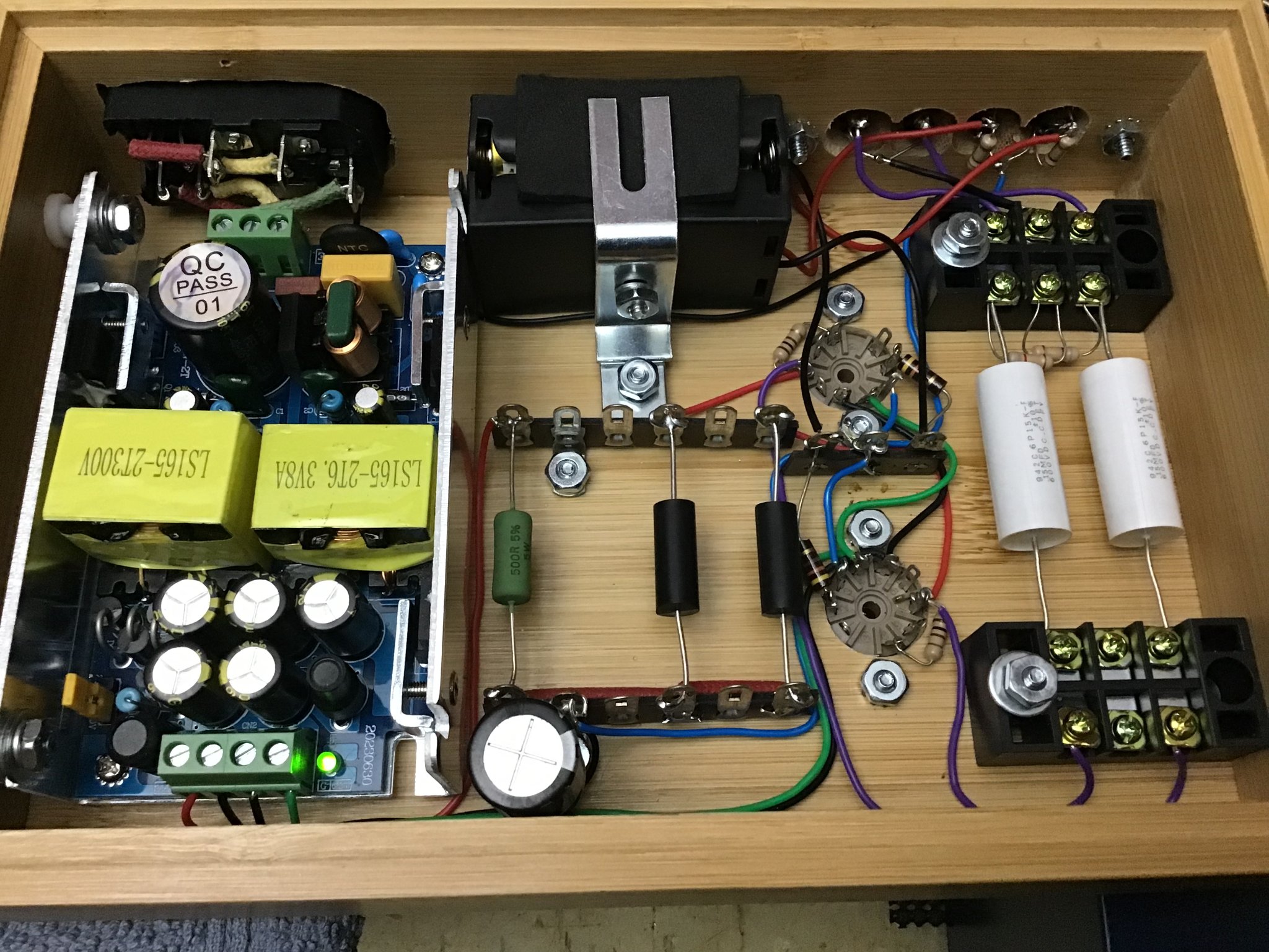

Not a kit but my recent preamp build, the Flow, is as simple as it gets. It could even be built with a screwdriver like a couple of my recent amp projects. Cost was just under $100. It’s a simpler circuit than the amp my then 10-year-old granddaughter built last summer.Hi.

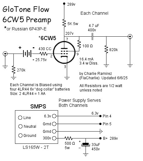

I just posted this updated schematic:

The build I posted above cost just under $100. I use sources that have variable outputs (DACs, streamers) so it would cost a bit more if you have a source with a fixed output and need to add a volume control.Since you're driving solid-state amps you might want to look at something designed for that.
It’s designed specifically to work with SS and Class D amps that have low input impedance. Because the tube has a low plate resistance it has an output impedance that’s under 1k so no cathode follower is needed.
Mu is ~7 or 8. Of course, most amps can be driven to full power with less than a line level signal and don’t need any gain at all. The Russian tubes cost $3 each. American or European 6CW5 / EL86 are only a bit more.
It’s so simple that, even if you can’t read a schematic, you could probably build it from the pic:
