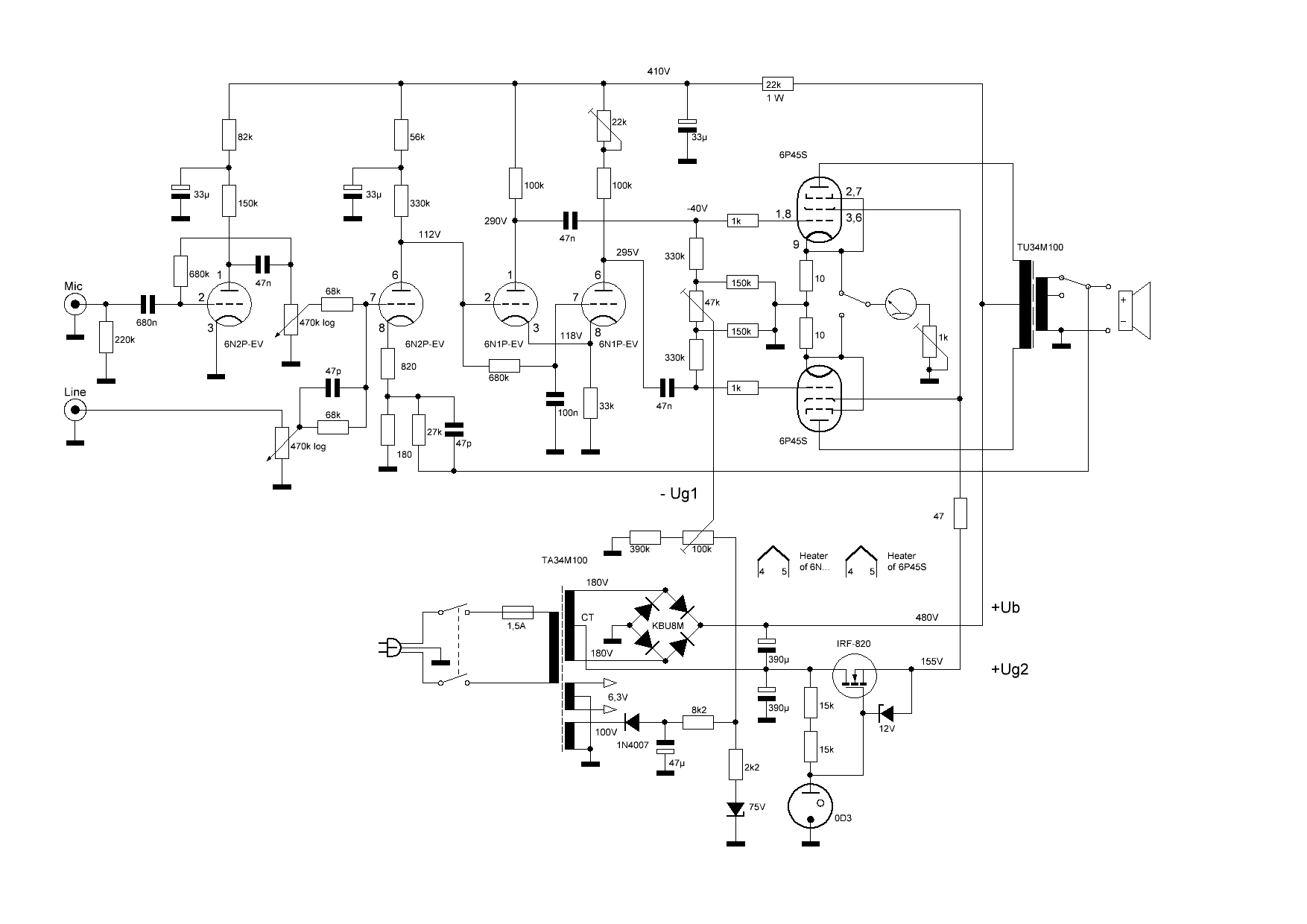

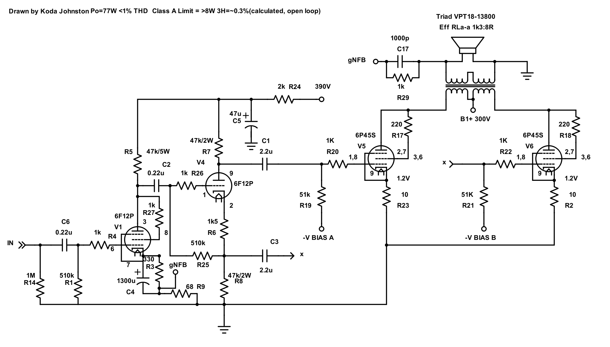

My favourite amplifier I've built uses 6P45S in triode connection for ~80W output. The only issue you might find is finding a 1k3:4R OPT.
Look to horizontal sweep output types, there are a handful of affordable, high quality ex-soviet types (6P45S, like above, being a good one) that would work well, in addition to the usual television types. It's not unusual to see the output up around 100 watts out of a pair if the output iron is up to snuff. Design with parallel output tubes and stay conservative on the idle biasing for long life, and they should be very reliable long-term.

Soviet 6P45S (~PL519) sweep tube is very efficient.

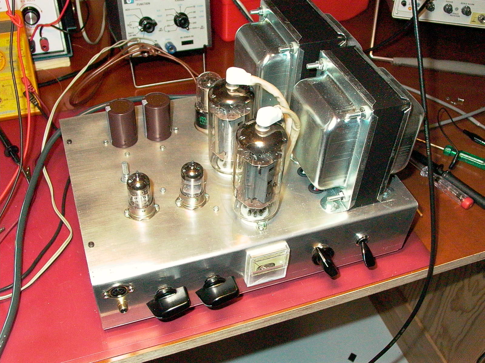

I built this some years ago. It gives clean 170 W out.
