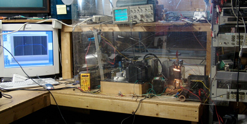

On the real tip, that benchtop amplifier looks scary. I never did anything like that in my tube days. I always prototyped and tested right in the chassis.
That's only part of the picture. The chassis standing on it's end is the power supply from the radio transmitter. The yellow clip lead is carrying the 1500 volt B+. This proto never got beyond this stage. I still have a few tubes, the OPT and a smaller but higher voltage power transformer. I really don't need a Marty McFly style guitar amp, so I'll never build it. The bucket list is longer than I have bucket left, so things are getting voted off that island.
Testing and full scale "annoy the neighbors" mode was done with the Lexan shield in place. Bad things could happen if my guitar touched stuff in that power supply. The rack mount device partially hidden by the guitar neck is an ADA MP-1 MIDI guitar preamp. I set on a preset that I call "Jimi" and blasted away for a while. I found a rhythm that could provoke a resonance in the power supply somewhere between 1 and 2 Hz. If I played at that speed I could get the room lights blinking eventually tripping the 15 amp bench breaker. That was the worse thing that happened during the week that this beast was alive. I even found a frequency response plot. The TV, CRT monitor, and PC date this picture.
