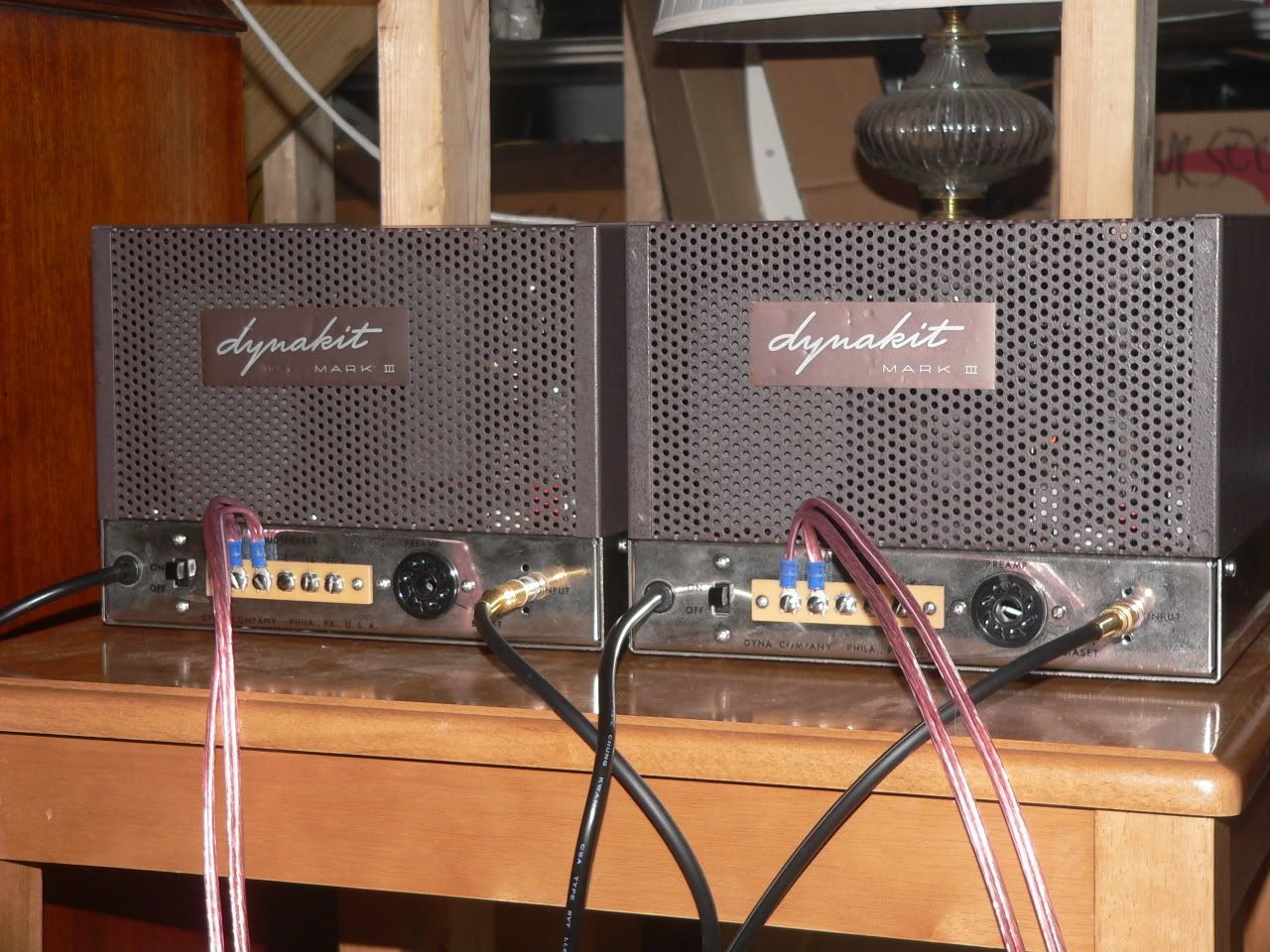

I've got a pair of Mark III. I hope they perform a little better than stock, as I've more or less completely rebuilt them. They've got new driver boards, new cap boards, and new bias supplies in them. I have a friend with some fairly high-end, high powered solid state stuff (Bryston 9B-ST driving a set of Thiel CS2.4). He seems to prefer my Mark III over most of my other amps. On the other hand, I find I generally get more enjoyment out of my low powered single ended amps. I've got a 6B4G amp that's only good for about 3 watts, and a Tubelab Simple SE that might make 4 or 5. You wanna buy a pair of Mark III? 😉

http://i69.photobucket.com/albums/i43/Ty_Bower/Mark III/P1100876.jpg
http://i69.photobucket.com/albums/i43/Ty_Bower/Mark III/P1100717.jpg
