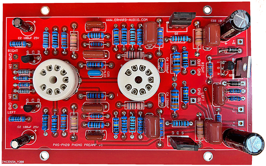

It would not be hard at all for me to remove R13 and C4, and place a 1uF cap to connect the traces appropriately as a test. I have a really nice Hakko desoldering gun so I can just as easily and cleanly put R13 and C4 back if it doesn't work.
No test or hacking on the pcb is needed, and the math is straightforward. See post #12.
Your use of that calculator is not appropriate for this circuit topology.
Also, C2 in one place is not the same as C2 in a different place.
C2 just a label, not a function. Don't worry about it, just follow post #12.

So did the recommended changes help?
They are for only the stated line stage and audio cable loading.
To recap:
R13 should be a wire jumper.
C4 should be 1000 pF 2% @ 250V or better, polystyrene or polypropylene.
Make certain that it will fit the pcb properly, with short leads.
Don't change anything else.

The RIAA eq could have been realized in a more controlled way by placing C4 (correct value) parallel with the R8-C6 combo. I predict around 3.3 to 4.7 nF, can be exactly calculated. This way the eq will be independent from the cable capacitance and the input impedance of the line stage.
I am happy to report that the proposed changes in Post #12 were successful :)

yes it has, it is quite an improved circuit with part value changes in critical areas, ie RIAA etc. and of course the addition of the MOSFET output buffer.
You can see the MOSFET's, black TO-3, on the right of the revised pcb
