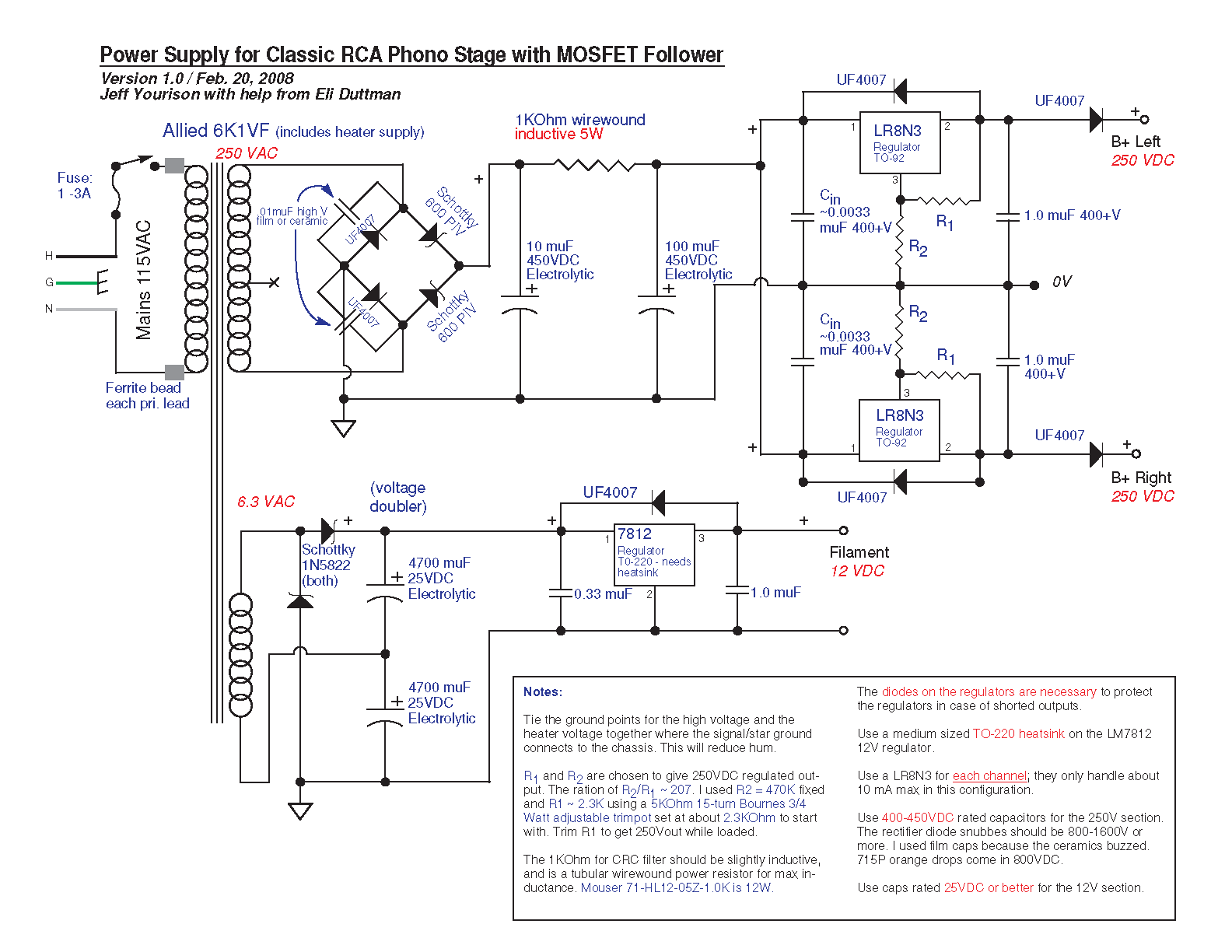

Here is the tweaked RCA Classic phonostage that Eli, Buzz and others have worked on. The power supply will follow if you're interested. (I thought Merlin had just posted it, but it's gone at the moment.)The range in values shown is intended to keep a key RC product constant.

The original thread was spread over several forums, one of which was lost to hacking. 😱

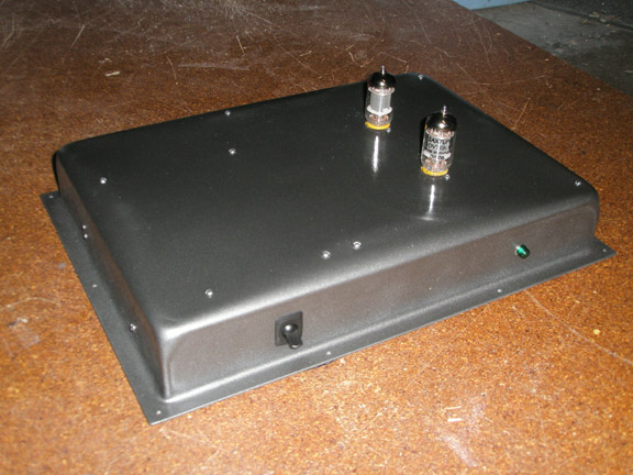

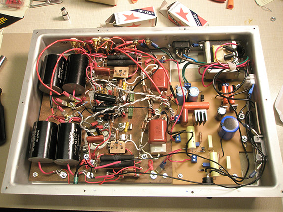

There are a few builders out there. Here is my original quick prototype build. It could be done more compactly in a nicer enclosure; this is mostly point to point, and is set up to allow changing out the capacitors for experimenting. (The enclosure is a Fat Daddy-o 9" x 13", 2" deep cake pan, inverted.)
I like the new Mullard reissues, the Sovtek LPSs, and some older RCA mil-spec tubes in it.
The power supply is on the right, and the actual preamp channels are on the left. The heat sink is for the 12V heater regulator; it gets only mildly warm. I used a mix of 'styrene and mica in the equalization section, and the output caps are GE surplus with Panasonic film and foil bypass. The large black decoupling caps are Solen.
Thanks for the information. I have a copy of an RCA tube manual from 1959 that seems to have that same circuit (#19-15, on p. 364), though of course without the MOSFET follower.
I take it you like the performance of the RCA phono pre? Any idea what the frequency response, total gain, and RIAA accuracy are?
The tweaks to the RCA original correct 2 weaknesses: very poor drive capability and mediocre bass extension. The FET buffer disposes of the drive issue and grid leak biasing the 2nd gain block lightly loads the EQ network, for better deep bass behavior.
If you run the numbers provided by RCA, you will find gain of about 45 dB., which seems to be pretty darned good. You want the phono preamp to produce roughly the same signal strength as a "standard" CDP (2 VRMS).
I am unsure of precise gain, but I don't have to make any volume matching adjustments when switching the source from CD to phono. My guess is that it's close to typical CD level output with my MM Shure M97xe cartridge. The follower reduces output impedance, allowing it to work with 10K input impedances (most amps?).
People say the RIAA accuracy is pretty good -- the schematic was tweaked some (before I did non-critical tweaks) by a couple of people who got it pretty close to the curve.
