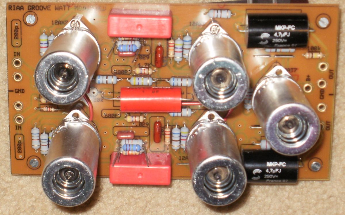

Don't for get the groovewatt RIAA, very similar to the WAD, a couple of 12AX7 SRPP stages with the RIAA comp between them. Then a 12AT7 follower output. I'm currently fabbing one to try it out, design looks solid, but I added the 50k cutting head 3.18us comp components. Heaters need a raised 12 V due to the SRPP design, I decided on about 70V based on the B+ that I'l have available.

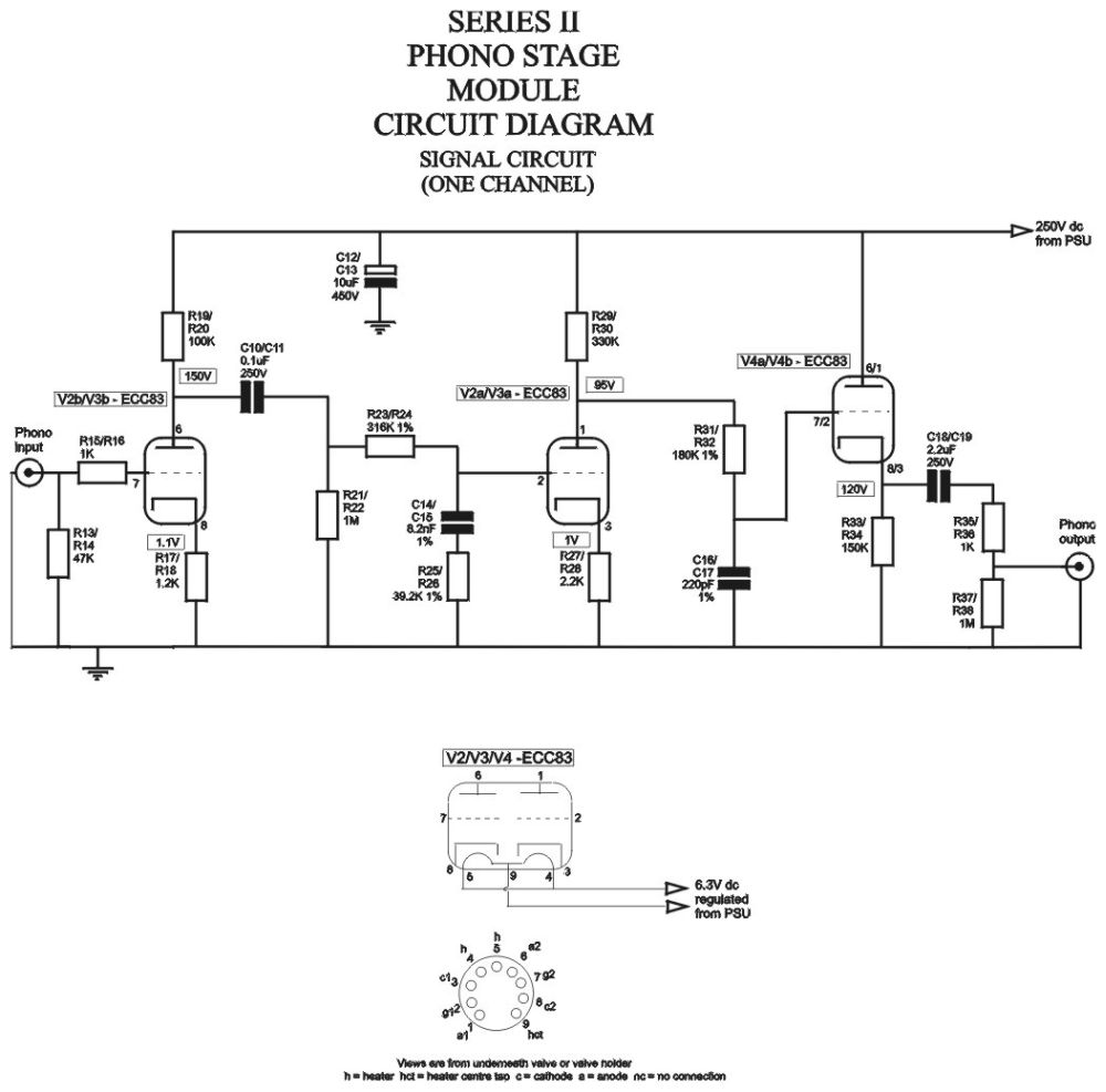

Planning to design a low cost tube phono preamplifier. After searching on the web I realized a phono preamplifier should have the following features:
1. High gain. Normally 40 to 45dB
2. A RIAA circuit is necessary
3. High input impedance is needed for piezeo phono head
4. Low input impedance is needed for magnetic phono head
I found a very simple circuit designed by 7025 (12ax7), attached below. Is ther anybody had tried this circuit? How about the performance?
THe output impedance is 220kOhm, maybe too high for some power amplifiers. I think a cathod follower should be added.
What changes should by made to the schematic instead of Tube/Valve 12AX7 to PCC88 use?
thanks you!

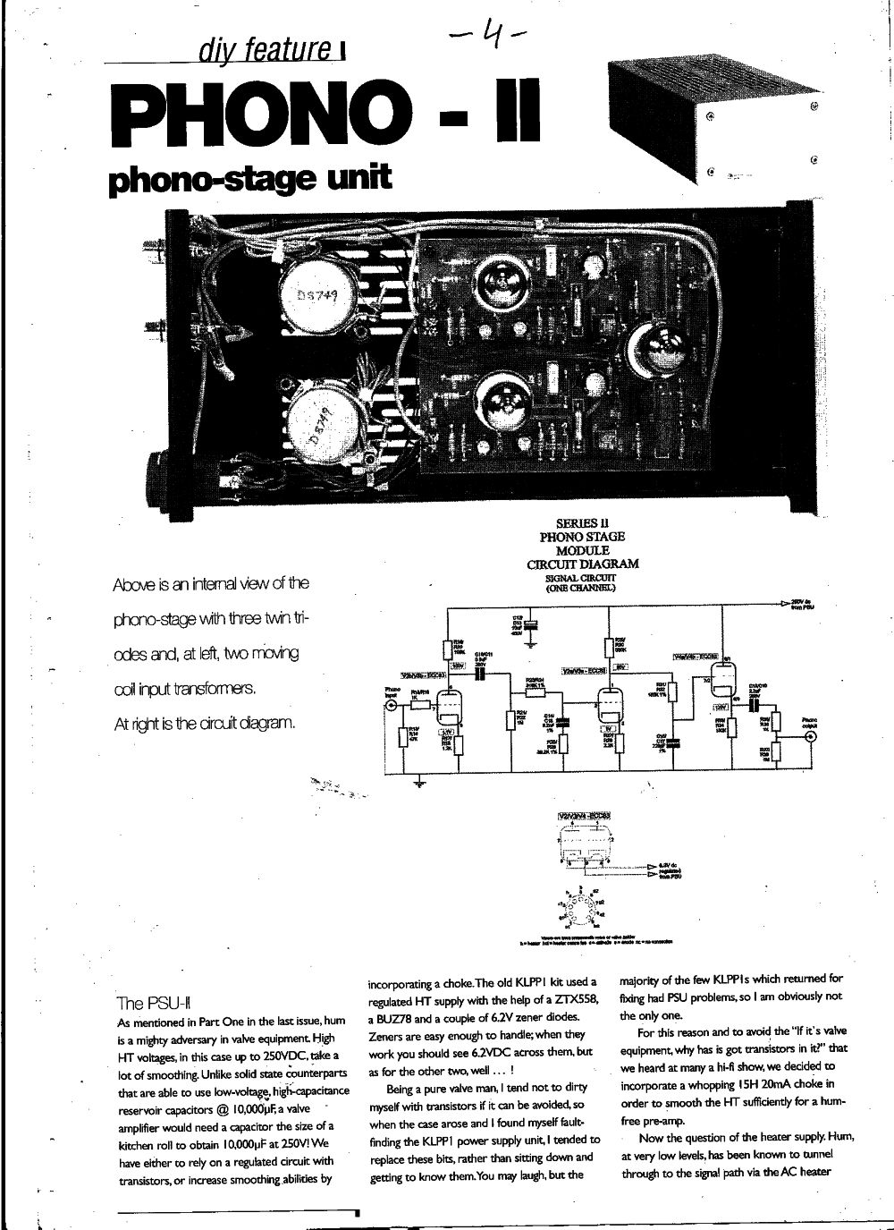

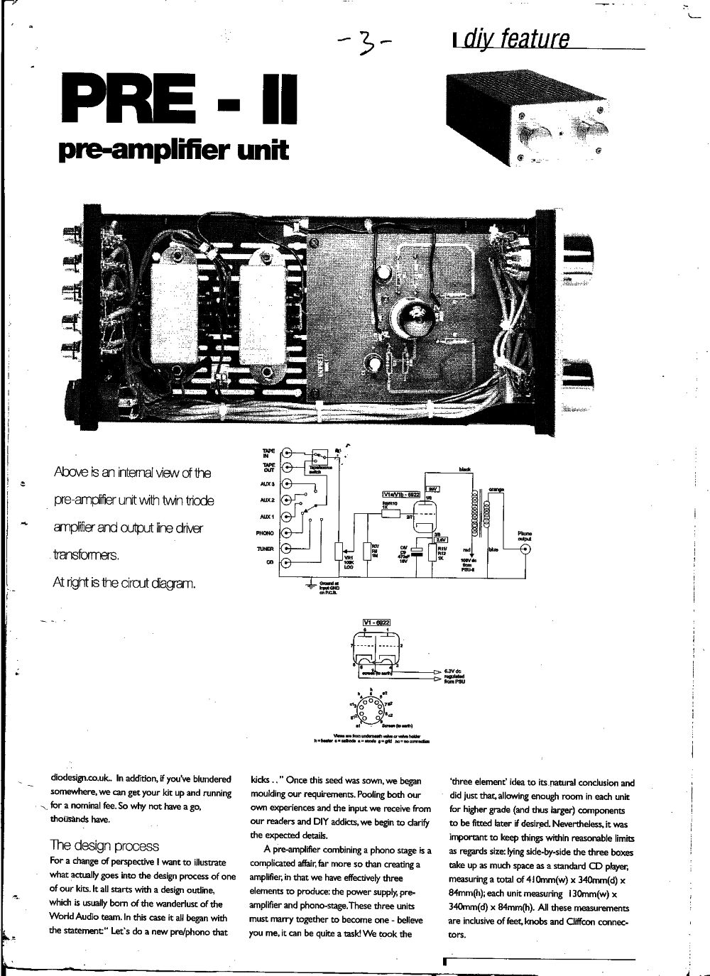

WAD RIAA
Hi, I scanned all records of WAD. It was a supplement in the British journal Hi-Fi World - November 2000. Formula 22, PCC88 - I think that is the worst tube for audio ... Greetings Dinkers
