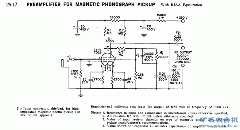

Planning to design a low cost tube phono preamplifier. After searching on the web I realized a phono preamplifier should have the following features:
1. High gain. Normally 40 to 45dB
2. A RIAA circuit is necessary
3. High input impedance is needed for piezeo phono head
4. Low input impedance is needed for magnetic phono head
I found a very simple circuit designed by 7025 (12ax7), attached below. Is ther anybody had tried this circuit? How about the performance?
THe output impedance is 220kOhm, maybe too high for some power amplifiers. I think a cathod follower should be added.

This circuit has been discussed here numerous times.

Thanks Cassiel. I will breadboard this circuit. I'm also thinking about Maranz-7 design. It has a cathod follower as output stage. I think a potentiometer is also necessary. But where to put it? before or after the follower?

It would be nice to have one with good RIAA conformance, low distortion, low input capacitance, high overload margins, and fast recovery from overload. If I were you, I'd spend a few days going through the preamp chapter in Morgan Jones's "Valve Amplifiers."
Morgan Jones said:When we investigated power amplifiers, we looked at some classic designs to see how the goals were achieved. There were no classic RIAA stages, they varied from mediocre to plain awful.

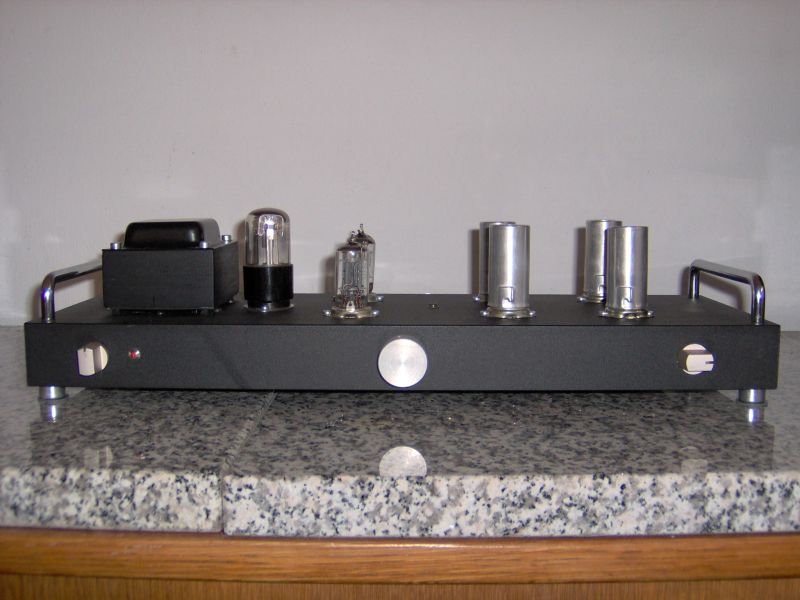

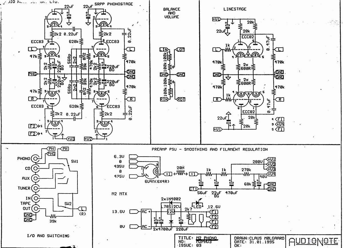

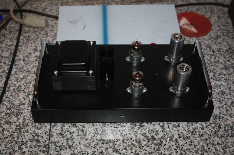

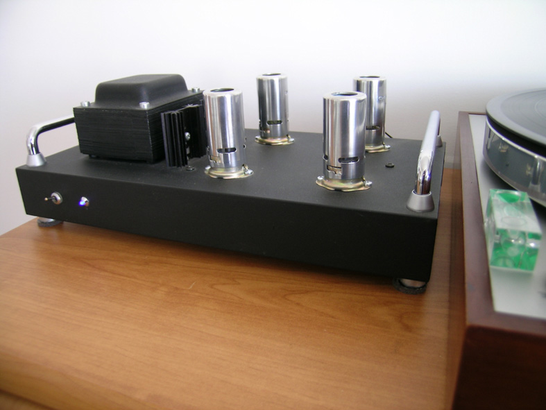

I want to point out that a lot of working on a good pre RIAA, because I listen almost exclusively to LPS. I tried to do a replica of the layout of the SRPP Audio Note and other systems. WAD is the best! Below is a photo posted M2 Phono and my version of WAD. Regards Dinkers

This schematic looks quite different than the miniature one!
pre RIAA WAD

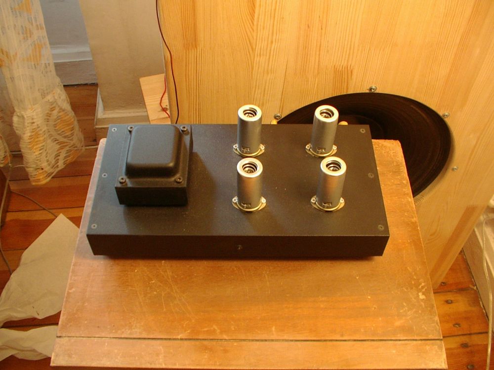

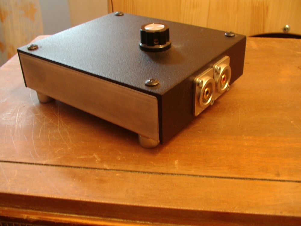

Yes, a miniature diagram - this is WAD / World Audio Design /. Schematic SRPP / M2 Phono / is a system of original Audio Note. Do not have a scanner and I can now embed individual pages WAD. I think this is one of the best projects in general and RIAA phono preamp. Complemented by a step-up transformers can work with MC cartridges. In the picture my version of WAD with step-up
