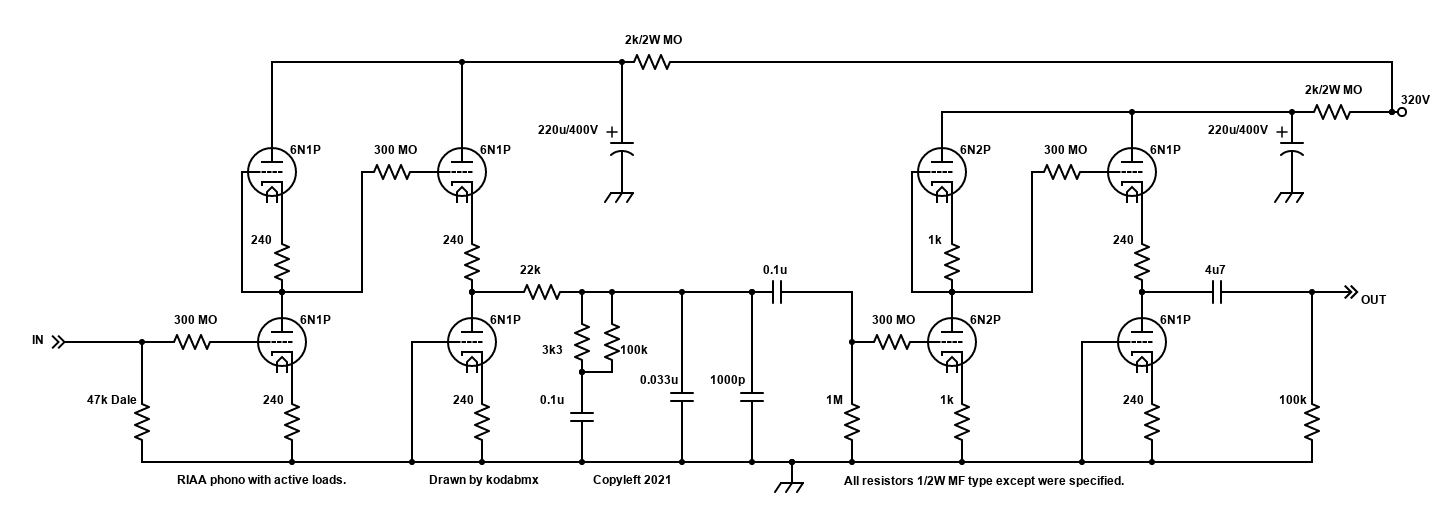

The kit/complete price includes tubes. Pin 9 is grounded so in theory, if you feed 6V to both sides of the 12V port, you could run 6V from pins 4,5 to grounded pin 9. 12AU7 would replace 6N1, 12AX7 replaces 6N2. No other modifications would be necessary.
If you replace the 1M with a 1M pot, you'll vary the loading on the RIAA filter when you change the volume control. Also, a 12AX7 would give far too much gain for a preamp - You'd get about 40V out for 1V in.
However, if you wanted to, you could switch from phono at the 1M for a line input, and attenuate it with resistors, Then you could put a pot on the output of the board for volume - say 10k or so.
I also make a line/HP amp version of the board with 4 tubes instead of 8. There a link to the thread here: 6N3/6N6 headphone amp using PCB.

It's similar to the Aikido by Broskie but without the Aikido PSU nulling. Most people like it.
I have mine set up so it only lights up when I play records, and I expect the 8 tubes to last for years. The preamp runs 24/7 and I've only had to change the 6N6P tubes (because I run them @140V/30mA) once - they were still ok for line but wouldn't drive current into headphones anymore.
