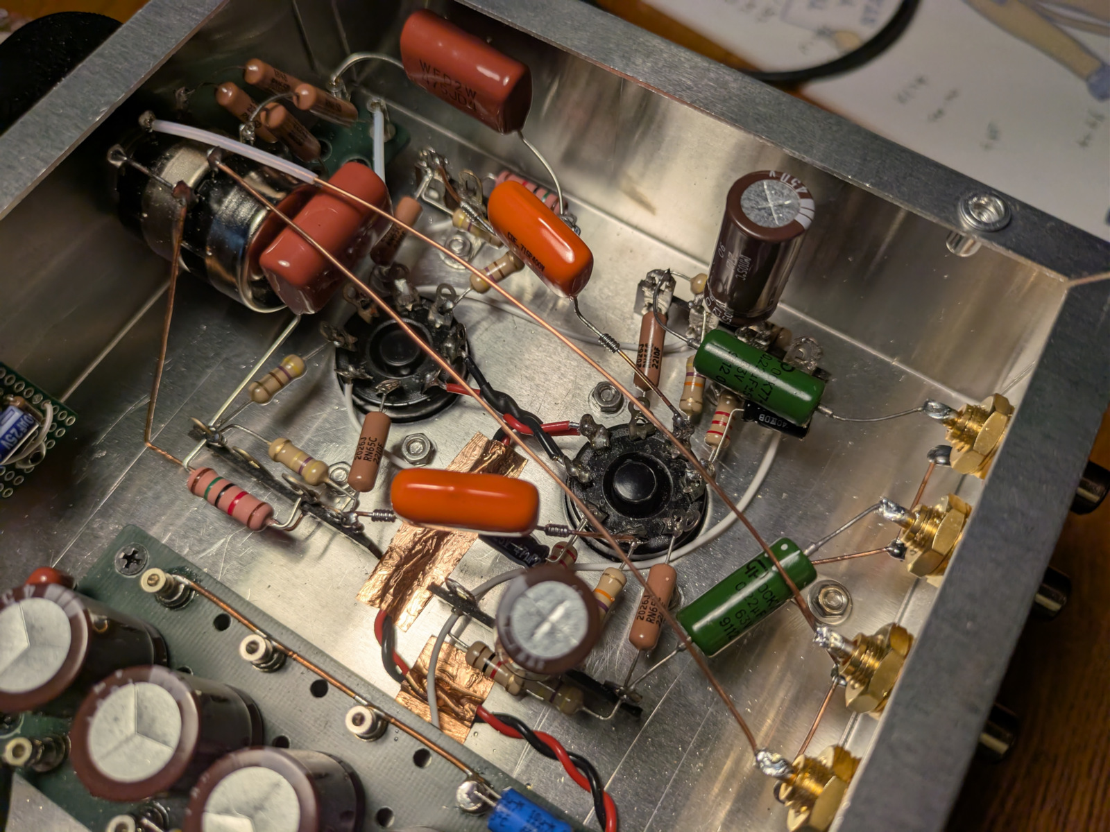

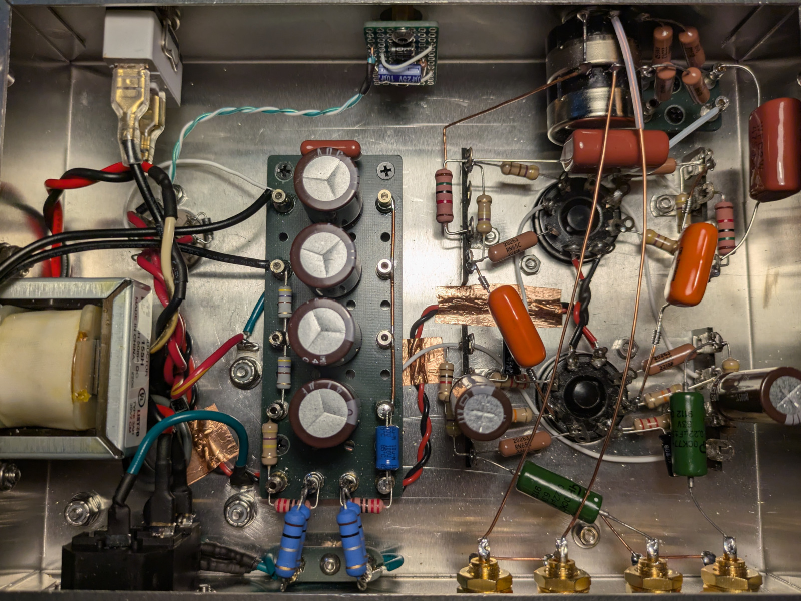

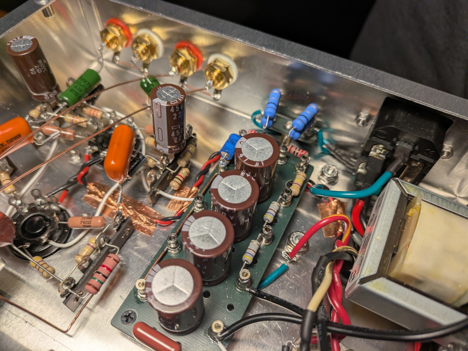

So volume attenuation at the input defeats the purpose as the smaller signal at the grid induces a smaller voltage swing, and thus, less distortion. Thanks everyone for your help!
1.6% THD, almost all second order. Super quiet, no buzz or hum.
