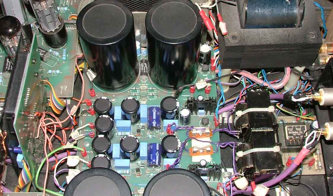

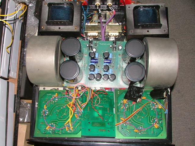

This is Tube Technology tube amplifier monster...it failed does anyone have a schematic or know a link to get one?:smash:

Its a dual channel in a single chassis amplifier. 3 pairs of parallel P-P EL-34 with output of 200W. Toroidal power transformer which was burnt together killed the separate drivers circuitry power supply. Its only on one of the channel. I made the rewind of all the power transformers and it works, but, with high hum, but the other channel dead quiet. I think the cause was the bias meter on the front was misleading making the setting too high that set off the imbalance of the power tubes which had several resistor burnt also replaced. But the hums no way to get rid of...
and also the middle bias control board is made with IC control which I think is malfunctioning because the actual measured current and the shown one is different, although the pots are still able to control. Thanks your help...
Just guessing but it could be a calibrating resistor or a protective diode that fried....Or both....
Hmmm...IC controlled bias, he?
And they call themselves Tube Technology, right?
Tssssssskkkk....:smash:
Cheers, 😉
Thanks Dave. Wl pay more attention to it to see if it can solve the problem.
The bias meter circuitry is digital just to show the readings and does not control, but, it went wrong already so the actual current and the digital reading deviates more than 40%:bigeyes: and that was the reason, I presume, made it blown. And now no way to repair that digital circuitry without a schematic and reference values....

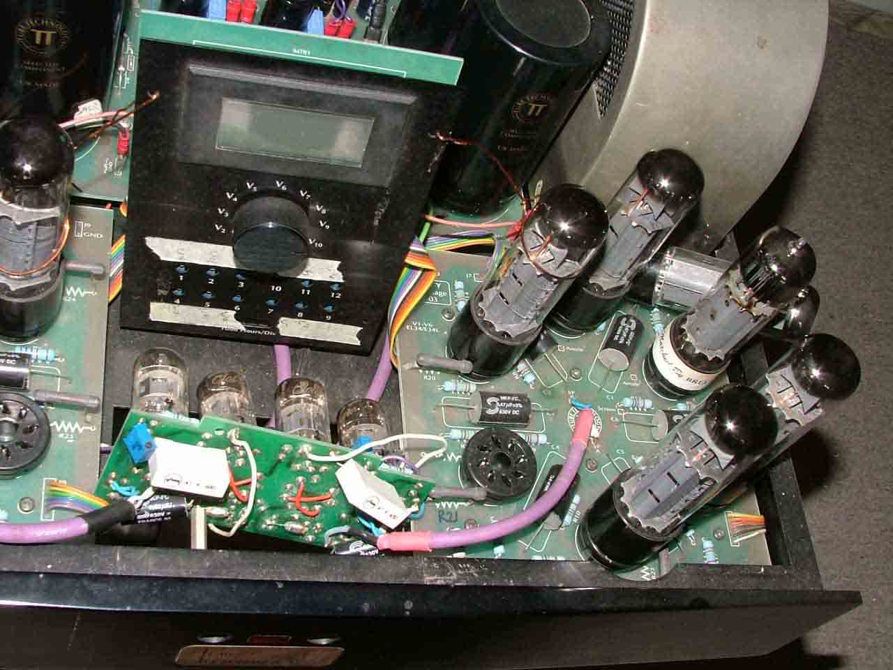

I discovered a plate at the back said its 150W output power. I attach one more picture showing the PS board. The driver tubes are 12AT7A, input in parallel as voltage amplifier and the second tube plate load driving the output tubes, sort of williamson type I suppose...

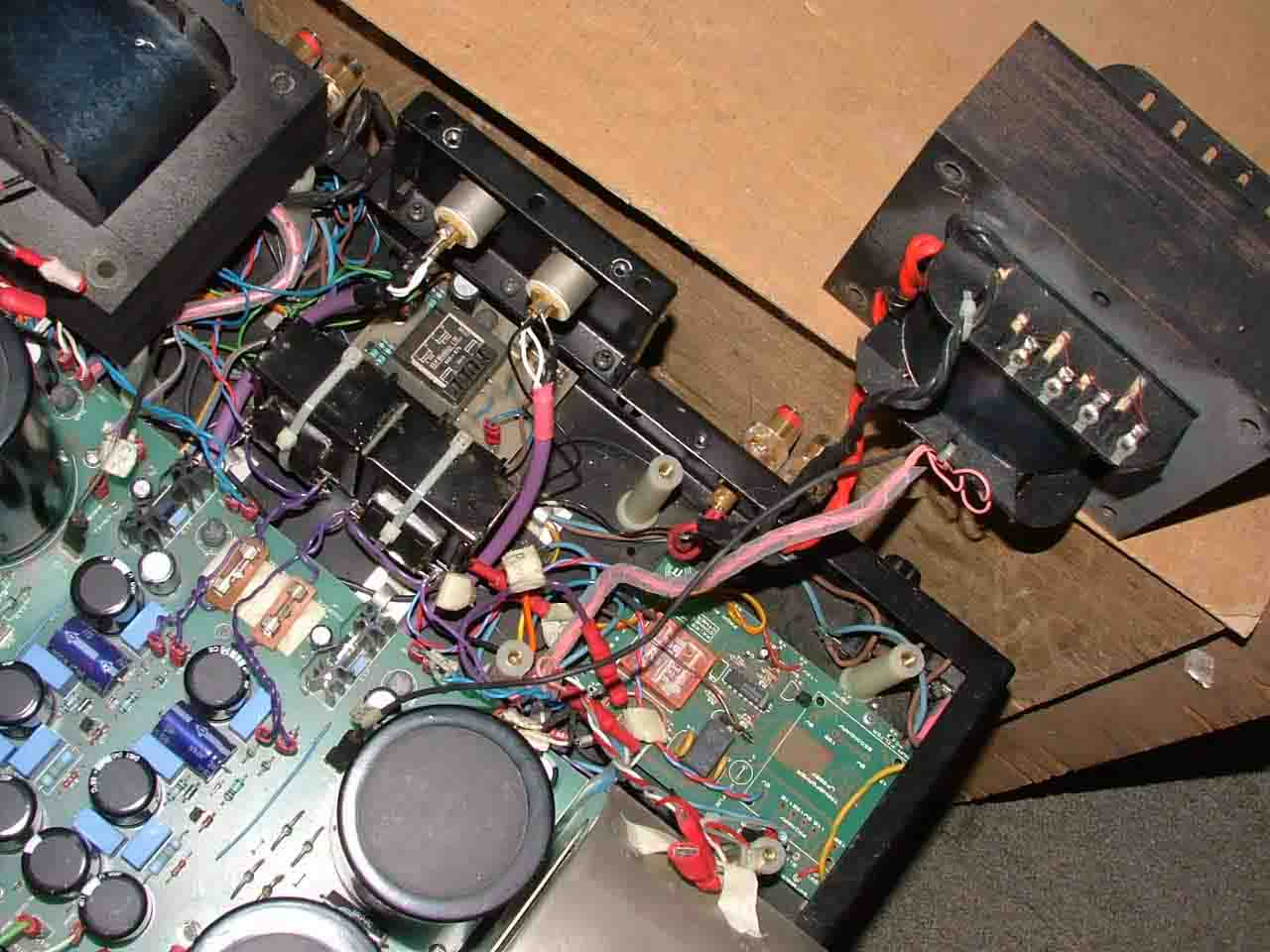

More TT tube monster amplifier
I attach another picture to see the driver psu and there is a small transistor that I don't know its purpose... may this one failed and let out the hum?😕

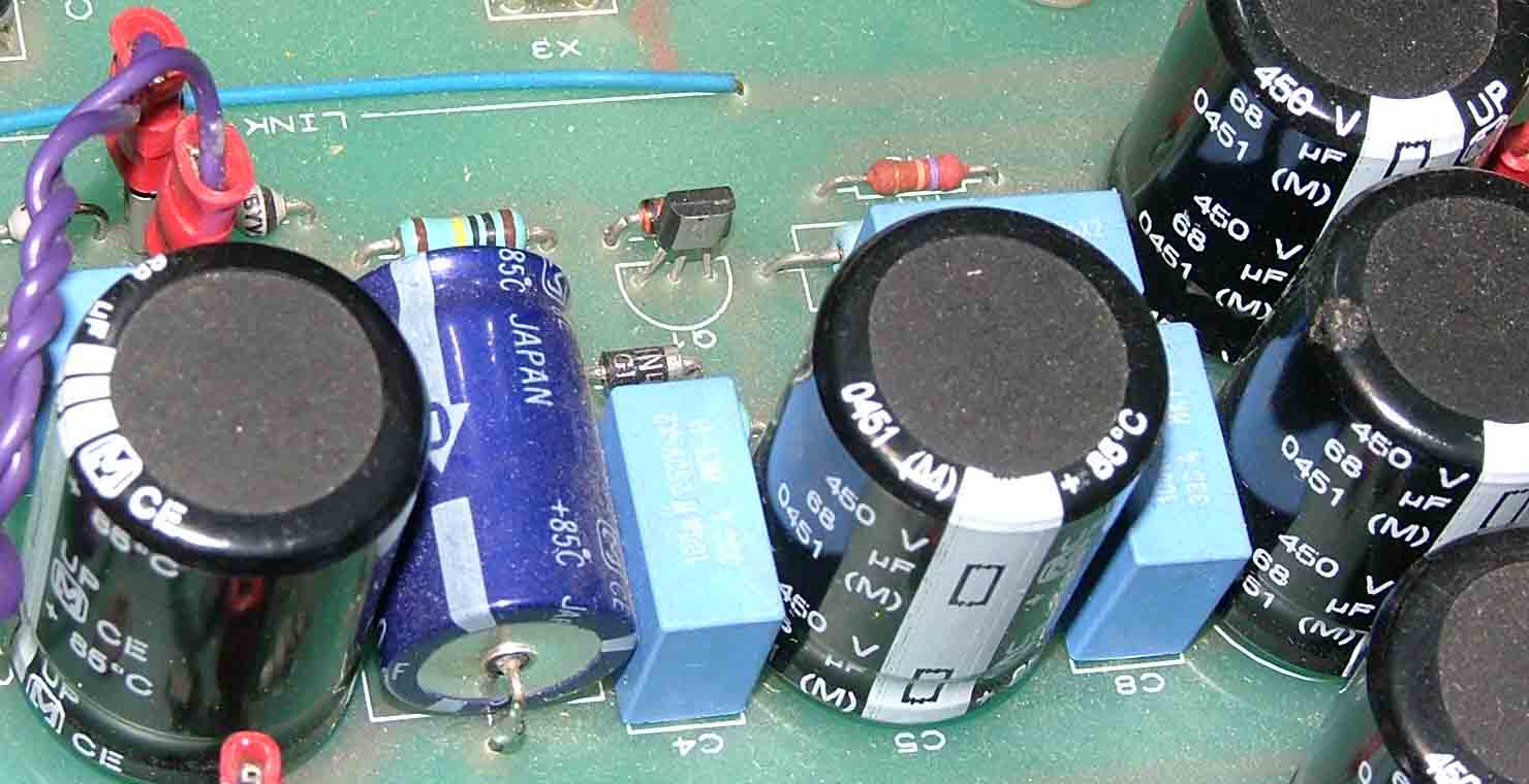

I'm posting one more photo of the power supply board and wonder the little Q1 transistor in it, what its purpose? I think it cannot handle the current the driver tubes require which are 2 12AT7A... can somebody help?
That blue electrolytic ton the left of the eline transis......what is it's voltage/cap value ?
That eline tranny could be part of the neg bias (simple pass smoothing)....The pnp often were silvered on one side but..I'm only suspecting.
richj
The Q1 transistor is in the driver supply circuit, left side is the AC supply to a bridge rectifier then passing the the Q1 and a network of voltage division and out to the right side thru the big caps. The Q1 has on one side a silver plate...but no reference in it to check with...The blue ecap is 10mf450V.
The negative power tubes bias supply is in a separate circuit.
