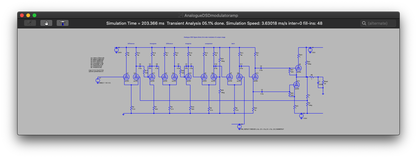

I went through this with a pen and paper last night whilst watching TV with the wife.
Kay - you're correct that the connection is connected to the wrong phase.
There's a bigger problem with the original paper op-amp 'comparator' configuration.
There are four comparators:
* top left - gives a single ended waveform by difference
* top right simply outputs the difference between the triangle minus the wave form.
* bottom left is a schmitt trigger - so that the when the voltage rises above the threshold (in this case ground) it drives a square rail-to-rail transition. When the voltage drops below it switches to the other rail. The 'verr' biasing means that point of switching can be adjusted to prevent switching due to noise. It depends on your comparator capability (ie if it works bi-polar)..
* bottom right is simply comparing the square wave and the triangle.
The problem is that the upper never sees a square wave. So the wave form coming out isn't correct (actually, correct is probably too strong, it's not a clean square wave).
Essentially they're doing what have been working towards.
a) a comparator of triangle wave gives when the wave is under/over the analogue level. This provides a window of time "on" at 250kHz. However this will give a product of the two during that on time not a clean square wave.
b) the Schmitt trigger is used make that a full square wave switch.
Their paper comparators work in both +v and -v hence a tube would have to be operating in class A to present the same capability with 1/2 the maximum rail - note switching is far less concerned with linearity of the tube curve - but the comparisons that are not binary would be impacted by the tube linearity in class A. If we switch to class B then we have a switching zero crossover distortion problem. However I suspect the configuration could be biased to operate AB and use the schmitt trigger biasing to simply 'gate' the square wave before the tube enters the lower murk of linearity that exists at the bottom of every tube load graph.
So TL;DR is that it's possible, the paper has a mistake in that it doesn't square switch the Sn waveform, it's possible and even improve linearity in the tube but the tube implementation needs a little more TLC given a tube pair comparator is not an ideal comparator (as per the crown paper).

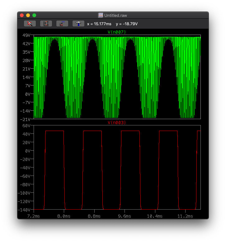

This was the output from the corrected phase:
So you can see the missing square wave function - however if the attachment is a quadrature (ie quadrant) based switching then that may explain it. I've not tried an output stage with quadrant switching.
For simple PP - that isn't going to sound very nice..

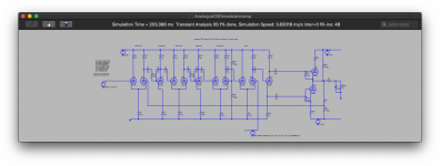

This is basically the concept of having a comparator on each phase (minus rail-to-rail caused by the schmitt trigger). I have a pen and paper drawing of that.
Still lots of work needing. The waveform output isn't too pretty (need the right LPF) - this is where I suspect going R-R square wave will solve some of issues in the FFT (by shifting the noise).
Started looking at creating a DSD output stage - the final stage would then combine the switching of the SMPS power.
I still have work on this but this would allow (a) analogue input, (b) DSD input via an source switch. The output would then (not at he moment) essentially switch the 390V DC link. Currently a direct connection out this would then perhaps change to a output transformer (switching) before the LPF.
