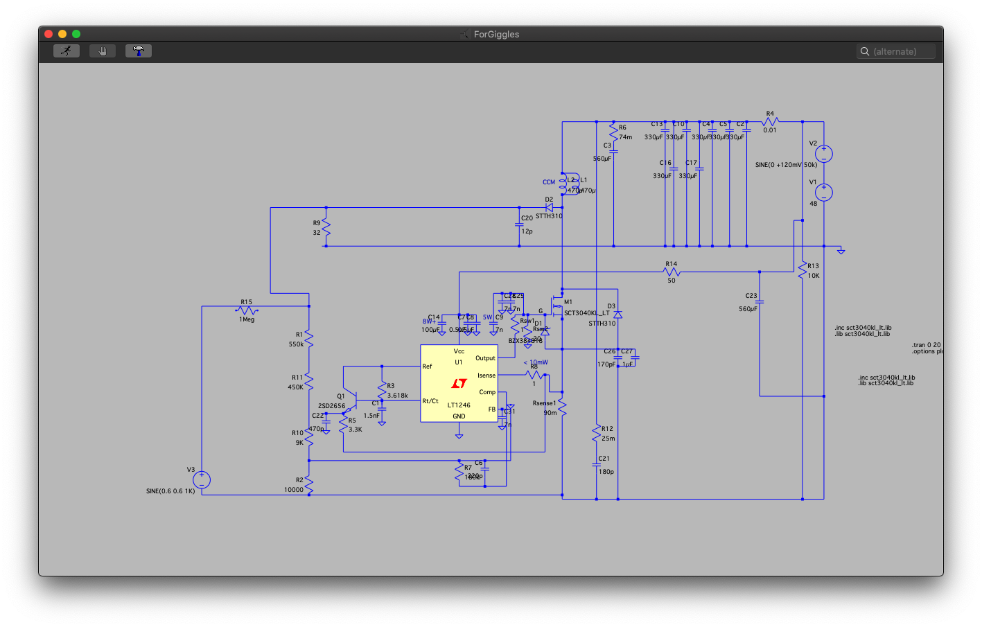

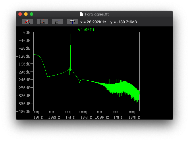

So it is possible to modulate your SMPS directly using the voltage feedback loop 😀 This is with a simple voltage source - next is to sim with a full valve front end.
The above has a high switching frequency (300kHz) but it's certainly possible. Obviously this needs addition work for safety and for providing a wave centred around 0 (a cap could do that short term). The controller has a natural maximum current limit in the current-sensor resistor but should have some safety devices.
I'm using my isolated 48V SMPS boost controller but the same could be done with a buck converter, flyback, full/half bridge or any SMPS configuration.
This is essentially a hybrid- the back end signal does go through the PWM controller and the resulting mosfet switching is then altered to recreate the signal.
Oh and it works with 1.2V output just as well..

As I said - there's a safety element that needs a think through. One option would be to simply hard set the voltage and impose the signal onto it. The important point is that the feedback is the mechanism the the IC sees the voltage so this needs to override the superimposed output. It works without having the feedback and vout directly connected but then it's simply assuming the correct output.
Possibly I'll get stoned for using the term 'modulated' loosely 🙂 You could use a magnetic amp to replace the mosfet and then run the control switching through a valve.. however I think that's going too far.

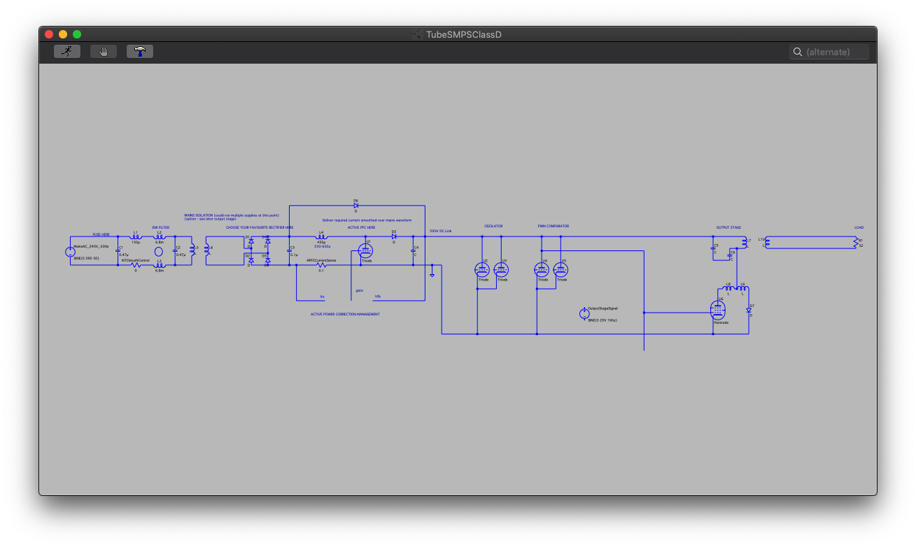

In progress...
Something like this?
It a number of options - either an IT up front could run multiple supplies/channels, or simply have one APFC and then run all the supplies/channels off the same 390V DC Link.
Option there is to put a maida style regulator in there for very smooth 390V..
Not finished.. but the idea.. Issue I can see is that a SS diode on the output will start conducting very quickly.. so you'll have a large inrush through the OT..

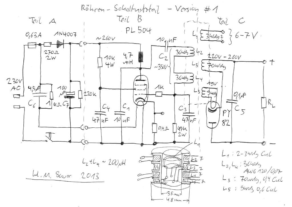

i saved the page as pdf file, thanks, will try to digest it and go on to build my own, can you share details of the 4.7mh plate choke and the output traffo? and what is the operating frequency? do you have suggestions to provide feedback control from secondary to primary?

my idea is adaptation of ss circuits replacing the Mosfets with power tubes, driving tubes would be easier since the electrode capacitances are much lower with power tubes...
