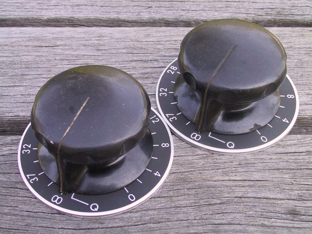

Cool looking board. I like the big knobs. 🙂
They were known in the trade as Daven knobs, and sometimes as RCA knobs. I have a few stashed away in a box somewhere. They also came in a smaller size. Les Paul used them on his console.
Back in the seventies I was invited, along with a friend, to his home in Mahwah New Jersey to look at some Bruel & Kjaer equipment he was selling. We got the cooks tour while we were there, and I stood right in front of that console with the Ampex 8 track recorder just off to the right. There were Langevin tube preamps in the belly of it. Radio Electronics did a cover story of Paul and that console. And he showed me a large framed copy of that cover picture in his trophy room with all his gold records hung on the wall.
