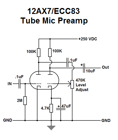

Hi there, I'm interested in making a microphone tube preamp that also has a built in limiter/compressor so there's little difference between loud and quiet sounds. Designing and making a tube preamp that can drive a relatively low-impedance input such as a computer's line-in is easy enough, I can pretty much do that in my sleep.
Trouble is I want to add a compressor to the preamp, but the only schematics I can find either require a LOT of tubes or have a very high output impedance meaning that I cannot connect it to most of the stuff I have.
I tried one schematic for a compressor (the one that's on the very left), but again this is one of the ones that has a ridiculously high output impedance and I couldn't get it to work anyway, I thought I could connect it to the output of my preamp but like I said it was a no-go. Also I've attached a schematic of my preamp.

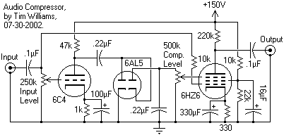

Another compressor I found uses a pentode with what appears to have the third grid "modulated" to adjust the gain. What about that? Would that work?
So can anyone direct me to a schematic that can amplify a microphone, uses standard tubes that most tube nuts like my self would have (such as the ECC83/12AX7), has a built in limiter and has a reasonably low-impedance output (100k or less)?
any help on that would be appreciated.

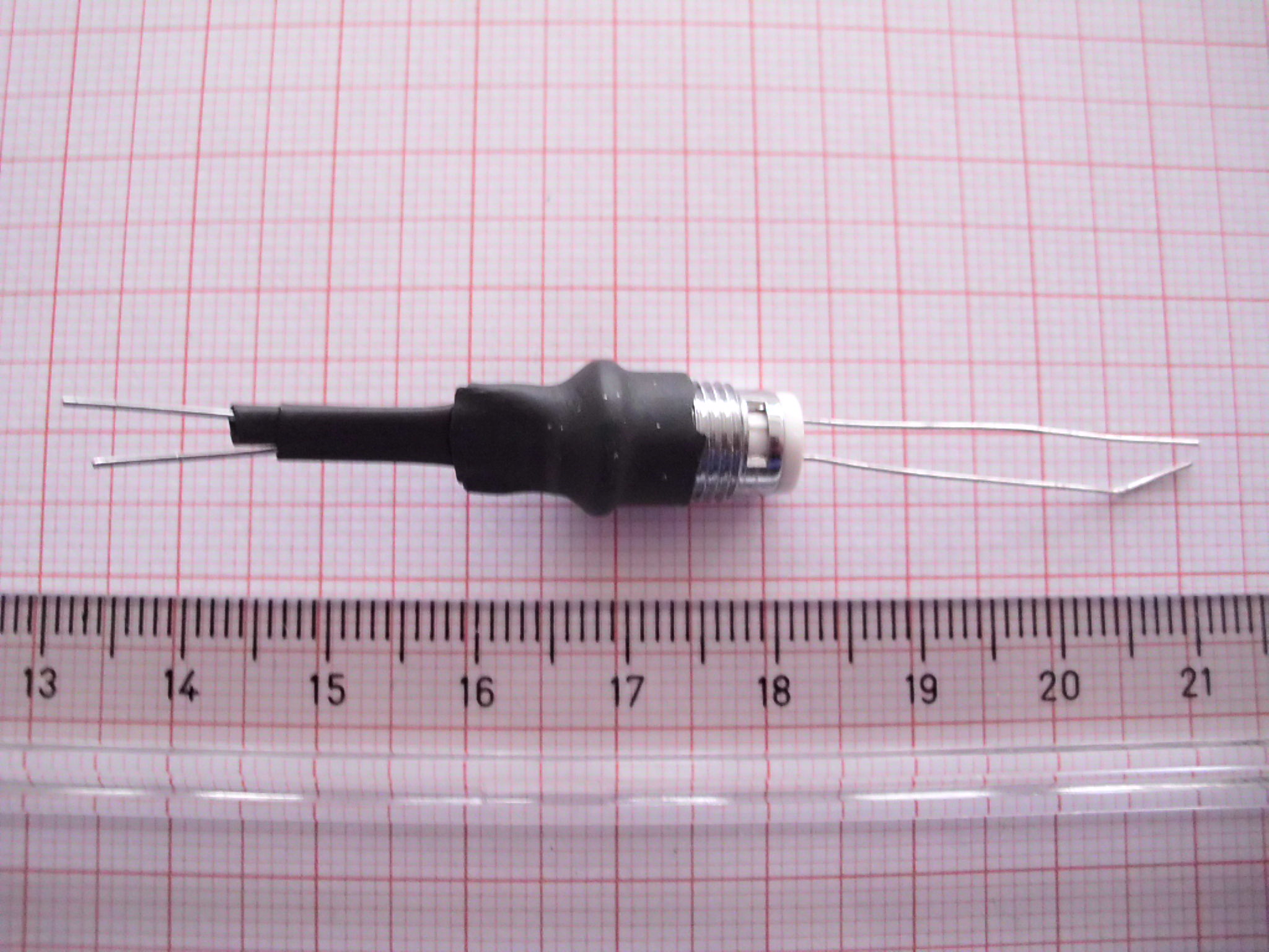

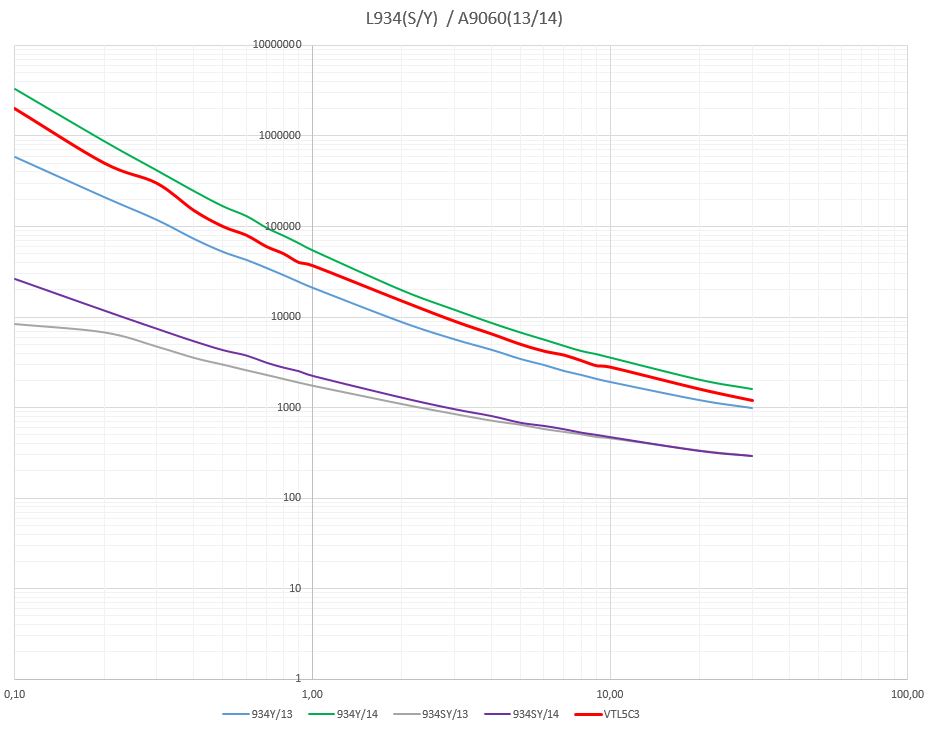

Dear folks,
I found some time to measure a set of 3mm yellow LED´s with two different types of LDR. Attached you can find a small graph which show the output resistance versus input current curve. Have in mind that this is simply the static relationship. I do not find time to set up a dynamic measurment now.
The result is, that LED´s L-934Y from Kingbright are close to the VTL5C3 curve. The slope of VTL5C3 is 20 and the best two fitting compinations are 15 btw 25. For better fitting of the static curve it might be an idea to increase/decrease the distance of LED/LDR.
The setup is a 5mm metal LED holder used for the LDR. On top I used a 3mm plastic LED holder to mount the yellow 3mm LED in the middle of the 5mm LED holder hole. Then useing a few shrink tube to make all light-tight and mechanical fixed.
One thing about LDR absolute darknes resistance:
After less than 1 second I can´t measure any resistance. I wonder how does this happens because my Fluke 83 can measure up to 50Meg Ohm! For that I can´t calculate the dynamic range...😕
In the next days I will go on to measure the dynamic data.
