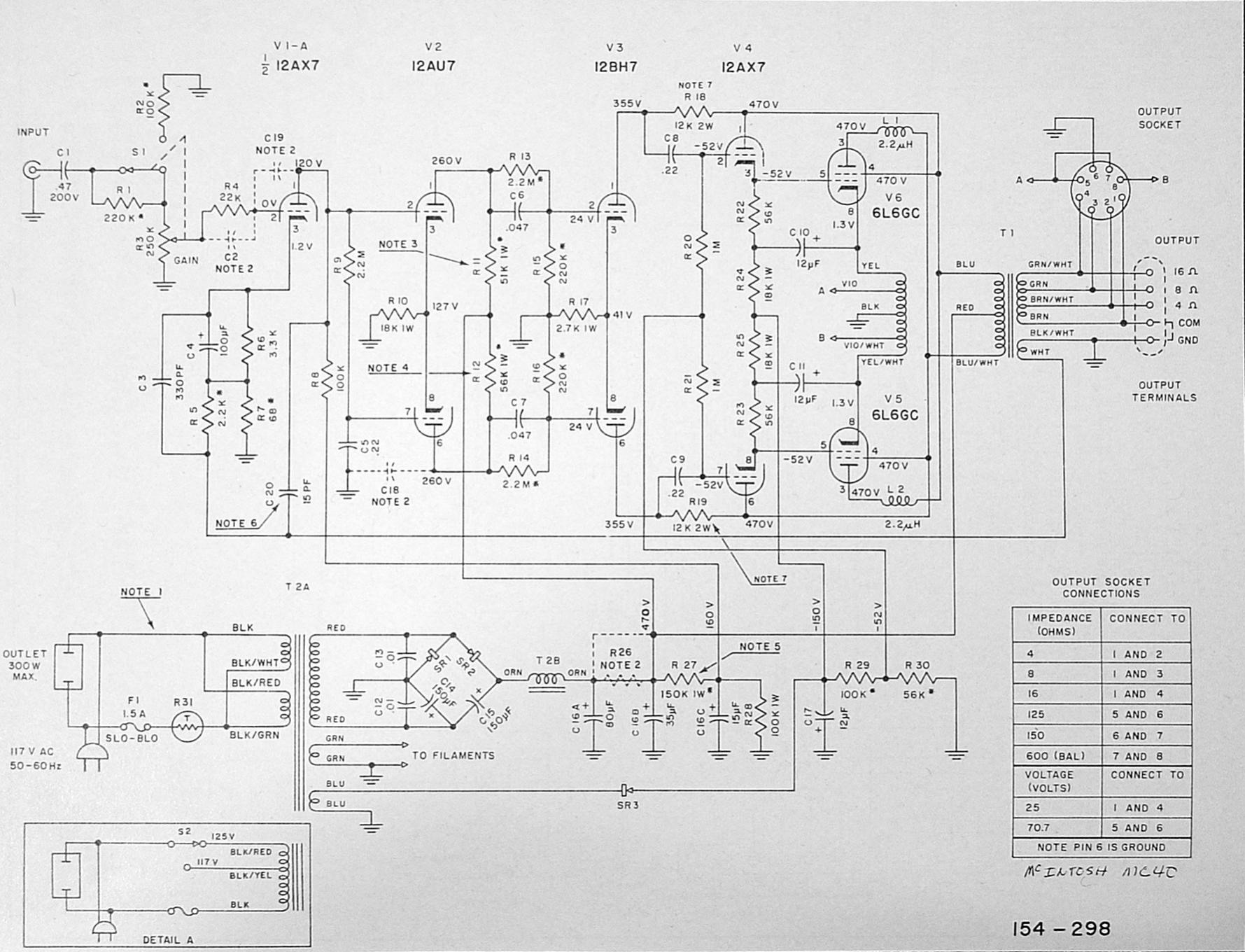

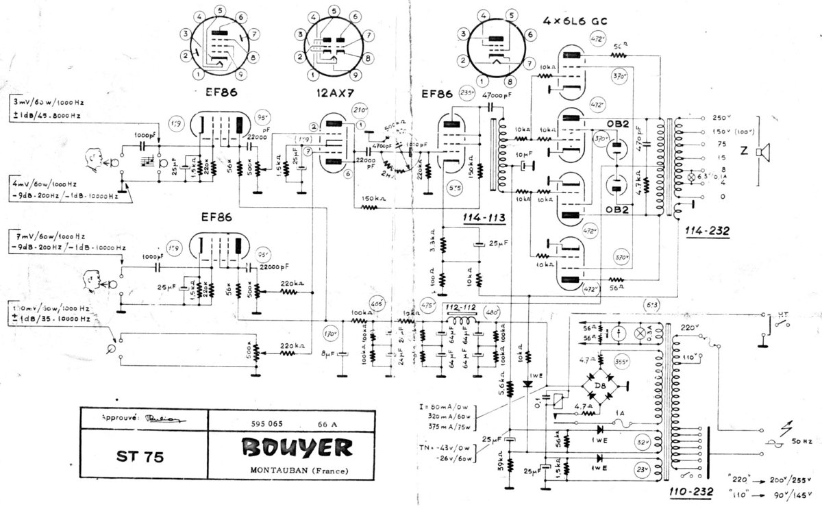

Attached are some schematics of audio amplifiers in which the 6L6GC's are being run with Vba and Vbg2 higher than 450 V.
In guitar amplifiers you often see that Vba, and even Vbg2, are higher than 450 V. Some examples:
Fender Bassman 10: Vba = 490 V / Vbg2 = 455 V
Fender Bassman 10/75W: Vba+g2 = 500 V (ultra linear)
Fender Bassman 135: Vba+g2 = 500 V (ultra linear)
Fender Bassman 59: Vba = 491 V / Vbg2 = 490 V
  • 0,5 x 12AX7 dc-coupled + 12AU7 + 12BH7 + 12AX7 dc-coupled c-follower + 2 x 6L6GC cfb pp (Mcintos.jpg

  • 2 x EF86 supertriode + 12AX7 + EF86 supertriode transformer-coupled + 4 x 6L6GC + 2 x 0B2 (Bouye.jpg

  • 12AX7 + 6SN7 transformer-coupled + 2 x 6L6G cfb pp + 5U4GB + 5Y3 (McIntosh).pdf

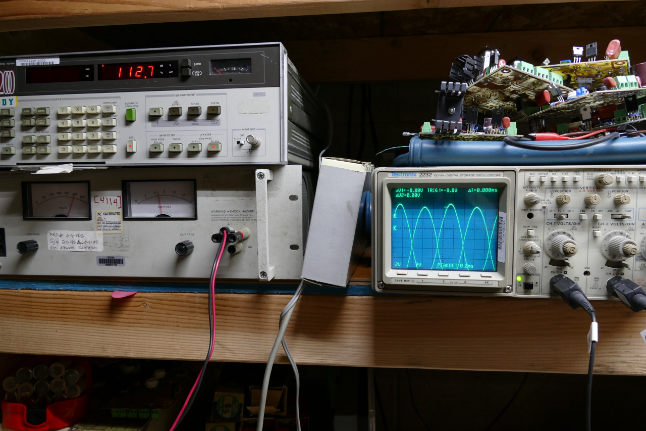

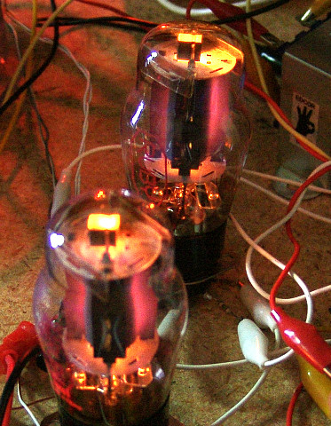

I haven't tested many new production 6L6GC's, except for some cheap Chinese tubes and they worked fine at 500 volts. I took a pair of 1940's vintage 6L6GA's and tried to find their true power limits. The amp ran AB2 into a 3300 ohm OPT. I kept increasing the B+ voltage and drive level to achieve more power. These tubes can achieve far more power than their ratings.
I was at 500 volts and 112 watts of output from the pair, and left it there for several minutes while I took measurements and pictures. The picture shows the tubes with the room lights off. I cranked up the brightness of the image in a photo editor to look for glowing parts.....there aren't any. The next picture shows the scope probe on each grid revealing nearly 45 volts of positive grid swing, the analyzer reading 112.7 watts at 3%THD, and the plate power supply at 500 volts and 700 mA (two channels operating). Assuming that the current was split evenly between the channels, one pair ate 350 mA at about 485 volts (15V drop in the OPT). This is a plate efficiency of about 66% which is quite good for 75 year old tubes!
I turned the drive up further and somewhere around 120 watts the cathode resistor exploded due to a tube arc. I replaced the cathode resistor and repeated the test only to have a different resistor pop again at the same power level.
A tube arc occurs when the current density exceeds the cathode's emission capability. In this case the tubes were not significantly damaged, but I have seen some TV sweep tubes explode when a tube arc of several Amps occurs.
This indicates that you should have no problems running any well made 6L6 type tube at 500 volts of B+......just don't aim for over 100 watts!

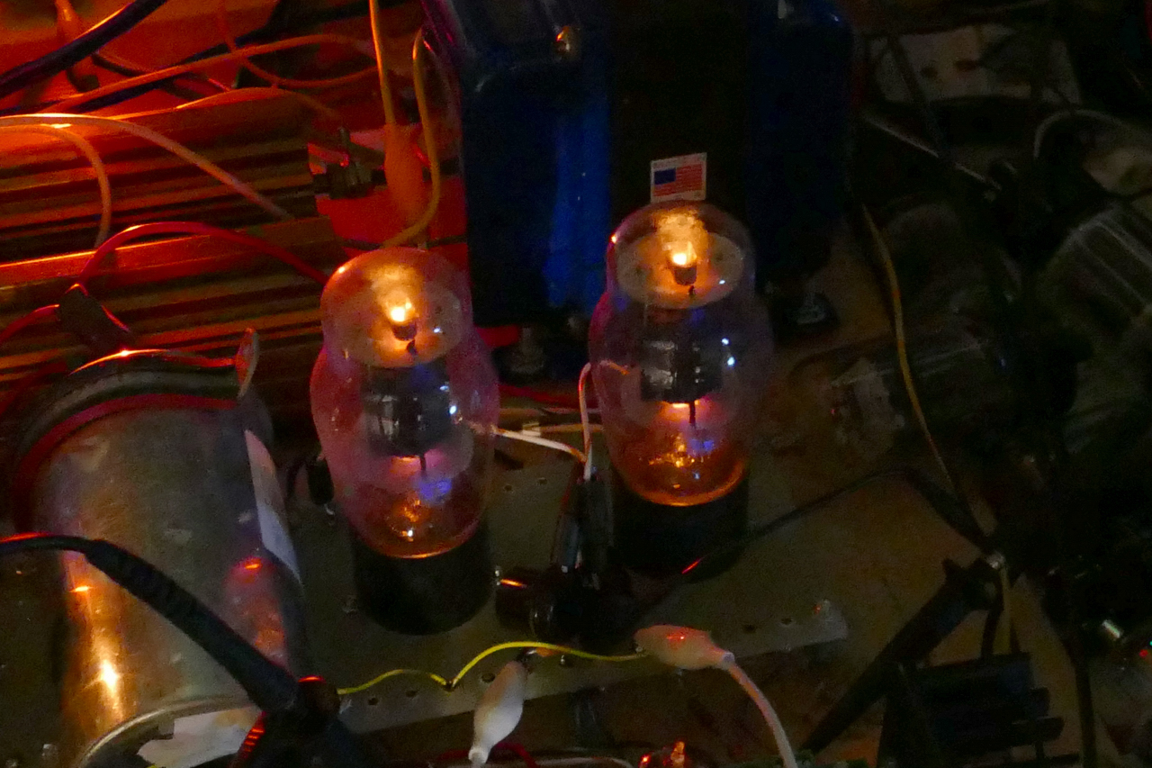

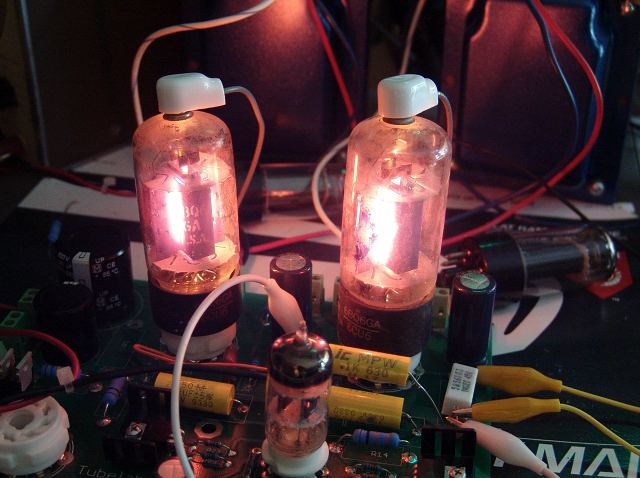

I pulled this pair of Chinese Ruby Tube "6L6GC's" out of a working Bandmaster because the owner wanted something different (Sovteks I think). This was about 20 years ago. I still have them and they still work. They are dissipating about 44 watts in a SE amp in this picture.
They were no match from an extreme overload test using some 6BQ6GA's I got for 79 cents each. These were sold as new tubes, but this pair was old, crusty looking and not so good. They became a little less good after this test, but did still work. One would blow up eventually trying to push the watts per $$$ limit.
