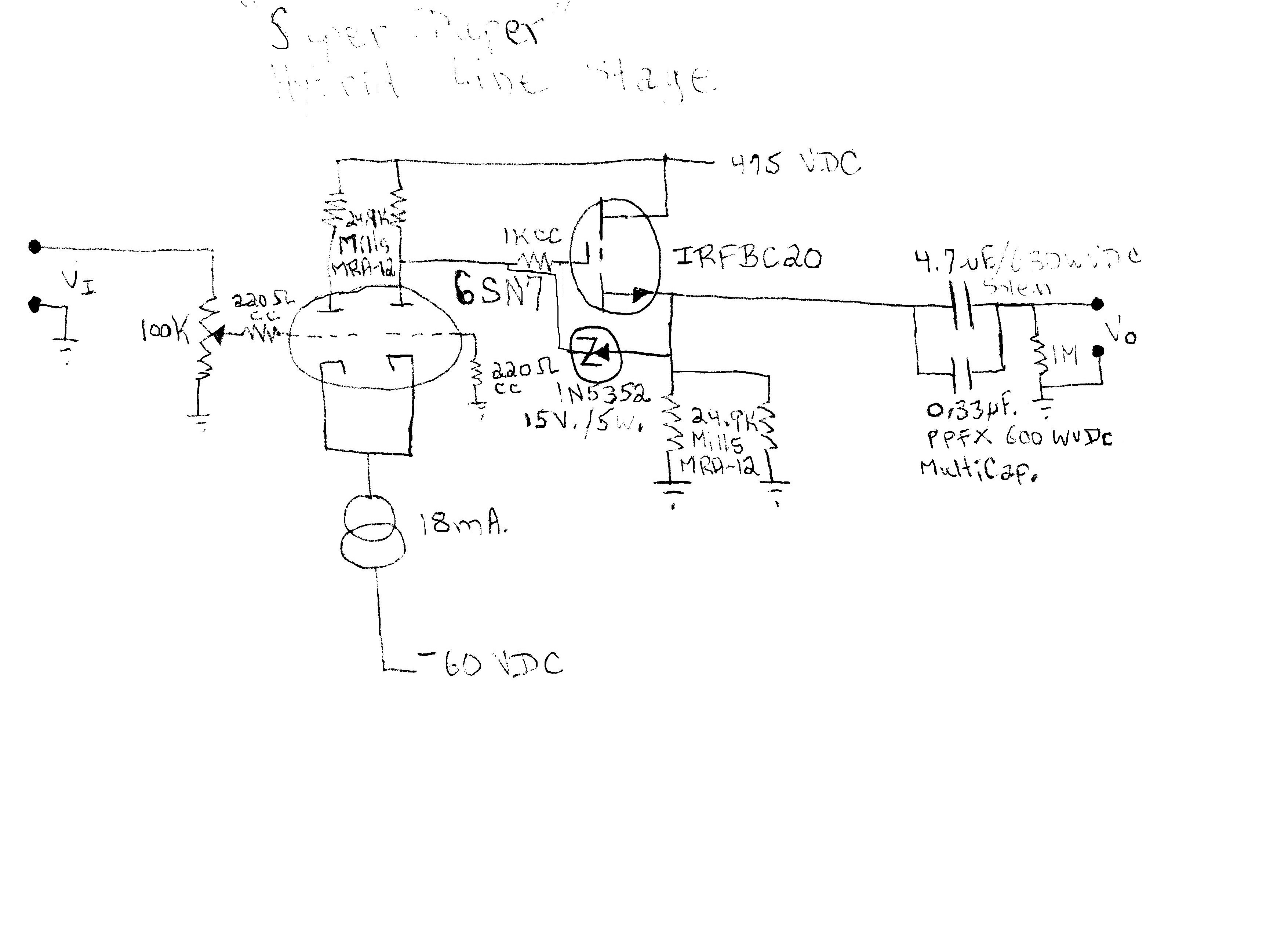

I'd still like to make a tube line stage with gain of about 10, unbalanced inputs and balanced outputs, that can drive 10 foot balanced cables into 10k ohm loads. Is there a good, proven circuit for accomplishing this?
Ron, the circuit provided has roughly 10X gain and the cojones of a blue whale. Add a Sowter 3603 to each channel and you have balanced O/Ps and galvanic isolation.

I vote for ImPasse. IMHO, a lot of the ideas being thrown out are fine, but probably wouldn't be comparable in performance to the best line driver IC's. It takes some work to design to optimize both distortion and CMRR. SY did that work.
26dB is a LOT of gain for a typical linestage. The drive requirements of the F4 are rather unusual.
Fair comment. My point is that some of the ideas being thrown out didn't really embody some thought as to overall performance for the required role, including some suggestions with necessarily bad CMRR.
To give you more of an idea of what I am getting at, a lot of the ideas thrown out for tube stages with SS loads to lower distortion. I had a look at Bill Whitlock's recent paper on bootstrapped line receivers and the tube schematics at Jensen. Very little emphasis on the details of active stages, much more emphasis on circuit topology. Remember, they are recommending circuits for pro audio, so good, quiet performance is necessary, even if they are biased as to transformer application.
As a side note, I noticed that what they call ultra high performance balanced drivers used 2 transformers, 1 before the active device, and 1 after. I'm gonna have to use that sometime 🙂
With a good cascode CCS load the gain will be mu, and that is because the AC load is essentially infinite in comparison the rp of the tube, and there is no significant AC loading in the following stage..
Don't forget that Vpp is 6dB greater at the output due to the balanced output. So gain is in fact closer to 32dB input to differential output.
