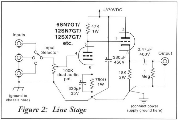

tube line preamplifier circuit
true schematic for High-End pre-amp!
Hi guys!:wave2:
Here's true schematic authentic high-end preamp.:hohoho:
Enjoy tube/valve sound with this pre-amp!:hphones:
Enjoy's!!😉
I have the Pete Millett Low Mu preamp and I think it is one of the best sounding preamps I've ever heard. I took it to an audio meeting last year and everyone there said the same. The only thing I had to do differently was to use a separate transformer for the heaters as the transformer Pete calls for does not have enough amps on the heater windings.
I only have one in and out on mine.
website Low-mu preamp
Schematic http://www.pmillett.com/images/lowmu_sch.PDF
