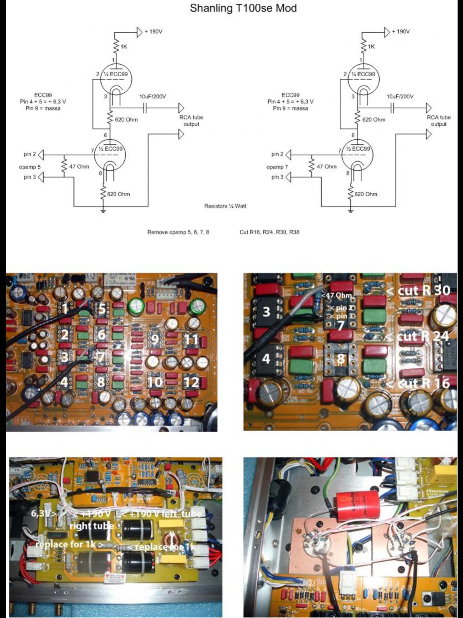

I used 6n6p tubes, same schematic other pinout.
I/V resistor on Iout from dac and analoge ground.
Not the technical best solution but simple and good sounding.
Cd player has dual pcm1792.

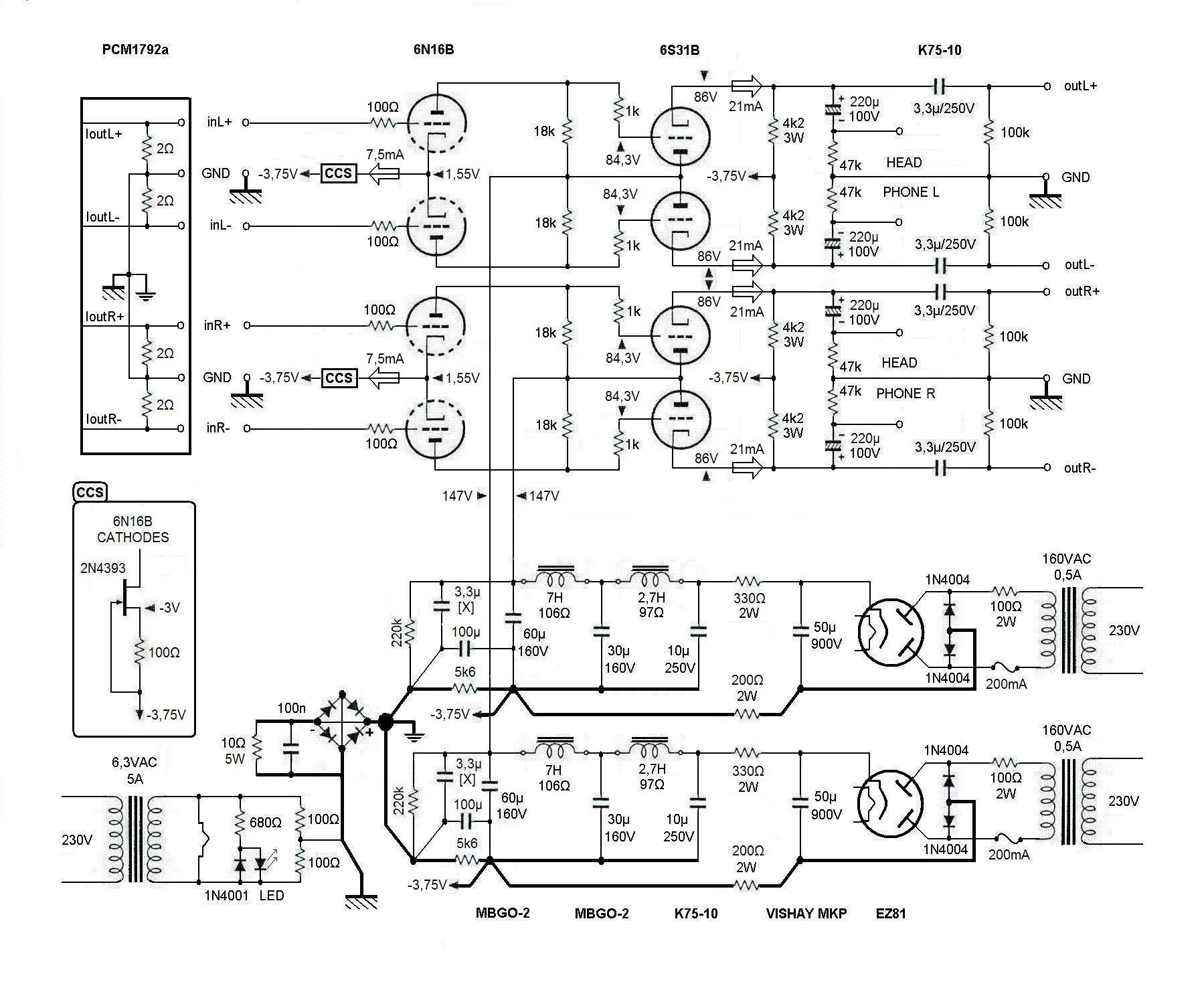

My 2 cents!
I use a modified PCIe sound card - asus essense stxii. It has a mono stereo PCM 1792a - the "software control" version of PCM 1794 - from which I take signal through 2 ohm I/V resistors to feed a differential tube stage. I' ve designed it by my own and it reflects my limited level on electronics. My conclusion is that this chip likes the very small I/V resistor - also tested with 56 and 82 ohm - but then enough gain is required. Now I have replaced the tube stage with this http://www.diyaudio.com/forums/analog-line-level/296406-salas-dcg3-preamp-line-headphone-122.html. Eventually, solid state wins but I feel very nice to know that my tubes came close:)
Dual mono, is one dac complete for left and one dac complete for right channel. Preferred with both separated power supplies. I did not hear the difference with a single dac. You do not need to stack/multiply the dac's.
