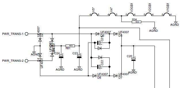

Enclosed is the PDF of the Eagle schematic for the board I laid out for this test amp. It is a guitar amp that I designed for the Hundred Buck Amp Challenge several years ago. I tend to throw everything on the initial PC board design and rip out or populate what I want at build time. Then, after hacking it up and making what I really want out of it, I'll lay out a new board.
The preamp section was found to have way too much gain, and therefore got hacked up a lot, the mosfet followers were ripped out except for Q3 and Q7 which drive a pot. The mosfets in series with the cathode bypasses got lost too. The power supply and power amplifier worked great from first power up so they remain.
The amp got lost when I had to move twice in a year on short notice, but it will be explored further when I find it.
Power supply:
The power transformer is a 100 VA isolation transformer with a 120 volt secondary. The typical Triad N68-X ran too hot feeding this amp since all of the current is drawn in short pulses.
Diodes D1 through D4 form a conventional FW bridge with about 170 volts (on my 122 volt line) across C23. This feeds the 168 volt series heater string and the output tube's screen grids directly. R34 was added so I could experiment with 150 mA output tubes. Those experiments never happened since the UL84's exceeded my expectations.
Diodes D5 through D8 form a FW voltage doubler delivering about 340 volts at idle, with some sag when the amp is blasted well into clipping. The rest of the amp runs from this supply in a manner similar to most guitar amps, but patterned after the "Marshall 18 watt" design.
Don't forget, the PL84 and UL84 differ only by heater, they are both not like a EL84.
The voltage doubler has a possible problem.If C21 and/or C22 are smaller than C20 they get charge in the wrong direction.To prevent damage best put diodes across.The final voltage is reached faster too.

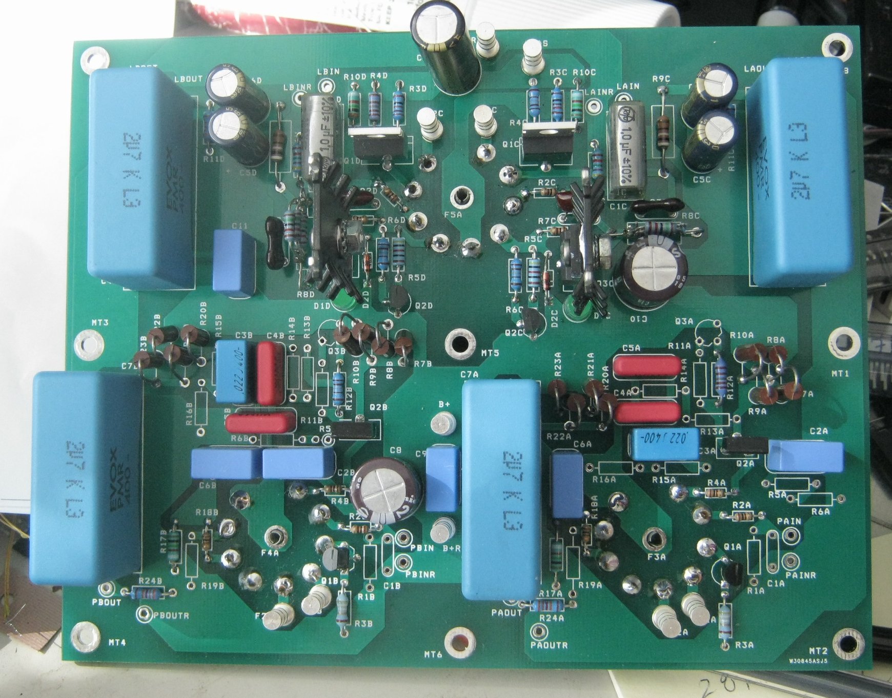

I've been busy populating the lineamp portion of the board shown in post #32, a variant of a lineamp concept shown in the "evil sandman" thread. The variant in question makes it possible to adapt a lineamp to a variety of tubes without a lot 0f shilly-shallying around, at the cost of some electrolytic caps in places where I normally don't want to see them. Simulation results are excellent. Listening results, as usual, are another question. Hold on to your hats...
Here is the latest RIAA preamp plus lineamp module mostly stuffed. The lineamp section biased up sweetly first time around last night, with reasonable device temperatures. Signal testing will follow shortly.
I'll then concentrate on the RIAA section. I may chhange theRIAA section to a folded cascode design that will have more optimum tube bias currents, plus the capability of operating at 150V rather than 200V B+ with some overload margin.

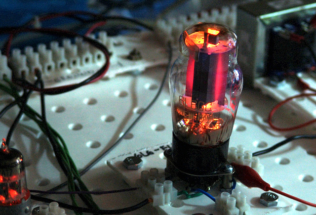

I have a fair number of 6L6GCs hanging around, mostly Chinese and Russkie, with a few used JJs. I like the shape of the JJs, but I don't like their reliability reputation. Some of the EH tubes I have sit a bit ****-eyed on the base - maybe that was why the seller let them go for cheap,,,
The plate voltage is only 400V, so I might not get all that much glow, even if I find some likely prospects.
That one was eating about 40 watts at the time. I have had that pair since I pulled them out of a Fender Bandmaster because the owner wanted something different. That was about 8 years ago. Despite many trips into the red zone, they are still alive. I use them to test new ideas that might not go exactly as planned.
My Rubys are straight-sided rather than coke bottle.
I have a bunch of Chinese no-brands in both straight and coke bottle, as well as a quad of straights that are Mesa branded, but look the same as the unbranded. I would hesitate to push any of these over the GB 19W plate rating, as the innards are on the smallish side. The Rubys are more generously proportioned.

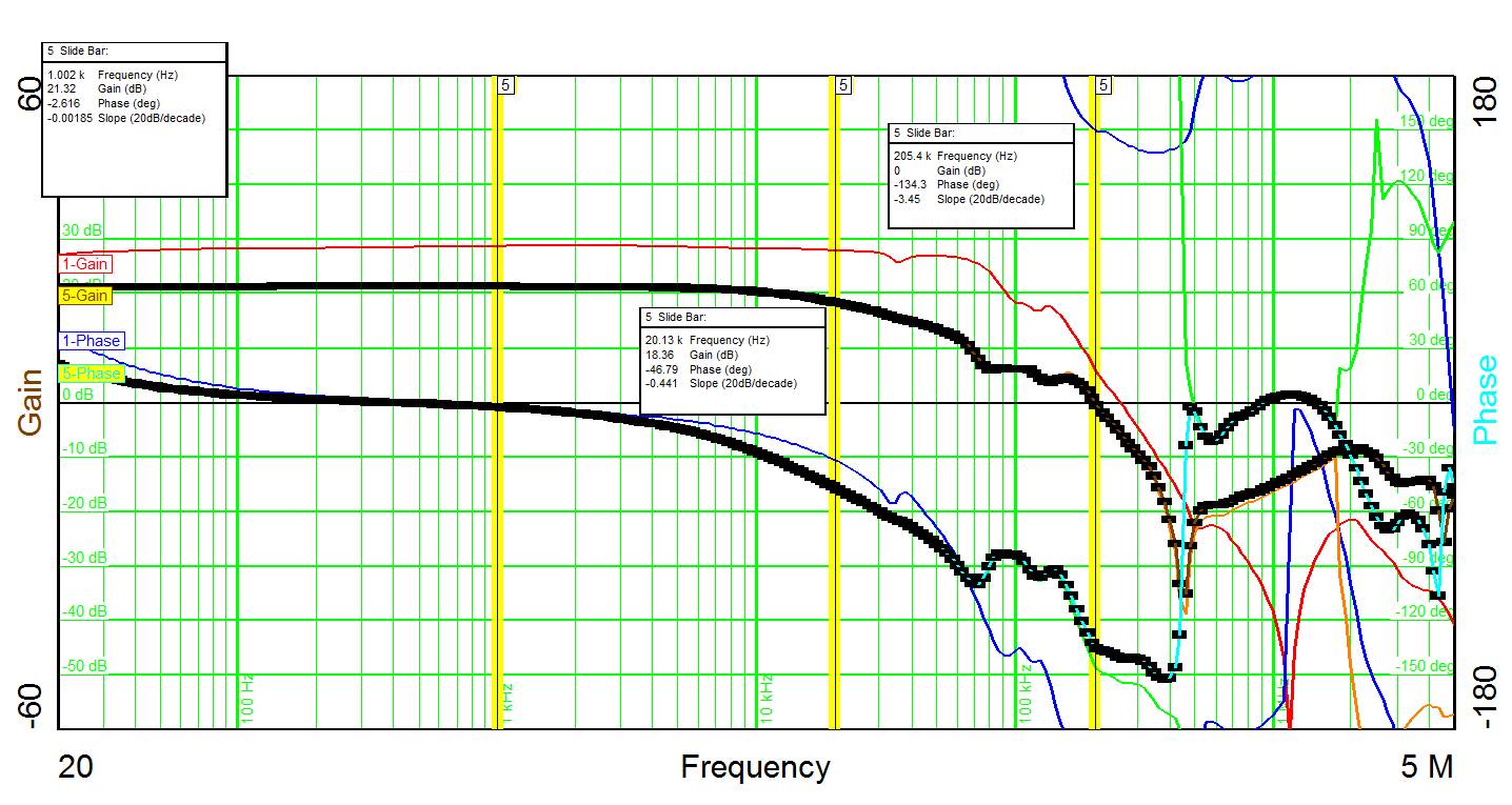

THe big problem in this whole effort is dealing with the ragged frequency response of the Transcendar output transformers. I have had to use fairly drastic measures to get them to shut up, while at the same time getting even marginally acceptable closed loop response. Having access to a gain-phase analyzer lets me see all the ugly warts associated with a given piece of output iron
I used Millett's method of a capacitor from the plate of the input pentode to ground in order to smooth out the frequency response some. Making that capacitor an RC network gave me increased closed-loop phase margin. Using aggressive closed loop compensation allowed me to cross 0dB with acceptable phase margin, at the cost of chewing up my 20k response.
The attached gain-phase plot shows both the open loop response of the partial feedback amp without global feedback (red and blue curves), as well as the closed loop response (black curves) .The amp is stable as evidenced by both the gain-phase plots and the square wave response, but the bandwidth is certainly nothing to write home about.
If I drag this monstrosity to this year's Burning Amp, it will be as an advanced breadboard screwed to a piece of lumber, powered by the switching adapter and DC-DC converter. I don't want to go to the trouble of mounting the amp into a case until I can get my hands on some more decent output iron and clean up the frequency response. I may try the One Electron 4.8k transformers next. Once I get some decent gain-phase results, I would like to try the exercise of dropping in a pair of KT88 outputs and going for an honest 10W RMS/channel. My DC-DC converter will support that level of power.
