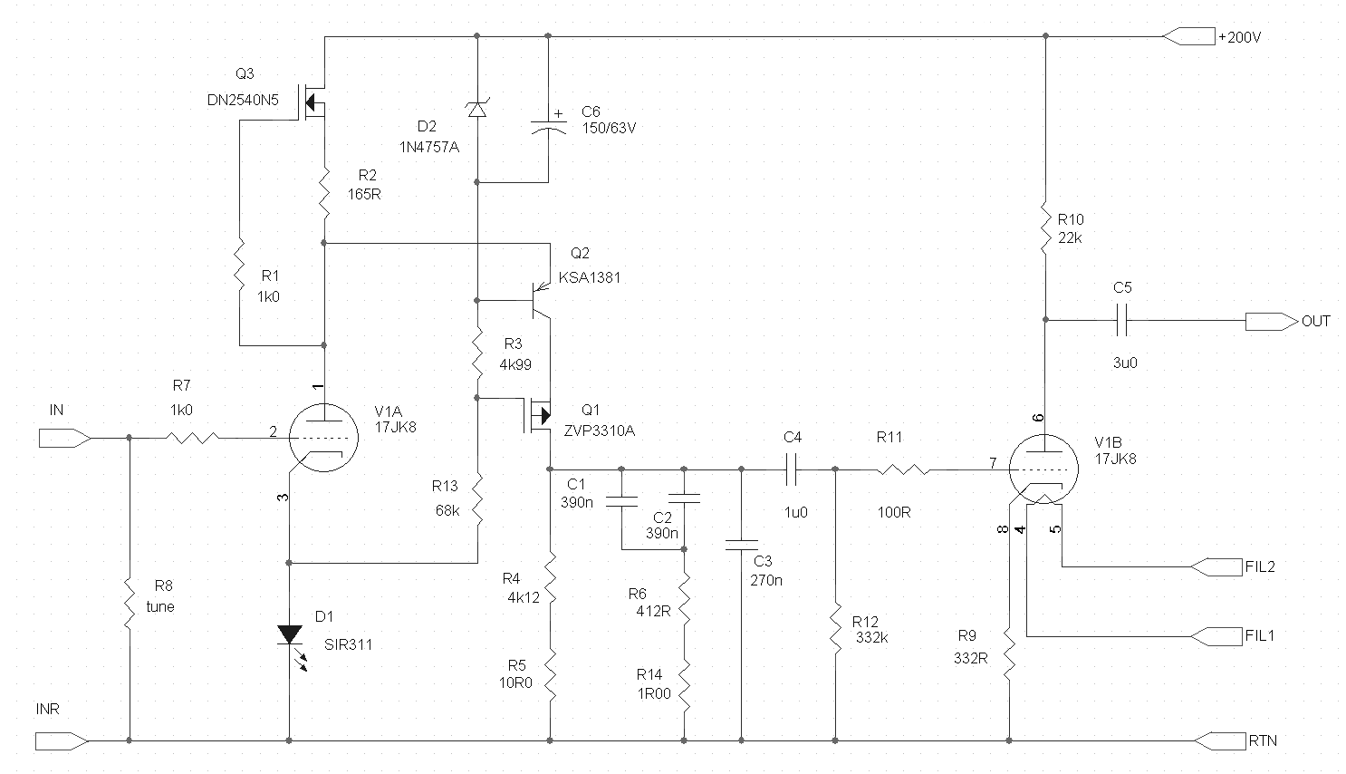

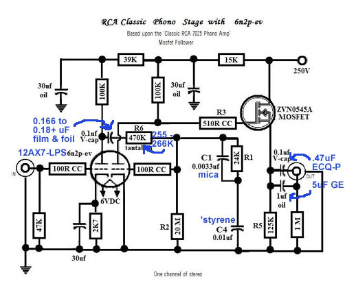

Attached is the initial concept schematic for the RIAA block, slated to drive a 100k volume pot of some sort.

As connection to some sort of recording device is possible, I suggest you add 1 more "sand grain" to the phono section. Buffer the phono section with a ZVN0545A source follower. FWIW, I was successful in tweaking the "classic" RCA setup, with a ZVN0545A source follower.
That depends on where the "out" is in the scheme of things. I have in mind an extremely hefty line amp stage that may be between the RIAA amp and the outside world. A more insular view might relegate the RIAA amp totally to "inside" duty, which would also be totally valid. Don't assume I'm not on top of all these distinctions, because I am.... This is an integrated amp after all, not an isolated RIAA stage - one block at a time...

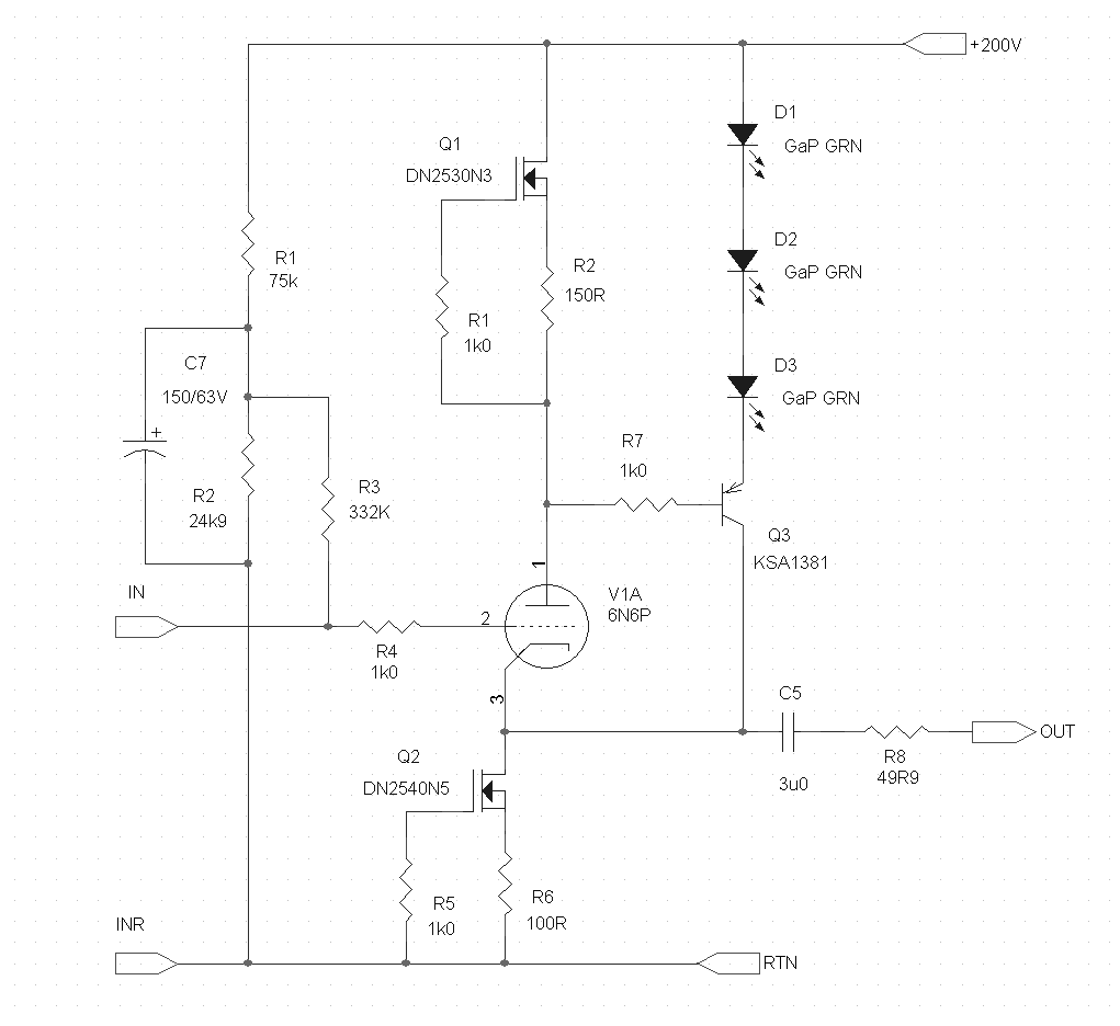

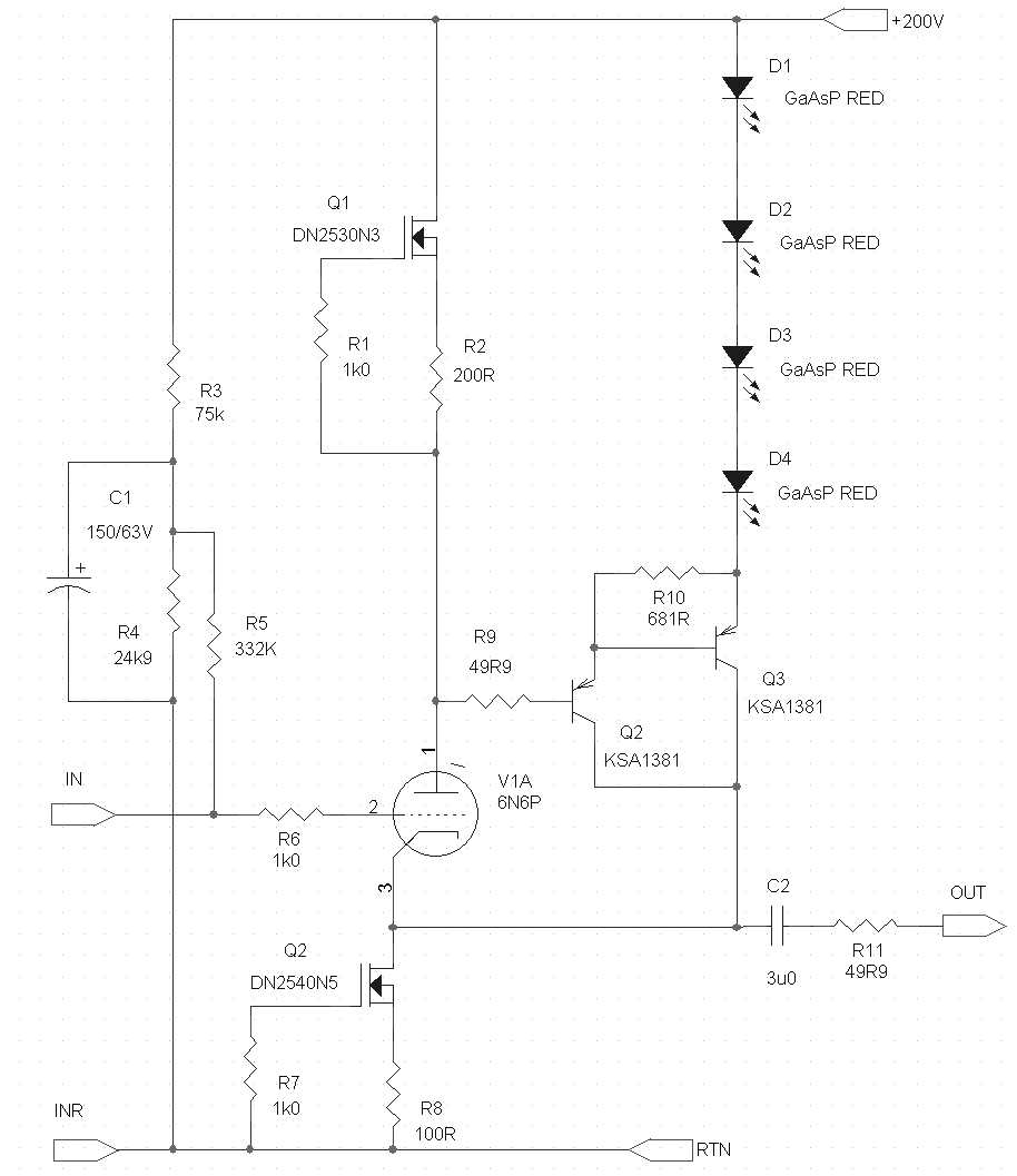

Here's the first cut of the line amp. I may use a P-channel mosfet and a single green LED instead of the HV PNP at the output - I may try both. I'm probably going to use point-to-point wiring under the chassis with chunks of circuitry where necessary on perf board, which should make changes easier. What I'm doing isn't complex enough to justify a PCB.

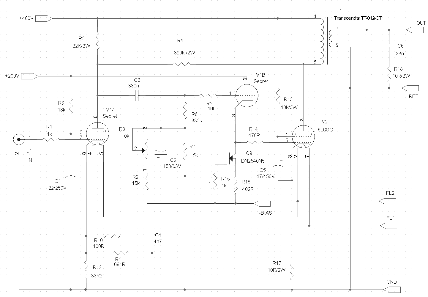

Here's the power amp. Some of the values are EWAGs/placeholders until I can get the thing up and tinker with it some. The input tube will remain secret until 1) I get my own stash at a decent price 2) I'm sure this thing is working right with my tube of choice. Having said that, there are a fair number of inexpensive triode/pentode pairs that would work OK in this application with a little bias tinkering. The venerable 6U8 would work more or less ok, but that's not the one I plan to use. Just to cull the herd a bit (lord knows there's tons of triode-pentodes out there), I'll tell you I'm selecting a tube with a medium mu, relatively high transconductance triode half. Of course you could also just use separate triodes and pentodes of your choice, but I'm trying to do this project using as few envelopes as possible.
I chose to use fixed bias but initially not regulate the bias and screen supplies. This was done in order to save parts. I may regulate these supplies in case this dodge does not give me a stable enough bias point.
I plan to power this setup with an old transformer from a Fisher receiver (It's either a 500B xfmr or a 400, I'd have to check). The tubes were chosen to work within the capabilities of the filament supply, otherwise I would have used screen driven sweep tubes in the output stage of the power amp (cheaper than the 6L6GC by a long shot).

I know how that goes....I mentioned the 6EZ5 and before I got some....poof they went from $1 each to $4 or $5. I made a spreadsheet that I use for tube selection. I don't even list a tube with the same pinout that you show.
I don't know how much reserve you have on the heater supply, but the 6GB5 is an excellent small sweep tube that needs 1.38 amps VS the 6L6GC's 0.9 amps. I already got 100 13GB5's. They are off of one dollar list already.
The 6BQ6GA is a fat bottled sweep that needs 1.2 amps. I and at least one other builder have ran them in the SSE amp. The 6DQ6 is also only 1.2 amps but I could never get that one to work well in SE. Didn't try screen drive though. Both have a compatible pinout with the 6L6GC if you wire a plate cap to pin 3. I added a pin jack so that I can plug in the plate wire if needed.
I have a way of checking the inventory at ESRC. I will not use a tube that is in short supply. In fact I just sold Stan $400 worth of tubes that I had saved for projects. These TV tubes got sucked into the spud SE vortex years ago by Bottlehead and others. They have been used up by audiophiles and become scarce and will vanish within a few years.
If pins 7 and 9 are reversed, then it would fit base 9FA. Most of the tubes listed for the 9FA base are on the 1 dollar list. All pretty similar to 6U8.
The reason I chose the 6L6GC was its decent plate dissipation with a reasonably modest filament draw. To get a similar plate dissipation with a sweep tube will cost me 2.5A per tube filament current.
As far as the basing on the input tube, it's that way 'cause it matched the tube that I want to use. I would have used the same tube for my phono preamp, but using the 17JK8 allows me to run the filaments with DC off the bias winding. Fisher used a similar scheme in their receivers.

As usual, as my projects progress in fits and starts (often displaced by other projects) I get other ideas that supersede the original intent. The line amp architecture has remained pretty much stable, except it now has gain and uses a mosfet rather than a bipolar device at the output.
The RIAA amp has morphed completely into a feedback-based confection designed around the 6N3P with sand helpers. No worries about output impedance now...

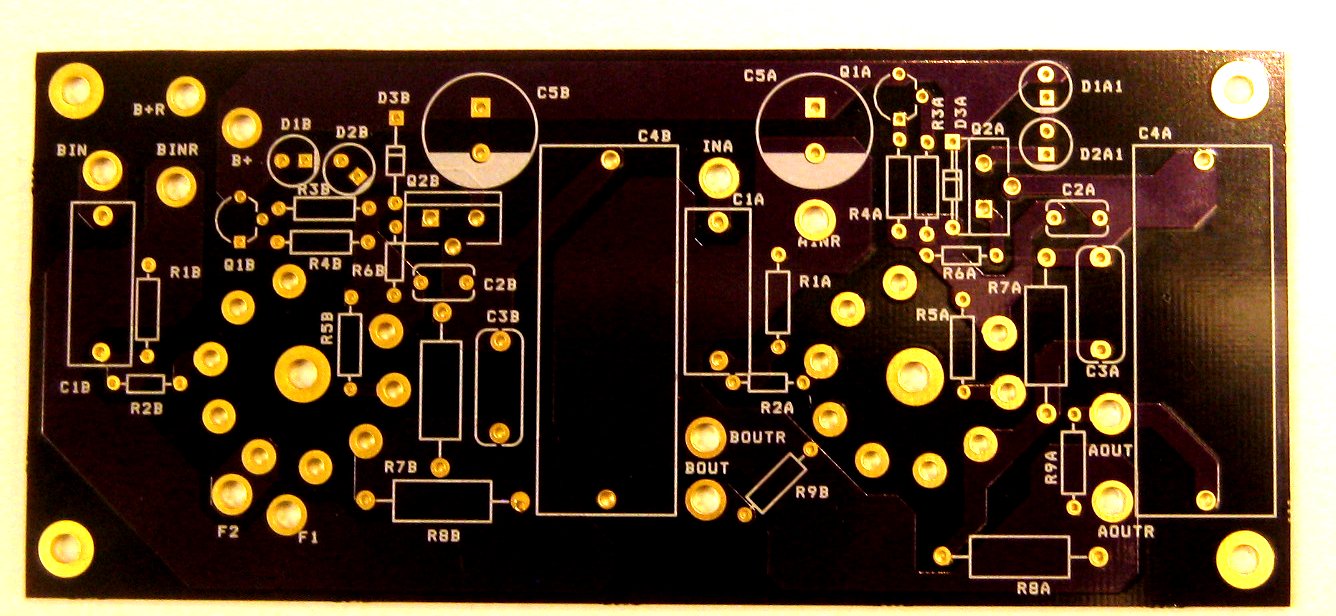

PCBs are laid out for both designs - I just got the reference designators sorted out this afternoon, as both designs were laid out free-hand without netting from a coupled schematic. I'll feed them to OSH Park when I'm ready, and get back some lurid purple boards for prototyping.

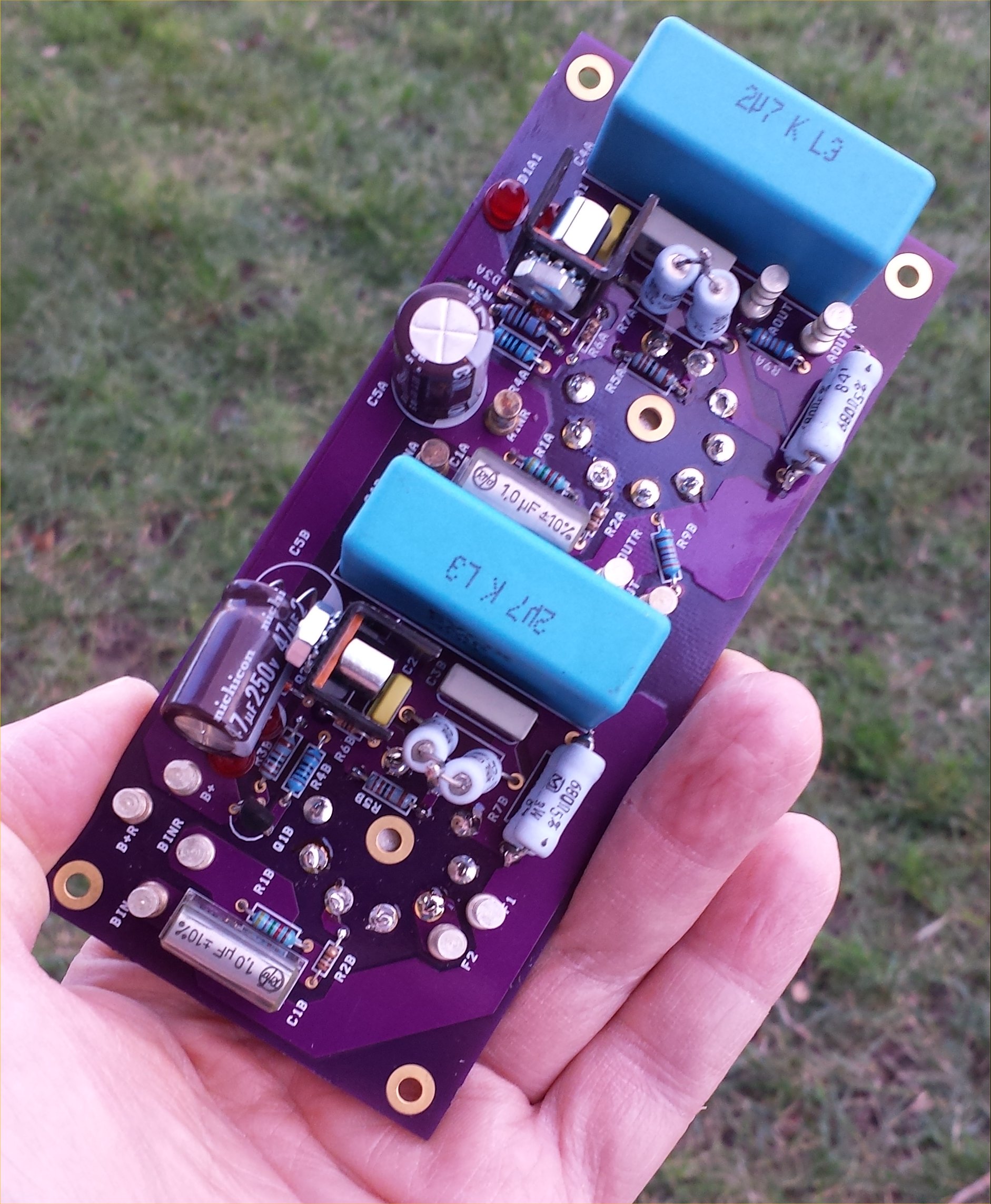

Christmas Came Early
I wan't expecting this board to come in today, but I was pleasantly surprised. This is the line amp, the first functional block I'm building for the integrated amp. I've changed tubes, but the concept remains similar to the schematics I've presented here so far (a few refinements, though). I'll be building this up over the holidays. Tube sockets are on the bottom side, so the boards will be flipped over when finished, with all the topside components hanging down inside the chassis.
