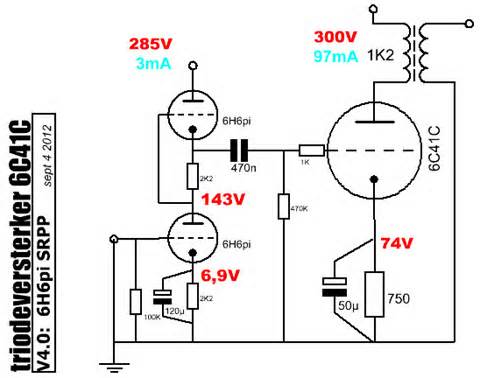

What about the first part of this circuit. Might even subsitute a stack of 2 1W leds for the cathode resistor for about 5.5 to 6V bias instead of 6.7v.

The SRPP and an active load stage have identical performance for an infinite load impedance. In addition, the SRPP can give lowish distortion into a particular (fairly low) load impedance, but this will often result in much lower gain too. For most audio usage of SRPP the optimum load impedance is not a design issue, as the SRPP is being used with a near-infinite load.
