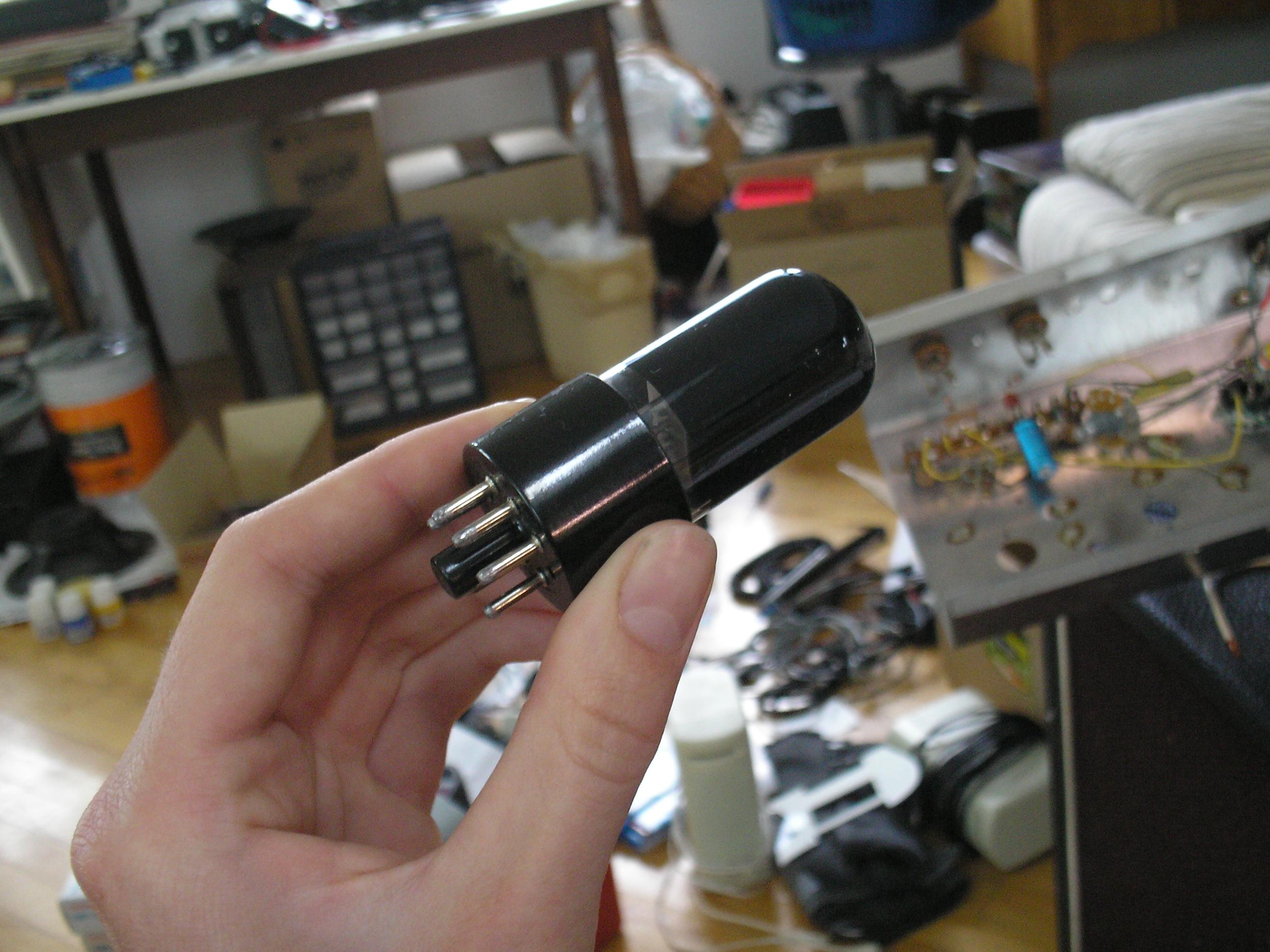

I am currently putting back together an old Paul (by Pine / Pepco) guitar amp and the single output tube it contains has no markings on it. I was wondering if someone could tell me more about it as I know very little about tubes in gerenal.

We are gonna need a little more to go on than that I am afraid...
Some better detailed pictures of plate structure ect.
Although my guess would be 6V6GT.

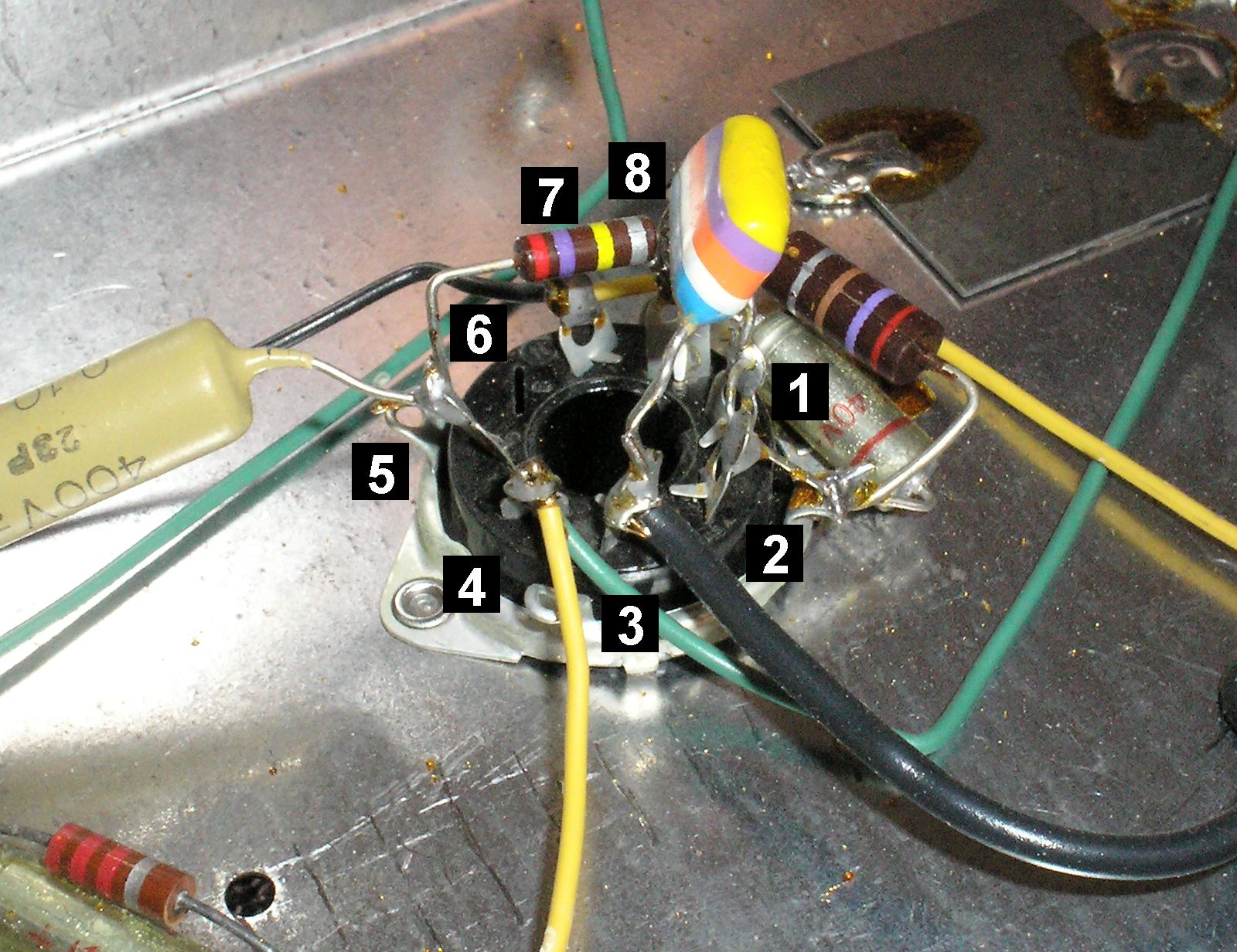

Here's a picture of the socket the tube was sitting in. Pins one and six are not connected as there are no pins one and six on the tube itself (previous picture didn't really show that).
By the way, is the capacitor across pins three and eight 47nF ? Not sure I am reading it right.
Hope this helps 🙂
EDIT : The big black wire connected to pin # three goes to the output transformer.

The pin-out connections strongly suggest a 6V6 or similar type. However, a quick search on line picks up a thread about a Paul amplifier possibly having a series filament string. So, do you have a power transformer in this amp? If so, it's probably a 6 volt tube. If not, be careful as it could be a series string with higher voltage filaments and dangerous.

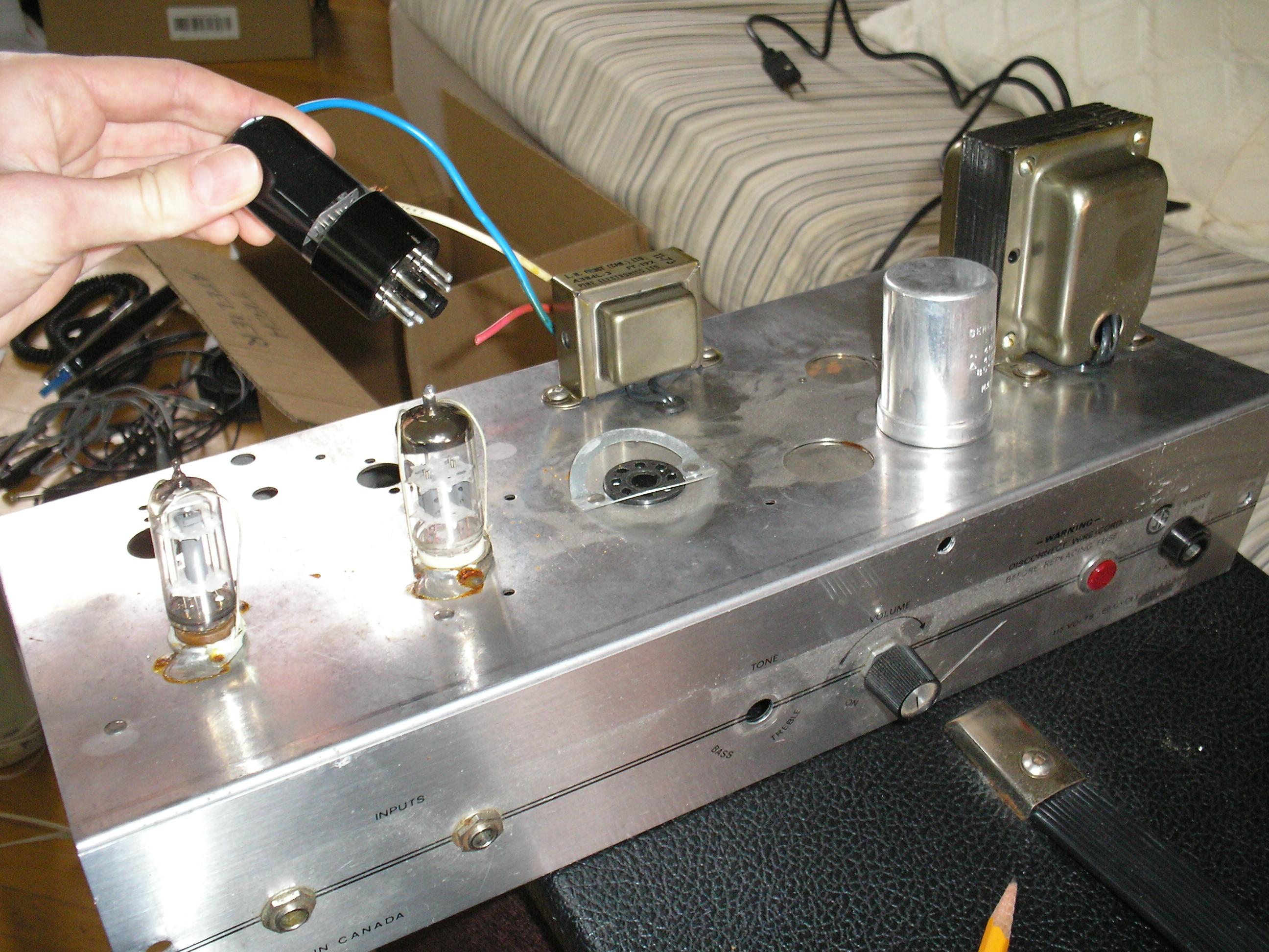

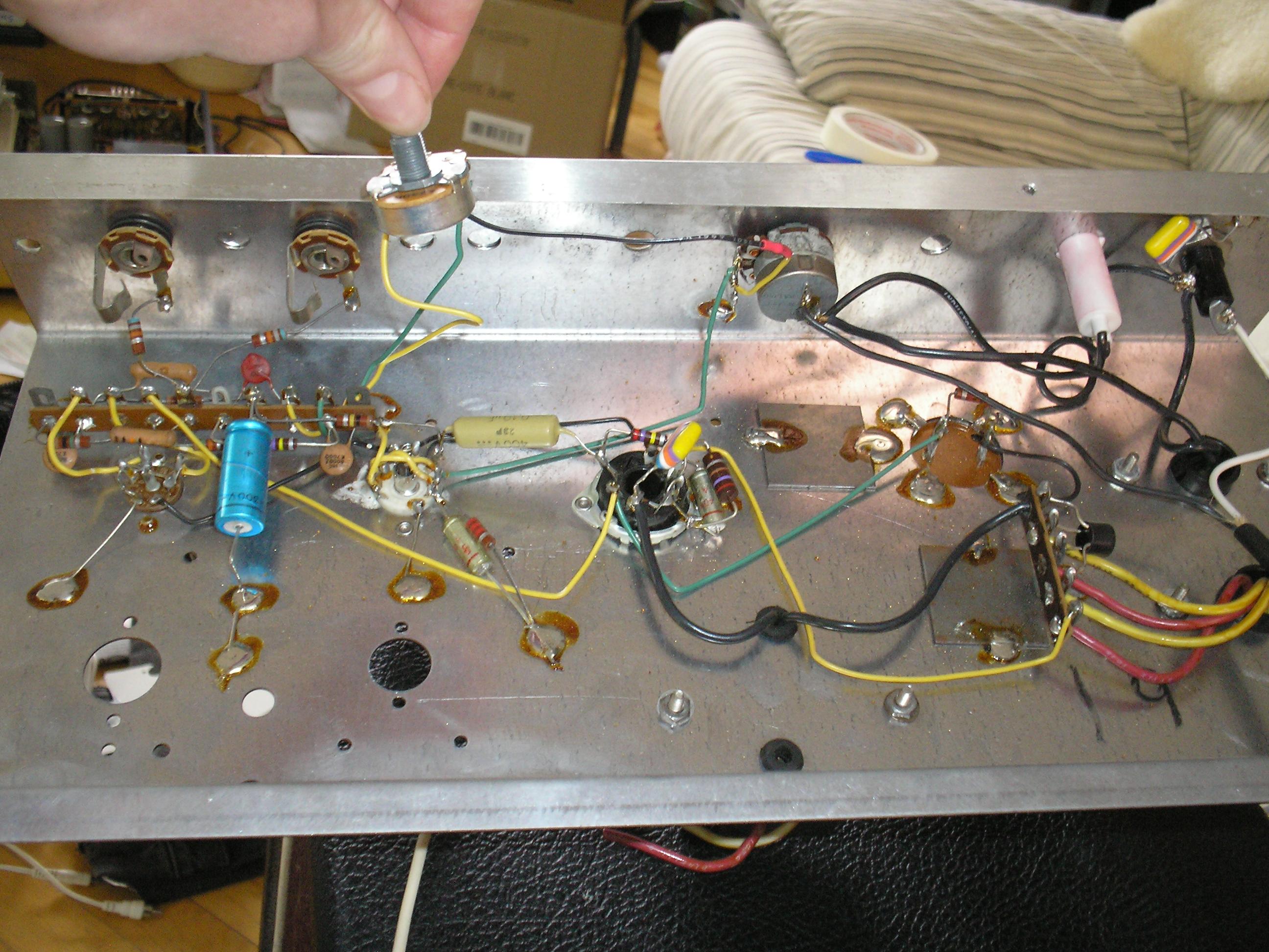

The amplifier does have a power transformer. Here are some rough pics of what it looks like.
The potentiometer I am holding between my fingers in the first picture is the tone knob. I had previously replaced the original one thinking it was shorting the signal into the tone circuit, creating a permanent low pass filter (the amp has NO treble whatsoever).
I haven't traced the whole thing yet but I read online that some of these amps use the tone control more like a mixer between the bass and treble channels instead of a standard HF rolloff. I'll have to look into that.

What's the rest of the tube complement? I'm with Hollow State in guessing a 6V6 but it could be a number of other possibilities as well. Knowing what the other tubes are...particularly the rectifier will narrow it down...
Left tube 6/12AV6 or AT6 single triode twin diode, middle tube twin triode, Tube in question is an output tube for sure.
Rectification is SS bridge (round black four wire).
Look closley at the internal sturcture of the tube with a magnafying glass and see if you can determine what the connections to the base pins are.

It is a 6V6.
