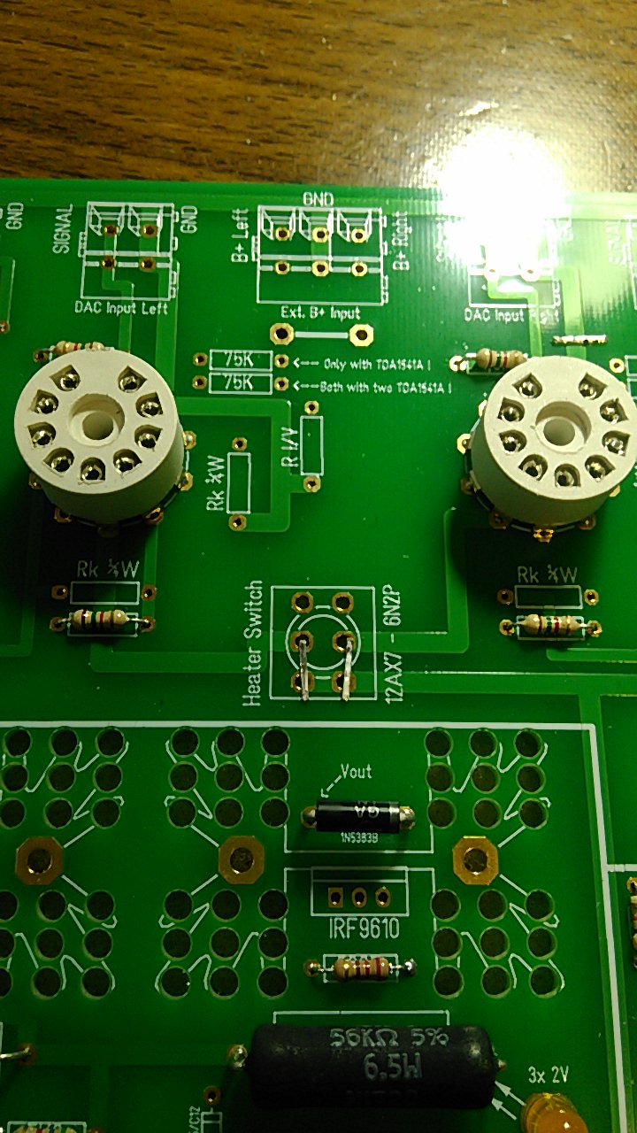

In the process of populating the 3.1 TubeI zator board.
Would appreciate some close up pictures of the board from various angles.
Have to adapt the parts to something that are available locally.
thank you

I am unable to source the heater switch and intend to solder the bridge. If i am using 6n2p, is this the correct way to solder? See attached picture.
That´s the correct way.
